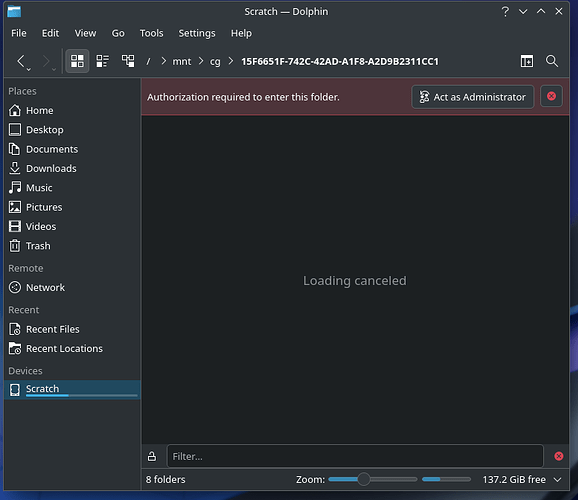

Answer: Yes internal. Auto mount or not I still get asked for a password.
Answer: As I went through all this already when moving over to a linux based OS I preped my drives then, befor I ran OM i was on mint, the two ssd’s are btrfs and the sata’s are ext4.
I therefore have no ntfs drives in my system, I am running a purely linux pc…
Answer: This has already been done, inside Dolphine though, I still need to enter my password.
Regards C

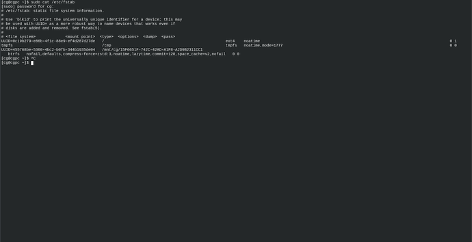

Charles, is that all on one line or did it just get split in the copy and paste? It should be one line

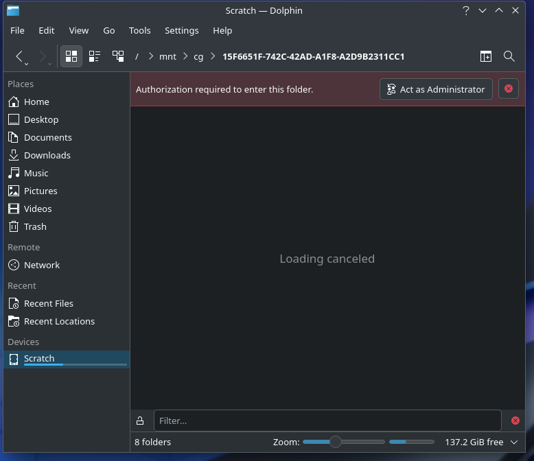

Ok, will look into that and revert back. Just to be clear, the problem is not the booting. the problem is Dolphin continually needing my admin password to access the drive see post 46.
I copied the entire Konsol output, I used sudo cat /etc/fstab to get the contents.
[cg@cgpc ~]$
This is my prompt from within konsol, every line starts with that, I can’t remove it…
It was probably just the screen formatting, below is s screen capture.
Regards C
O.K., you catted that out rather than look at it from an editor. I have no way to know if that line is split, but it needs to be one line. You can change that mount point to anything you want. You might as well make it simple and much shorter, like /storage or something. Remember that it will show in the left hand column of Dolphin, so it needs to be shorter. :slightly_smiling_face:
I understand that you caught the prompt in the copy and paste. No problem there then.
Don’t forget that nofail is in there twice.
It looks like that screen capture shows a line break after the mount-point. Like @WilsonPhillips said, it all needs to be on one line

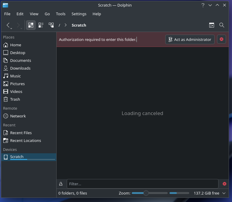

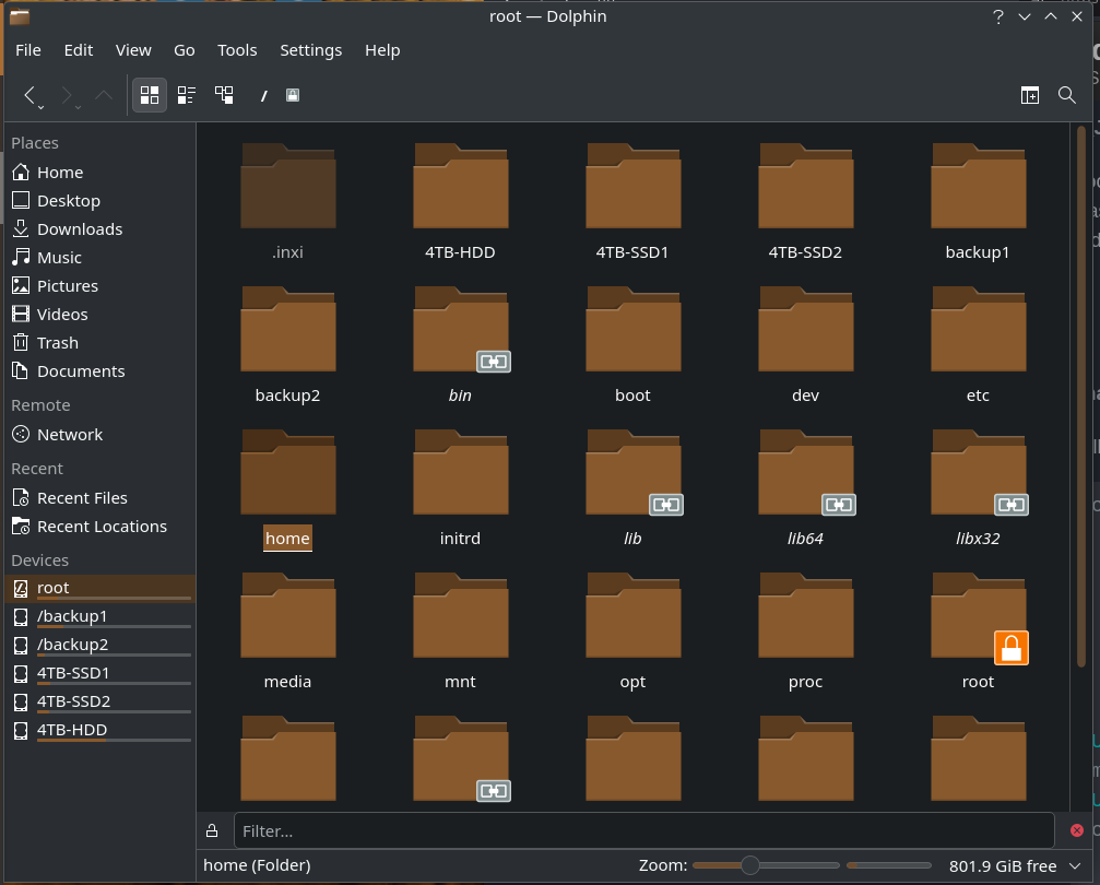

Dolphin still requires a password. How do I check if the ownership has actually taken affect?
@P_J If you look at the above screenshot you will see that Dolphine has maintained the actual name that I gave the drive (Scratch) under devices.

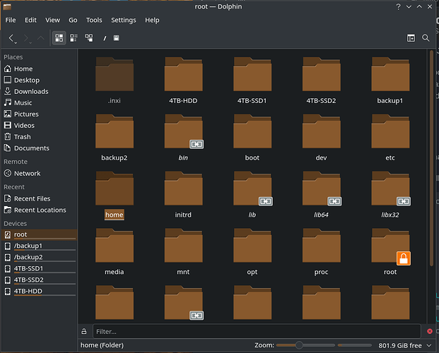

Just a question, @WilsonPhillips why is your “root” being shown and mine not? I just saw on my laptop that “root” is showing up on it too but not on my pc?
Mine just shows as default. I didn’t have to do anything.
How about using this? I replaced one nofail with user and changed the mountpoint.
UUID=455768be-5360-4bc2-b0fb-344b1935de04   /Scratch          btrfs   user,defaults,compress-force=zstd:3,noatime,lazytime,commit=120,space_cache=v2,nofail   0 2

Hi Wilson.
After restart authentication is still required.
I suspected this might happen. Just guessing on your uid and gid.
sudo chown -R cg:cg /Scratch
Oh! That might take a moment.
