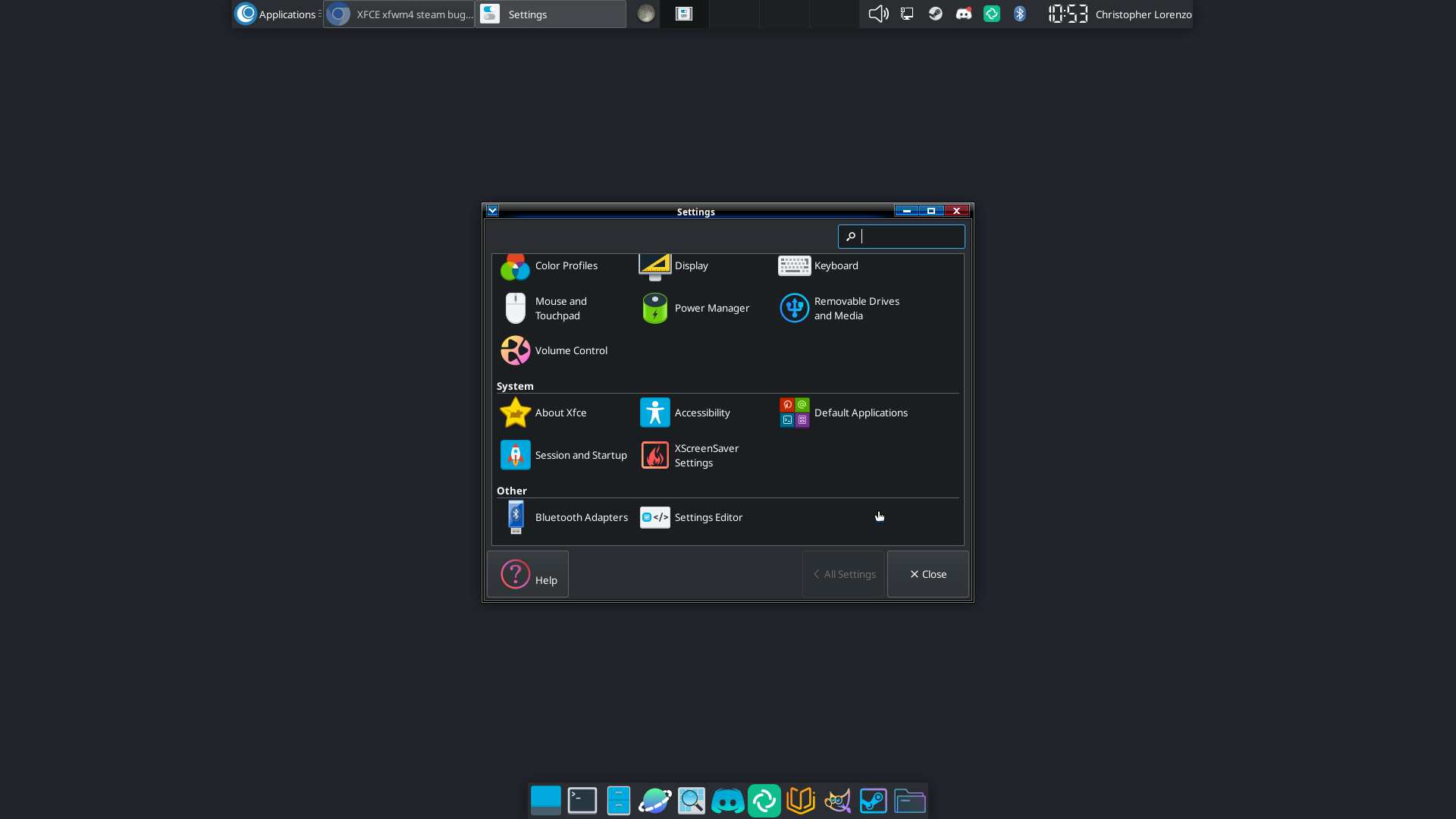

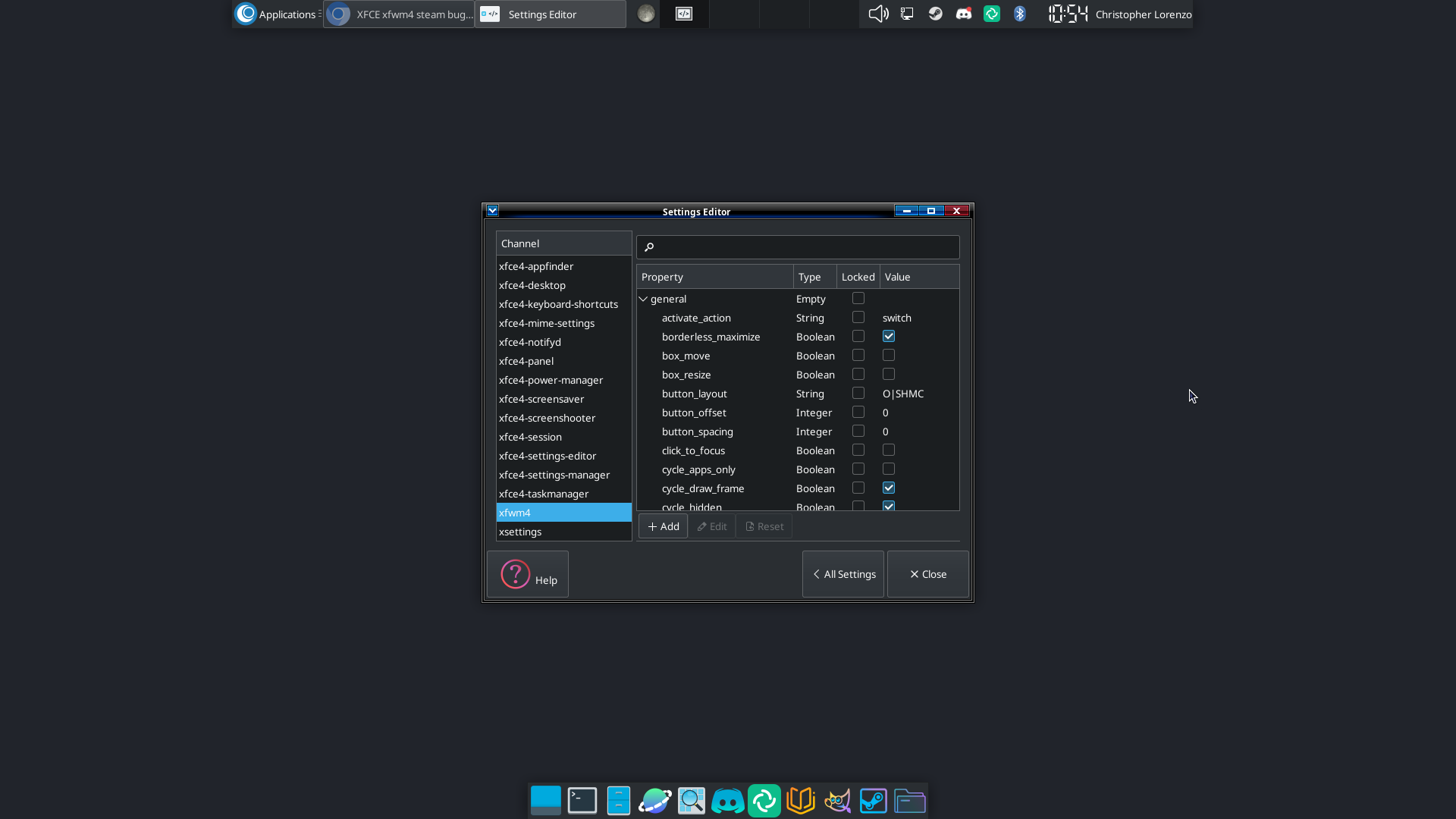

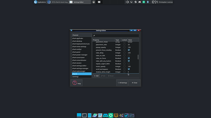

I seem to have fixed the issue. You have to go to
settings manager > settings editor > go to xfwm4 under channel > uncheck raise on click and check raise on focus…will post screenshots
