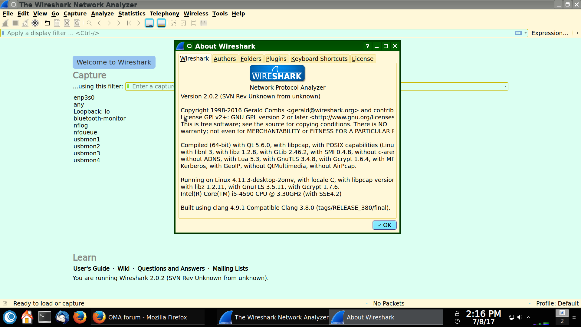

I am getting this error in Wireshark.
in Wireshark (root user) I am getting this. As I remember OM LX 3.02b this did not generated.

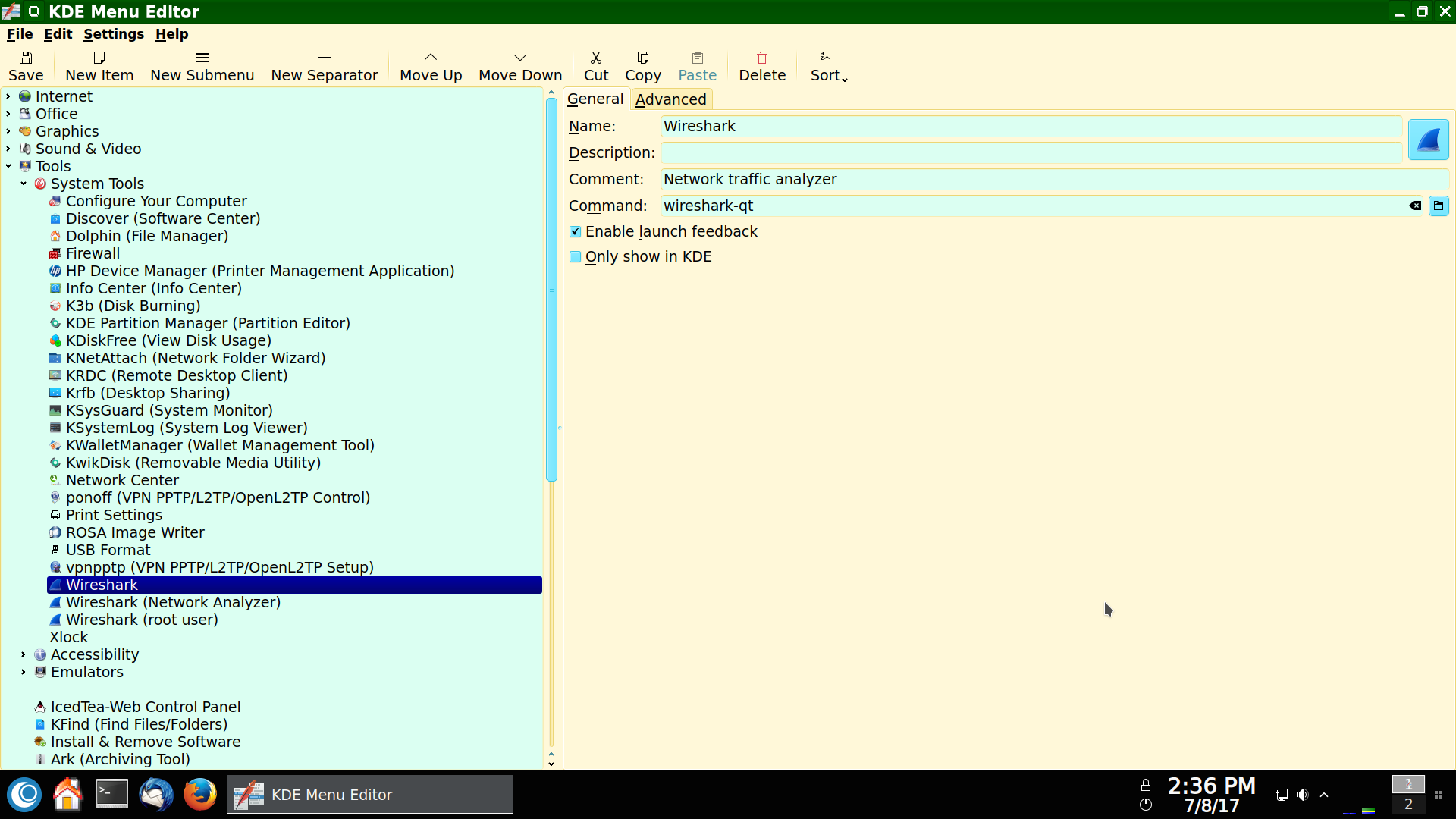

The first error is bug indeed: wireshark-qt doesn’t exist but wireshark does. A workaround can be either:
– edit the menu’s entry and change the application (wireshark-qt → wireshark). This can be done as simple user.
or
– as root create an symlink to wireshark called wireshark-qt in /usr/bin/
ln -s /usr/bin/wireshark /usr/bin/wireshark-qt

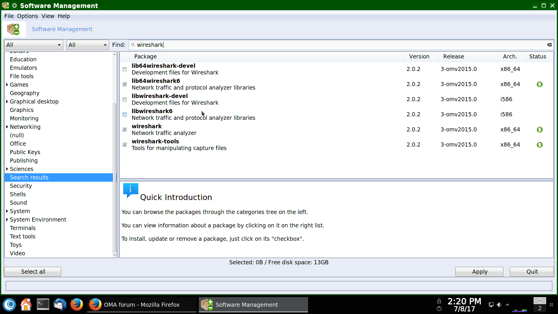

I don’t see wireshark-qt in OpenMandriva repositories, did I miss it? Wireshark seems working fine here.
Edit: No bug noticed here yet.
We don’t seem to have any wireshark-qt package.
OK, there is a small bug found.
Of the 3 Wireshark entries one does indeed give the error reported in post one. There is one that works just fine and one is for (root user). So as a workaround use the one that works. You could even remove the one that doesn’t work right after you file your bug reports.
