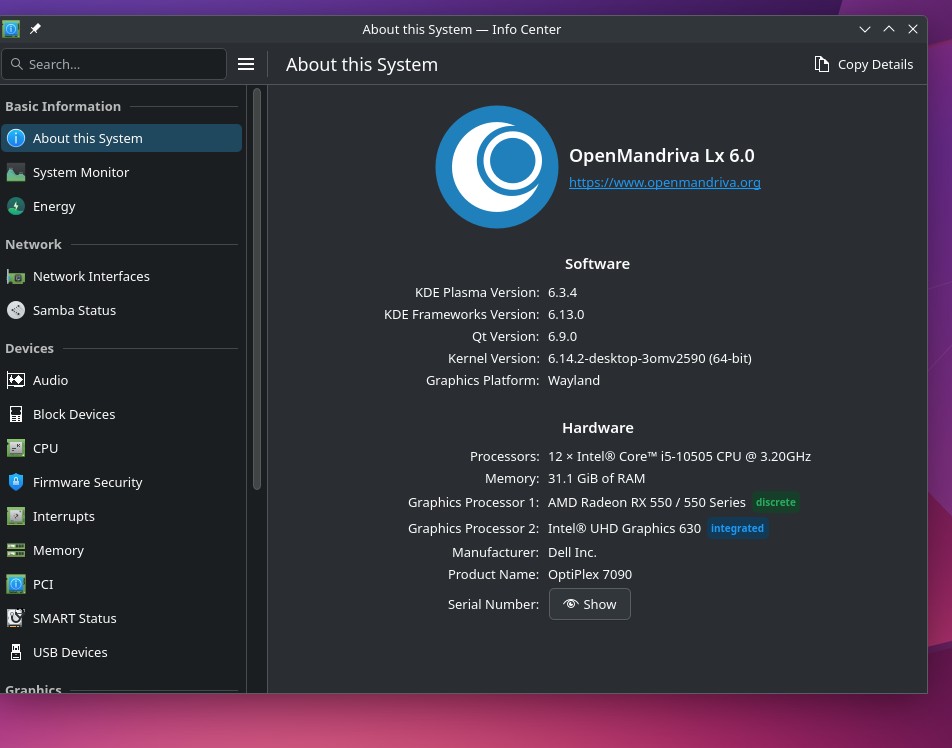

My welcome app loads with video all distorted, I have screenshots of my pc info and the screen byut can’t upload them(screenshots if relevant):
KDE wayland 6.3.4, kernel 6.14.2, primary video card is amd radeon RX 550

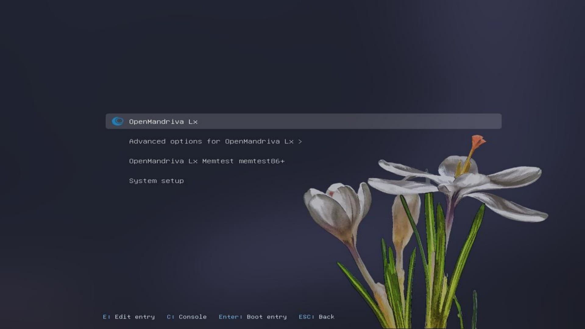

You can just drag and drop the screenshots to the text box. If not possible, use something like Imgur. Also, the 6.14.2 kernel has been acting weird a lot lately, try switching to something like 6.13.9 in the GRUB boot screen.
I’m not seeing any options when it boots up for any other kernel?
Also my discover software center won’t let me install anything.
When you boot up, instead of booting the default option, go to the Advanced Options part and select 6.13.9.
There wasn’t an option there for another kernel
At Advanced options for OpenMandriva Lx > , you should see a couple listed kernels. If it’s just 6.14.2, you need to increase the number of kernels that the system lets you have. Don’t remember where you do that, but @WilsonPhillips may be able to help!

In the first screenshot, you showed you were running kernel 6.14.2-3. That is the correct kernel and should not have any problems. Where did it go?

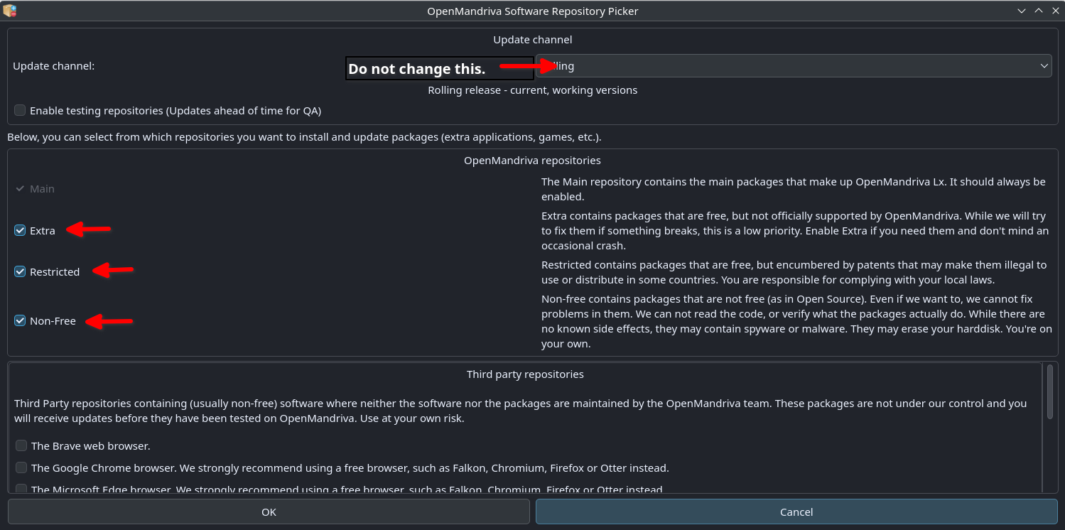

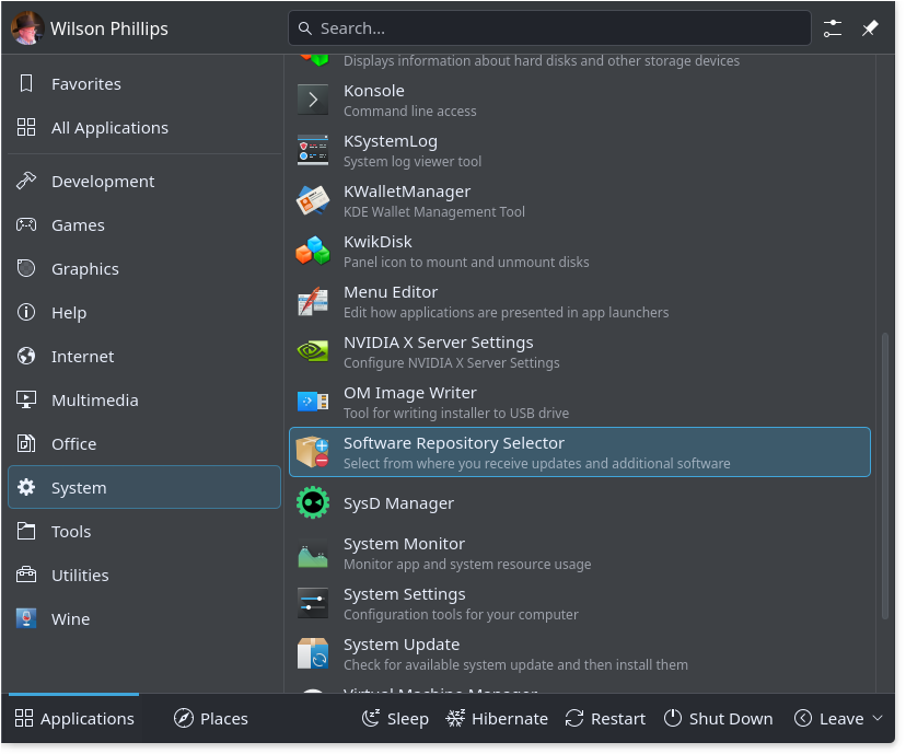

That is the right kernel. It looks like the desktop is loading properly and the only issue is the welcome app is having a problem. Let’s get your repos set. You can do that with the Software Repository Selector.
Open it and set the repos. DO NOT CHANGE THE UPDATE CHANNEL. Set the repos as you need. I use all three. Do not change repos any other way than this.
Now, you will be able to do updates. Although, for right now, you will need to do them from the command line. Paste this command in and use it.
sudo dnf clean all ; dnf clean all ; sudo dnf distro-sync --refresh --allowerasing 2>&1| tee dsync2-log.txt
