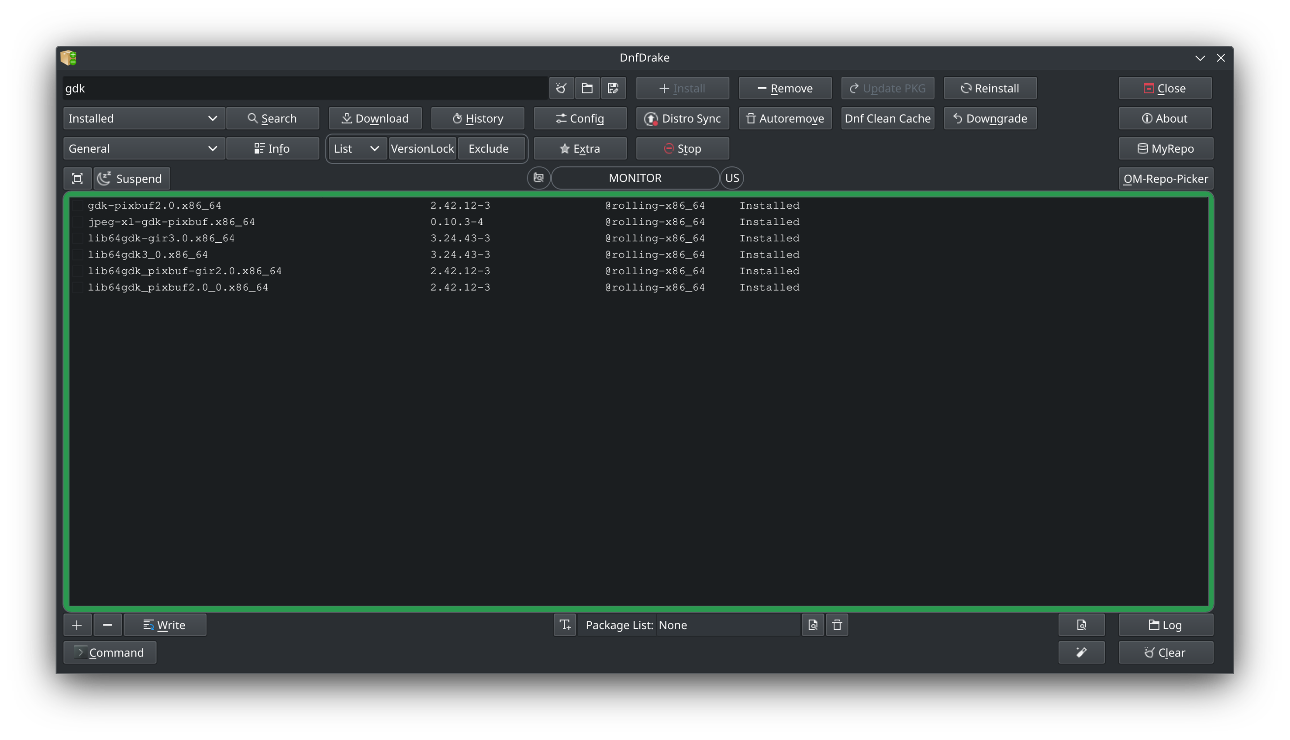

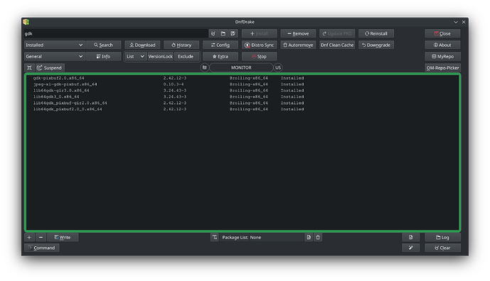

I’ve been using virt-manager without issue on Rome. So, I did check on what gdk packages I have installed and came up with the list below. My guess is lig64gdk3_0 or possibly lib64dgkx11-gir3.0 is needed, but it’s hard to say for sure.
  • gdk-pixbuf2.0.x86_64
  • jpeg-xl-gdk-pixbuf.x86_64
  • lib64gdk-gir3.0
  • lib64gdk3_0
  • lib64gdk_pixbuf-gir2.0
  • lib64gdk_pixbuf2.0-devel
  • lib64gdk_pixbuf2.0_0
  • lib64gdkmm3.0_1
  • lib64gdkx11-gir3.0
And, I almost forgot. Welcome!
I can confirm virt-manager works for me too with no issues and with these gdk packages installed.
