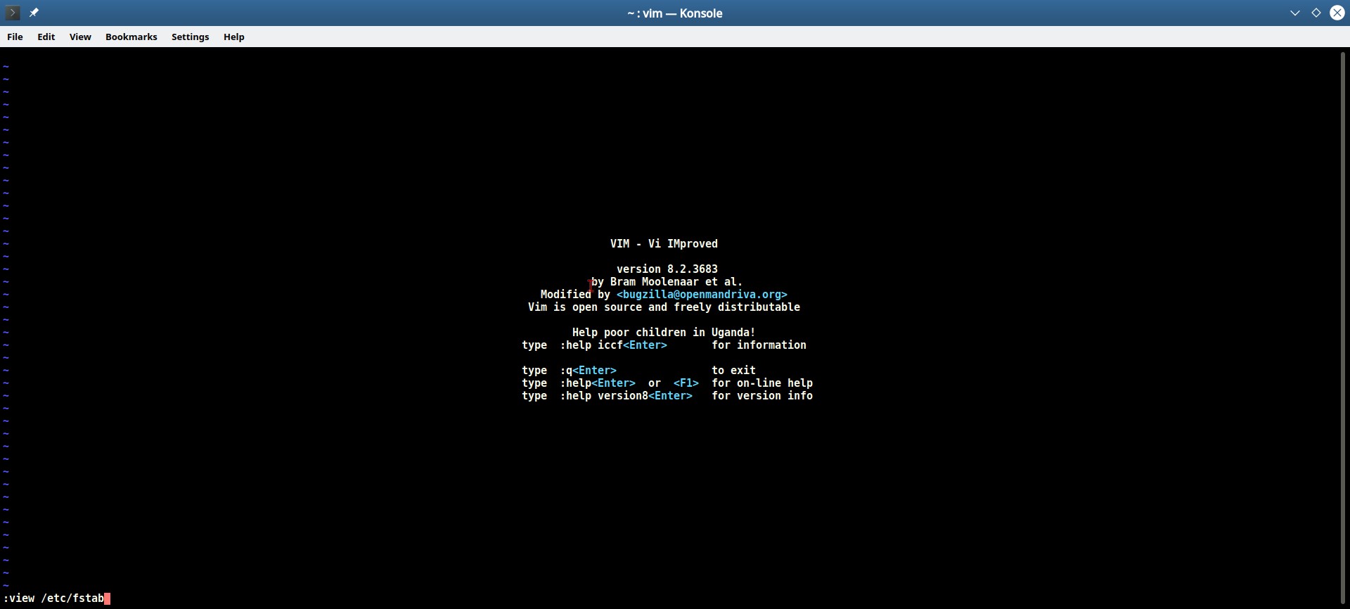

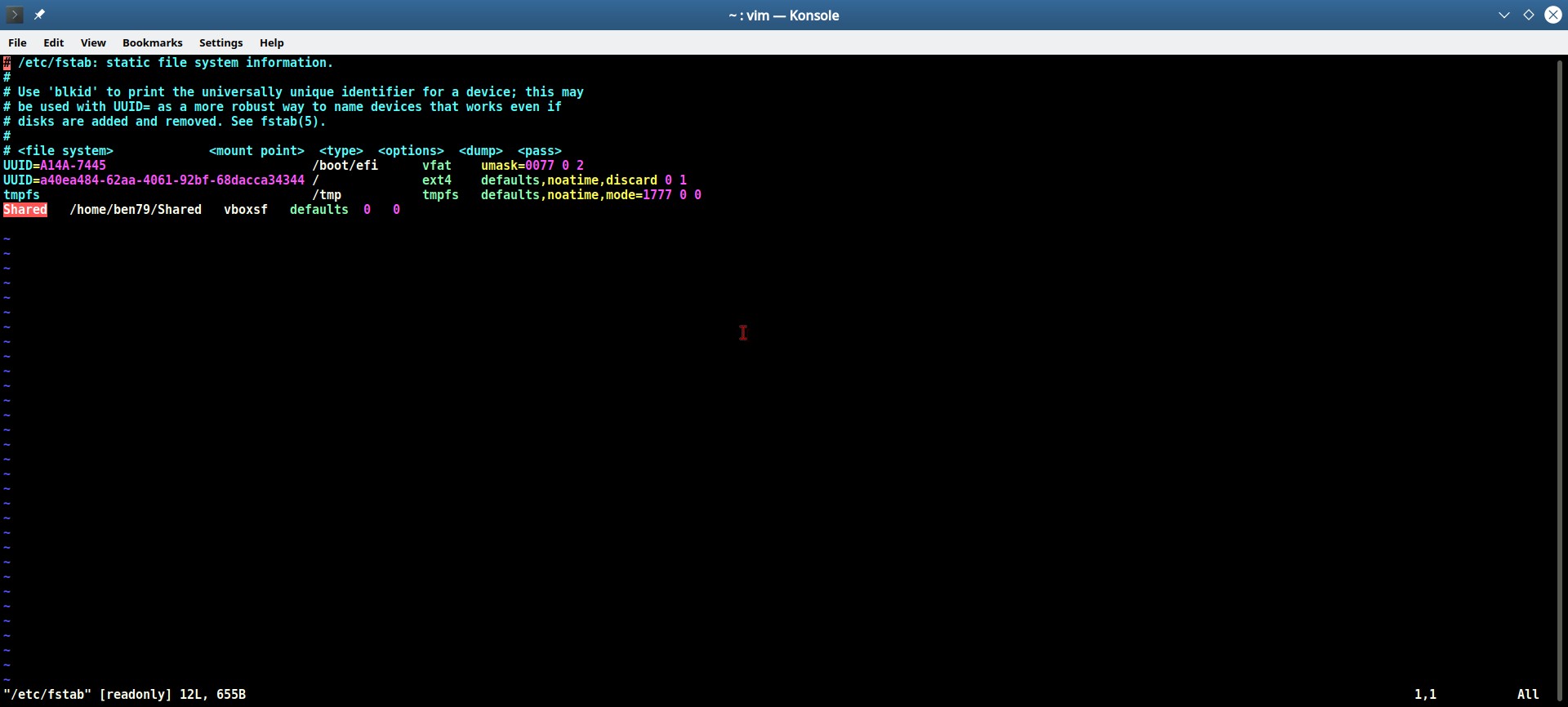

So I opened a vim editor in Konsole and typed:
: view /etc/fstab
And /etc/fstab opens in read only. So this would seem to be working if I am interpreting correctly what you mean. To run from Konsole to open a file with vim view mode (read only):
