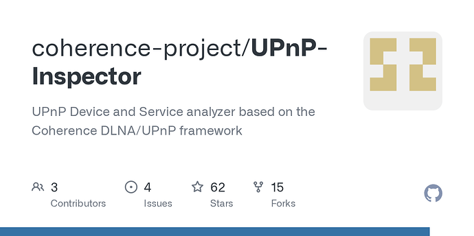

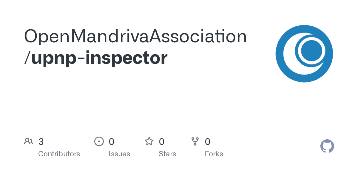

This package appears to be abandoned, no activity in 8 years by OM.
Also appears to be abandoned upstream.
The package depends on other packages that are to out of date like python2.
The Inspector requires
  • Python 2.x or higher (tested with 2.6, but other versions should work, too, Python 3.x is not supported),
