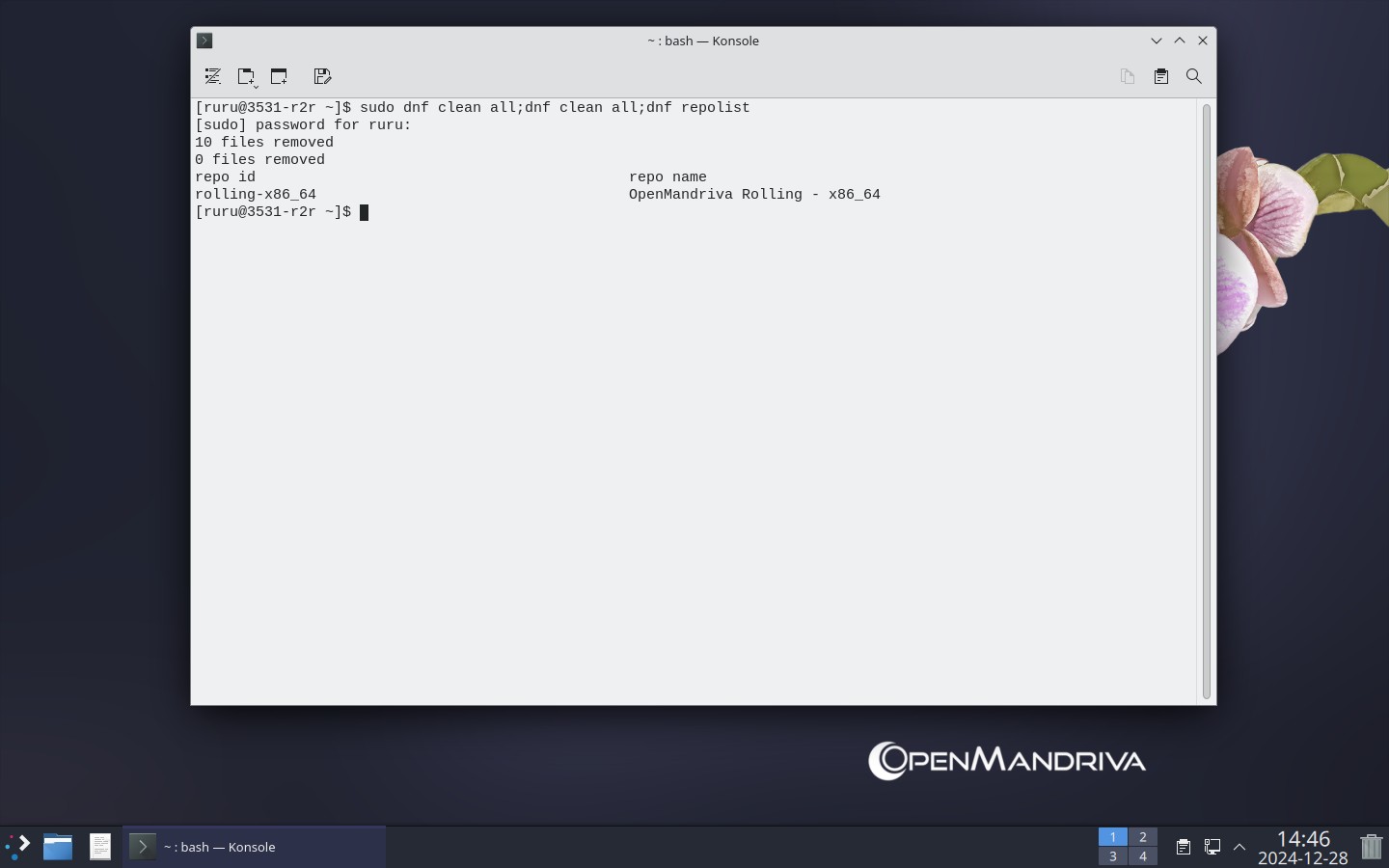

  4. Upgrade system like this:
sudo dnf clean all

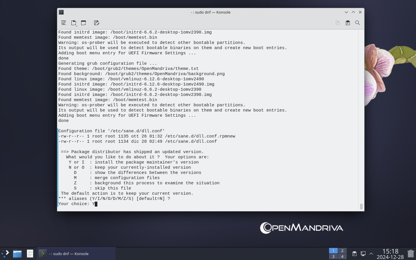

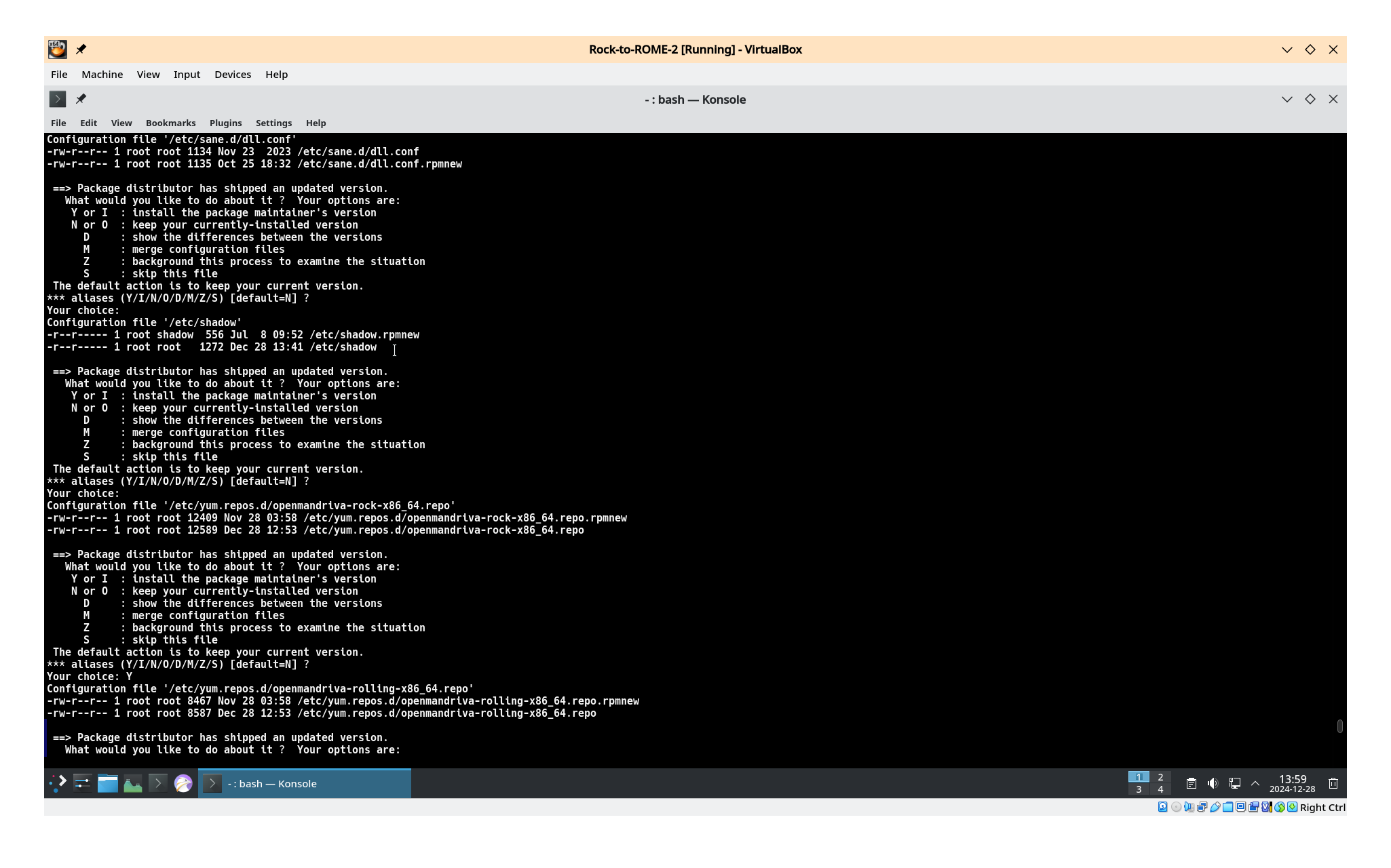

That command will create the log file rocktorolling-dsync.log.txt for you to attach to your forum post or bug report should you encounter errors or problems. At the end of the dnf transaction being performed you will be presented with some rpm dialogs:
For Configuration file '/etc/sane.d/dll.conf' hit enter for the default option.
For Configuration file '/etc/shadow' hit enter for the default option. This one is important, if you select the /etc/shadow.rpmnew file you will remove all users and passwords from your system. Do not do that.
For Configuration file '/etc/yum.repos.d/openmandriva-rock-x86_64.repo' enter Y to install the new file. Yes this is also important. (Because of a repo name change)
For Configuration file '/etc/yum.repos.d/openmandriva-rolling-x86_64.repo' enter Y to install the new file. Yes this is also important. (Because of a repo name change)

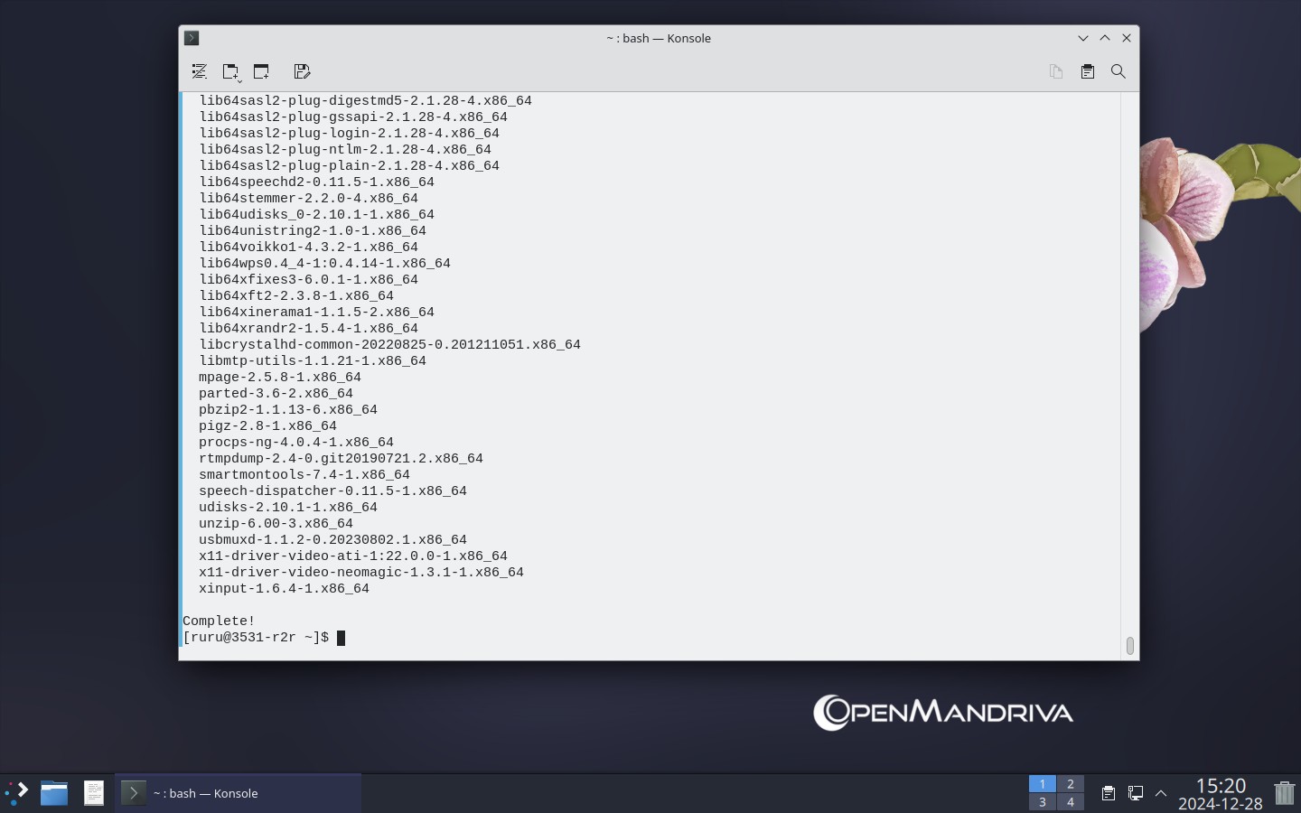

  1. It is recommended to then run dnf autoremove to remove old, no longer used, packages originally installed as dependencies like this:
sudo dnf autoremove 2>&1 | tee rocktorolling-autoremove.log.txt
That command will create the log file rocktorolling-autoremove.log.txt for you to attach to your forum post or bug report should you encounter errors or problems.
