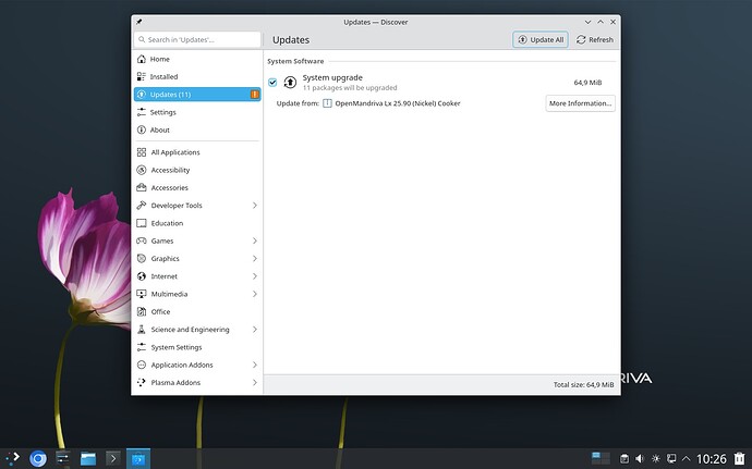

So, I wanted to test updating with Discover after @bero changed it. My results.
I opened Discover and waiting for it to tell me how many packages I needed to update.

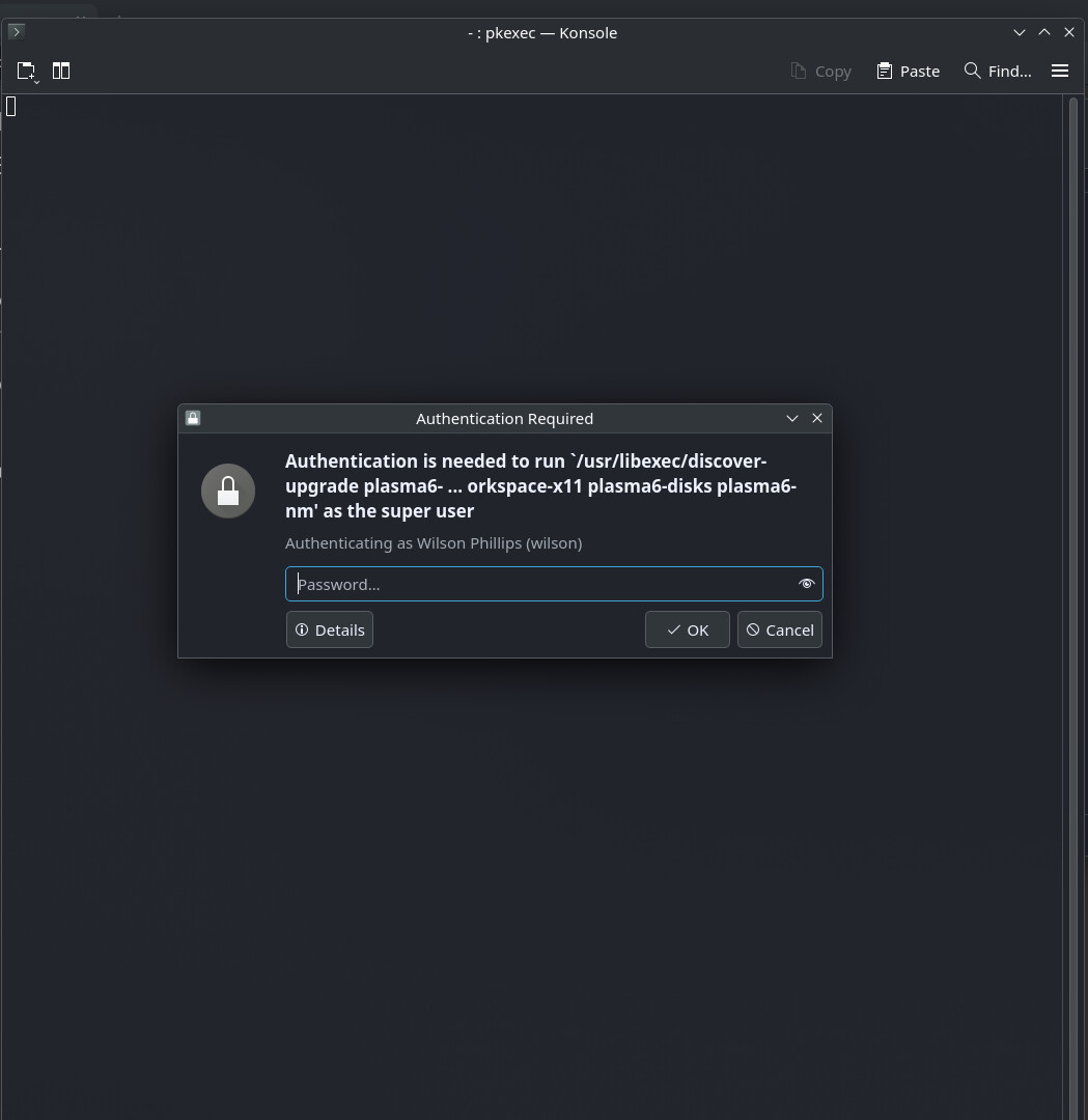

At the top I clicked Update All and was immediately given a popup of Konsole asking for the sudo password.

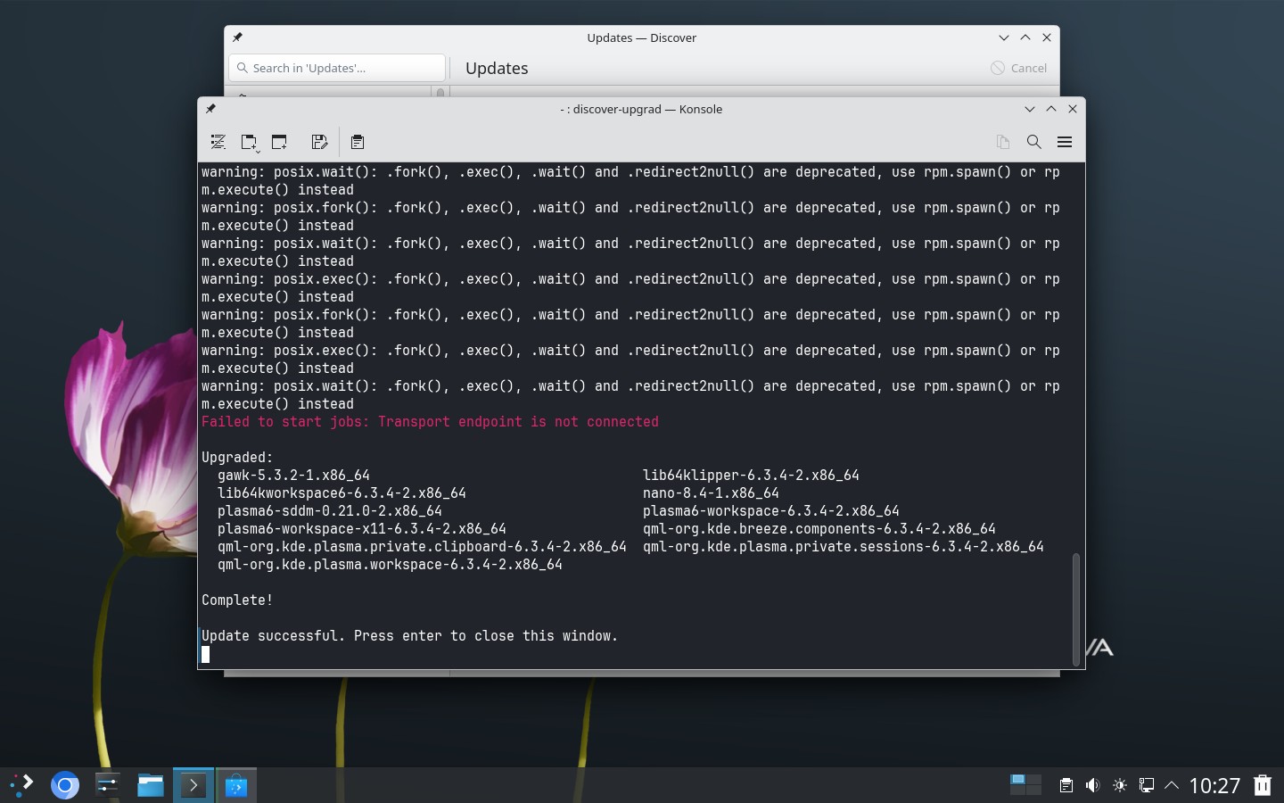

I entered the password and was given Konsole and could watch the progress.
At the end, I pressed Enter and was taken back to Discover, looking like nothing has been done yet. I closed out the Discover window. I still have a small notification window down by the clock that won’t go away, but I am not too worried about that, as I need to reboot now anyway.
EDIT:
I just checked and it did create a logfile in my home directory.
~/dsync2-log.txt
This will help us to diagnose problems.
