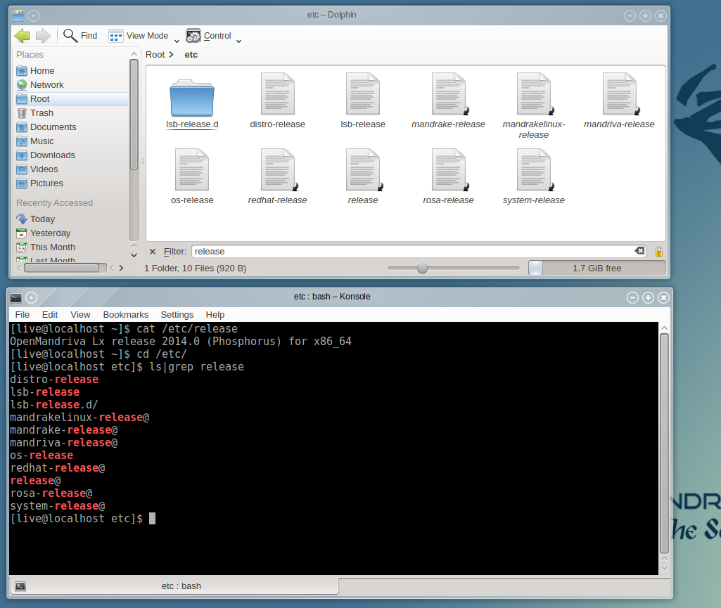

It seems that the fresh install of 2014.0 do not have symbolic links like,
/etc/release, /etc/redhat-release or /etc/rosa-release
pointing to the (also absent) file,
/etc/distro-release
which contains in my own working system,
OpenMandriva Lx release 2014.1 (Phosphorus) for x86_64

Live mode, with above repository set, updates around (IIRC) 600 MB of packages, among them FF 47.0 for example.
Btw I didnât run update, just launched for test but enough to see it could work.

Donât understand why I had not seen /etc/release files in first attempts but they appeared in last attempts. Also no /var/cache/urpmi/mirrors.cache âŚ
