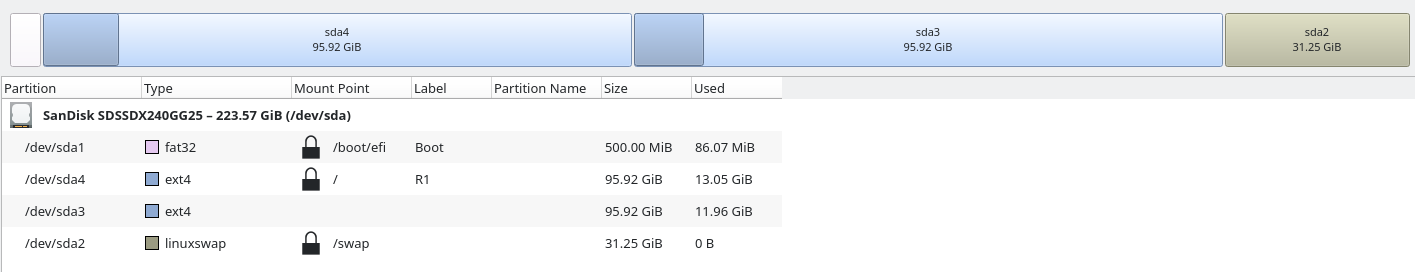

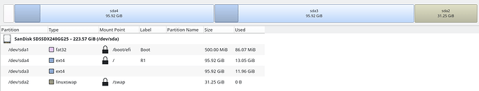

I recently set up another computer with a dual-boot installation. I firstly installed OpenMandriva and in this case the second OS was Lubuntu 24.04. I have attached a screenshot below on the main drive partition layout. This is an old PC with multiple HDD’s, the second drive has a 50/50 split with a /home folder for each OS installation.

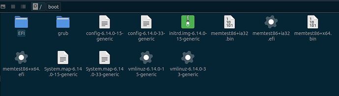

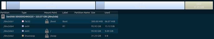

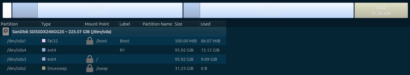

Unfortunately I had a momentary brain fade when installing Lubuntu, and instead of tagging the vfat partition as “/boot/efi”, I tagged it as “/boot”. So my vfat partition contains /boot/efi from OMA and /boot from Lubuntu. This is a problem because Lubuntu is having symlink errors with /boot being a vfat partition, I can probably just reinstall Lubuntu.
My question here is, how can I safely identify which files in that partition do NOT belong to OpenMandriva?
I want to at least attempt to fix the Lubuntu side for the learning experience, but it’s a fresh install with no content so I won’t mind if I have to scratch it and start over.

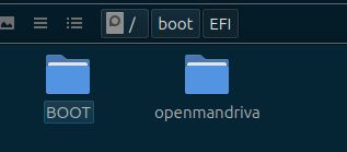

Everything other than the ‘EFI’ directory belongs to Lubuntu. You can see that in the 2nd image in your 2nd post. On my system, /boot/efi/EFI contains the following,
[sv@cooker-x11 ~]$ sudo ls /boot/efi/EFI BOOT openmandriva 'OpenMandriva_Lx_[GRUB]'
Do not worry about ‘OpenMandriva_Lx_[GRUB]’ if you are able to boot into OpenMandriva. You are fine on OM side.
