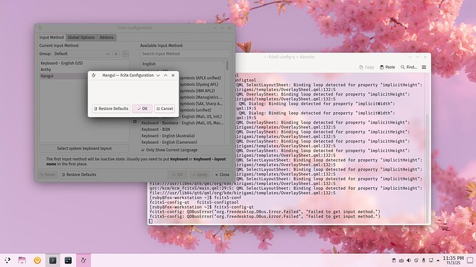

I am unable to get fcitx5-anthy to work. The installation of fcitx5, fcitx5-anthy and other related packages which are installed automatically do work just fine, but when I try to type with it, a box appears saying ‘Anthy (Not Available)’. The same happens with Korean typing fcitx5-hangul. I have customized the .bash_profile with relevant environment variables. I have also read older topics from 2023 regarding issues with fcitx, but the solution seems outdate for today’s packages since that was for fcitx4. I tried, but it still didn’t work as intended. I would appreciate any help with this. Thank you.
EDIT:
I have found this error if I try to run fcitx5-config-qt manually from a terminal. I decided to try and make a .xinitrc with “dbus-launch –exit-with-session startplasma-x11” in it but the result was the same. The error happens if I try to click the configuration button inside the fcitx configuration window.
