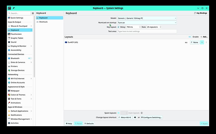

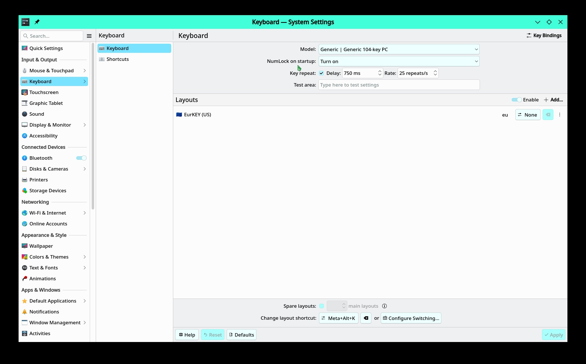

Under “Keyboard” in the KDE Settings menu there is a “NumLock on startup” drop-down that can be set to “Turn on.” Does that work for your situation?
Welcome @mrmazda.
What desktop are you using?
Edit: If Plasma6:
I do not know why this is not enabled by default, to me it seems it should be, but there may be some reason.
Make sure Num Lock is on in the BIOS/UEFI
I know that works for Plasma, but I don’t see how a Plasma setting would, or should, be responsible for behavior on ttys. This needs to be done from without X, whether X is working or not. Ttys don’t need X working, but they do need dependable keyboard behavior.

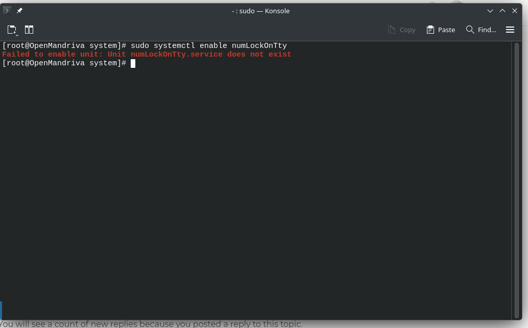

All files moved in correct places, but getting this error. I am still trying to figure it out.
It really needs to be in package format, so you can download it from github, make or whatever you wish, and then it just installs.
If you are already root, you don’t need sudo. Don’t know if that is the problem.
No I have tried it both ways. It just cannot find the file
I figured it out!!!
Using the locations given in the AUR, Here are the steps
first make the numlockOnTty executable,
chmod +x numlockOnTty
Then type
sudo mv numlockOnTty /usr/bin/numlockOnTty
(this is the important part here)
rename numlockOnTty.service to numlockontty.service (all lowercase)
then you can
sudo mv numlockontty.service /etc/systemd/system/
once done
sudo systemctl enable numlockontty --now
