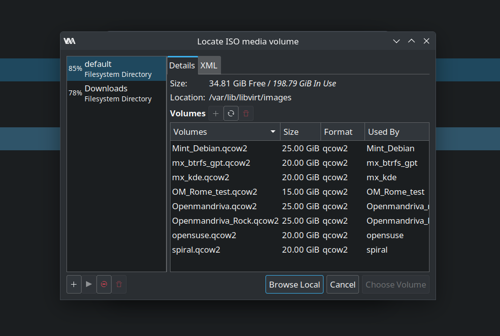

I am finally getting around to installing a ISO into virt-manager. Here is what I see as a first time user.
I had to move the ISO from ~/Downloads to /var/lib/libvirt/images

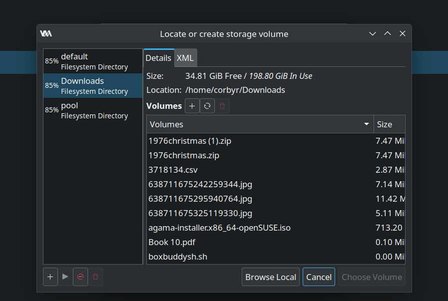

Again no expert but you can open the ISO from anywhere by selecting “Browse” at the select ISO dropdown then “Browse Local” from the bottom of the popup and navigate anywhere including Downloads

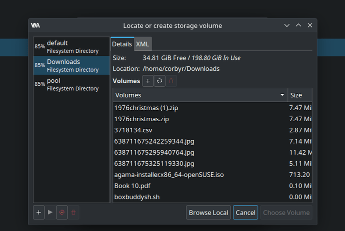

You can definitely add your pool using the + in the lower left of the same popup but you would have to do a few more steps to create a new VM disk in that pool.

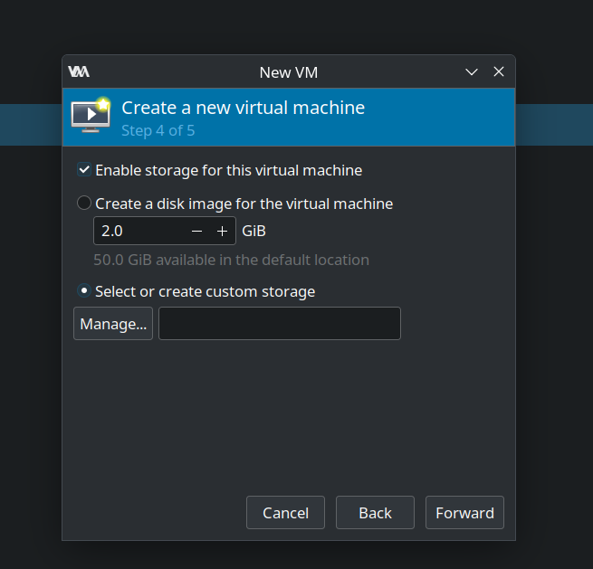

Set the size then “select or create custom storage”
then select your pool on the left of the popup and then “+” under volumes
(you actually might set the size on this next popup only, not entirely sure )
