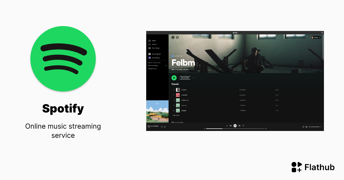

Use the link on the dropdown arrow next to the Install button (or try the install button):
I believe that “dnf install” is not for use with Flatpaks.
Correct, you don’t use that for flatpaks.
Just retried those lines of code and got them sorted, rebooted and back to that Spotify webpage and hit the Install button I get “error: app/com.spotify.Client/x86_64/master not installed”
