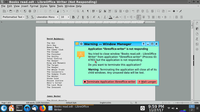

Screen shot. I make a change to an .odt document and attempt to save and this happens:

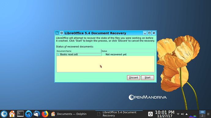

And then when a wait 180 seconds and then terminate file and attempt to open it again I see this:
and after I let it recover the document I see that my change was not in fact saved. Ergo this version (5.4.3) of LibreOffice is broken for me and at least some other users.

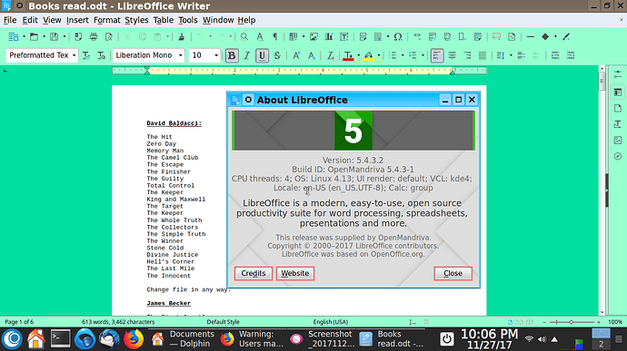

This screen shot simply shows the version of LibreOffice with this issue.
The same version from libreoffice.org works well.
