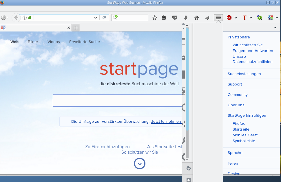

I can’t work with Firefox. It’s impossible to enter a www.-adress or google-search.
No Menu is present.
What may be the reason for that?
My system is OpenMandriva Lx 3.0 (64Bit) in a VirtualBox.
with regards
Ch. Hanisch

Try this, on the right side near the top there is an icon with 3 horizontal lines. Select that and in lower right corner where it says Show/Hide Toolbars select Menu bar and any other you want.
Select customize.

I have copied the ~/.mozilla from my Original-User (bad Firefox) to the test-User and the Firefox will work fine in the test-User.
i was talking about gtk themes and windows decoration. yours seem not the default.
How can I set the Defaults?
