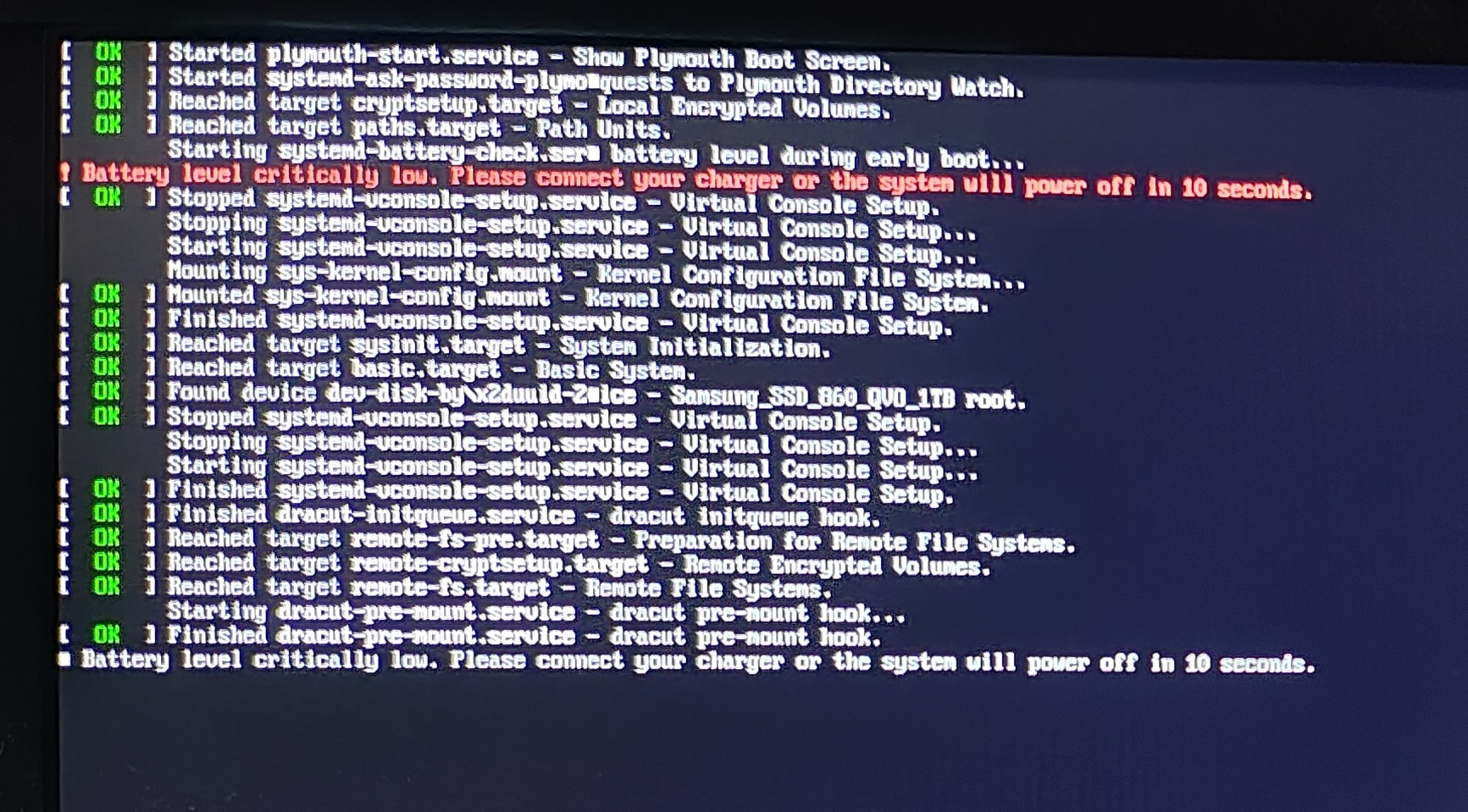

At startup, in the early boot, it appears the following message
! Battery level critically low. Please connect your charger or the system will power off in 10 seconds.
and then it stopped the boot and power off the laptop.

I suppose it’s related to some systemd service (i.e. systemd-battery-check.service).

I physically disconnected the battery and now the system doesn’t see it, so there is no battery check and the OS can boot properly even after a reboot.
I thought it was possible to disable the critical level check when the battery is damaged without physically remove it.
