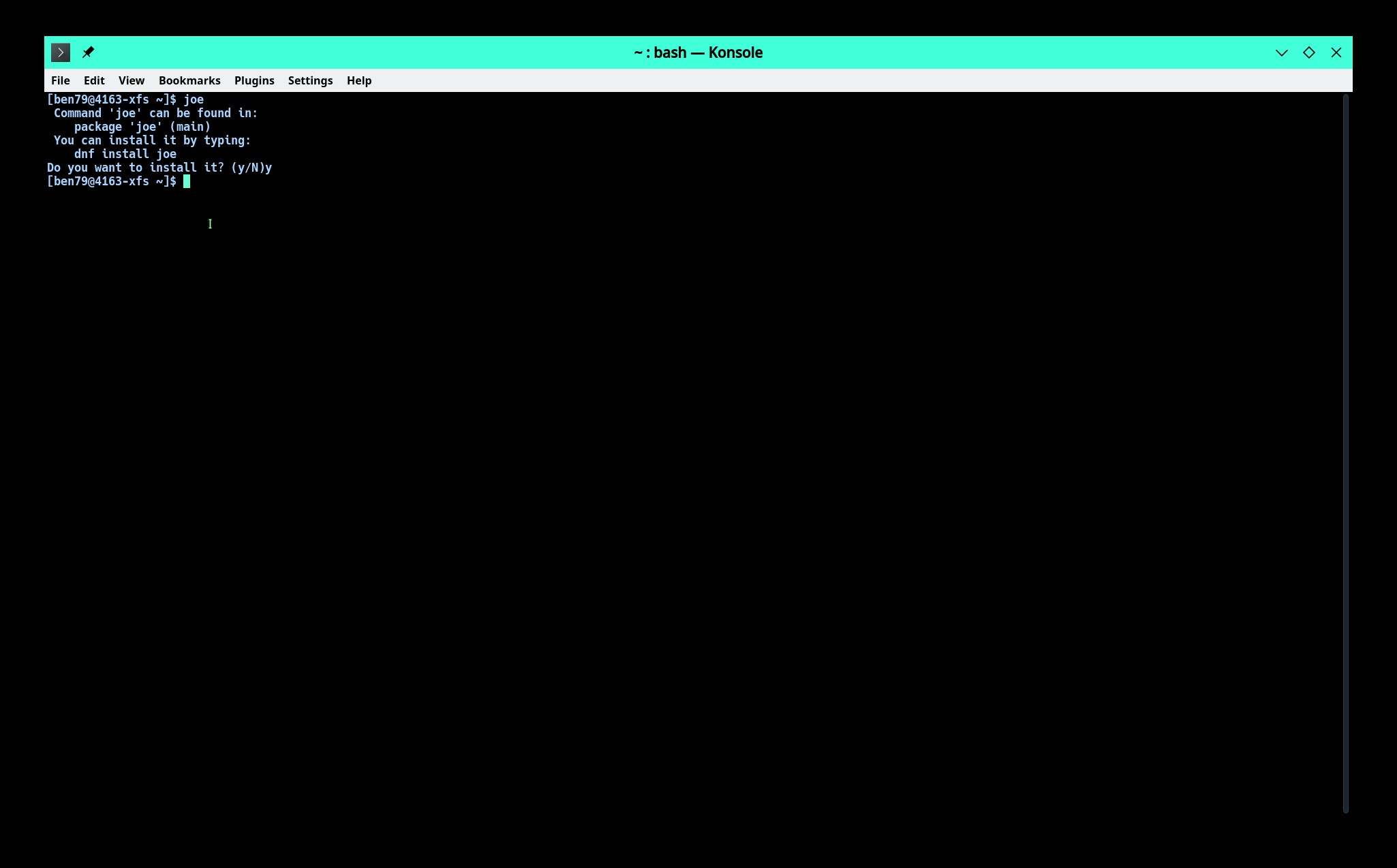

[sv@cooker-x11 ~]$ rbenv
rbenv: command not found
[sv@cooker-x11 ~]$ hyprlauncher
hyprlauncher: command not found
[sv@cooker-x11 ~]$ app2unit
app2unit: command not found
[sv@cooker-x11 ~]$ helium
helium: command not found
[sv@cooker-x11 ~]$ joe
 Command 'joe' can be found in:
    package 'joe' (main)
 You can install it by typing:
    dnf install joe
Do you want to install it? (y/N)y
[sv@cooker-x11 ~]$
I don’t know what Joe or caja are, but could the difference here be because some of those are intended to be terminal utilities and some are just intended to launch a separate GUI application?
@LeeTalbert, joe is a text editor and caja is file manager of MATE desktop. One is CLI application (I’m not sure if joe also has GUI counterpart like emacs does) and the other is GUI application. So, that is not the reason. What I meant was without the data.json file used by command-not-found being up-to-date, the output will now have three variation instead of two. :smile:
I am using Cooker in a qemu vm at the moment and it still has the old behavior. So actually things may be worse, the behavior seems to be inconsistent. I am definitely seeing different behavior in my hw Cooker vs. my qemu vm Cooker.
