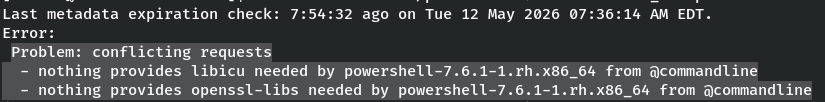

  2. The following command was failing & I couldn’t get it working:
    sudo dnf install ./powershell-7.6.1-1.rh.x86_64.rpm
  3. You’ll see some errors that are related to missing libraries:
  4. I installed libicu via : sudo dnf install libicudata.x86_64
  5. I also installed ssl libraries
  6. But it still failed the same way when installing powershell.
  7. Finally, I found the following command and it worked great:
    sudo rpm -ivh --nodeps powershell-7.6.1-1.rh.x86_64.rpm
The dependencies are already there so once you start powershell ($ pwsh ) everything will work fine.
