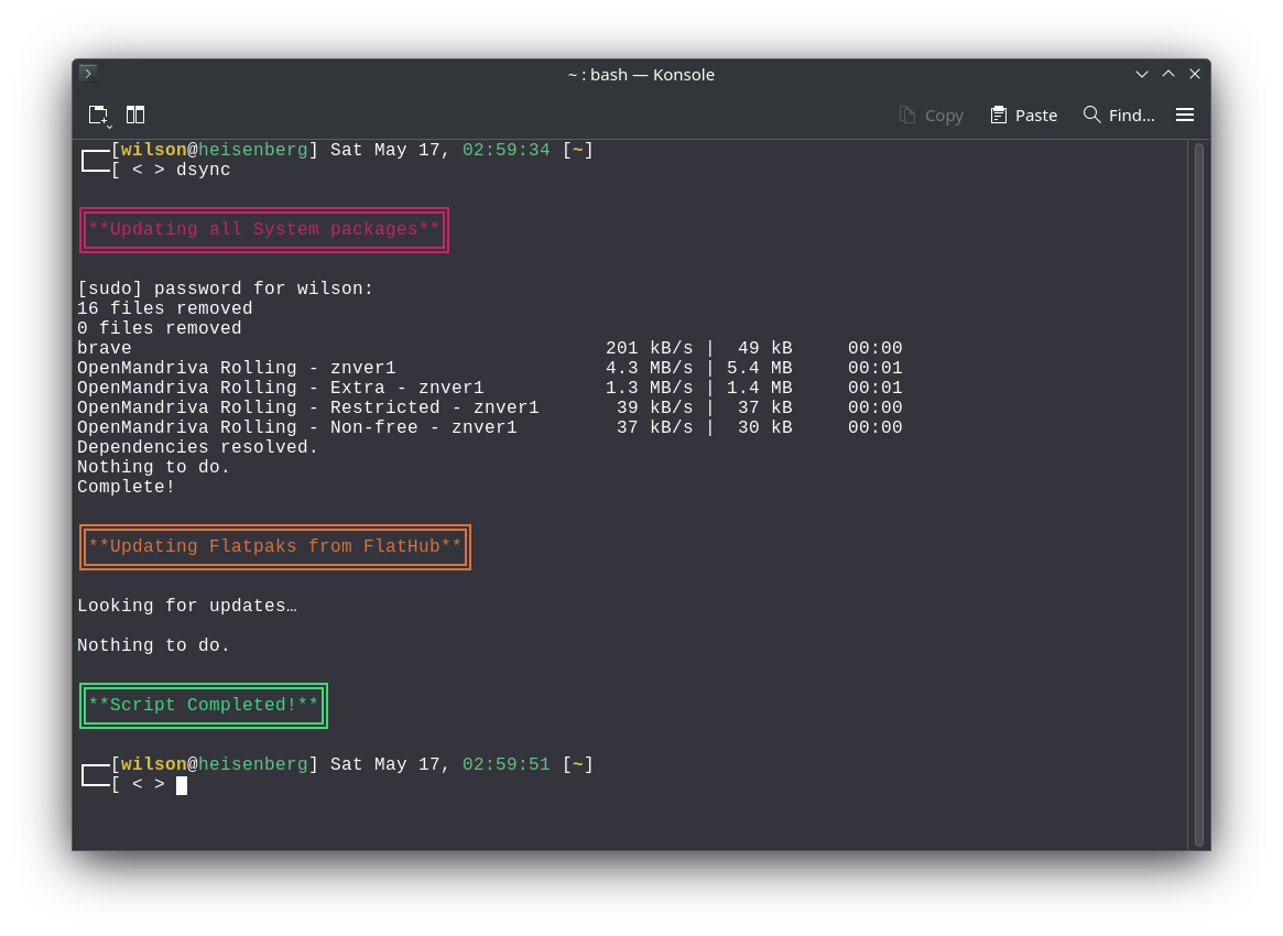

Rice for the sake of rice in an update script
This is just a way to make a simple script that runs our update commands. It serves no purpose, other than to look cool. It is tied to an alias that you can put in ~/.bashrc or ~/.bash_alias. Konsole is themed with OMDark.

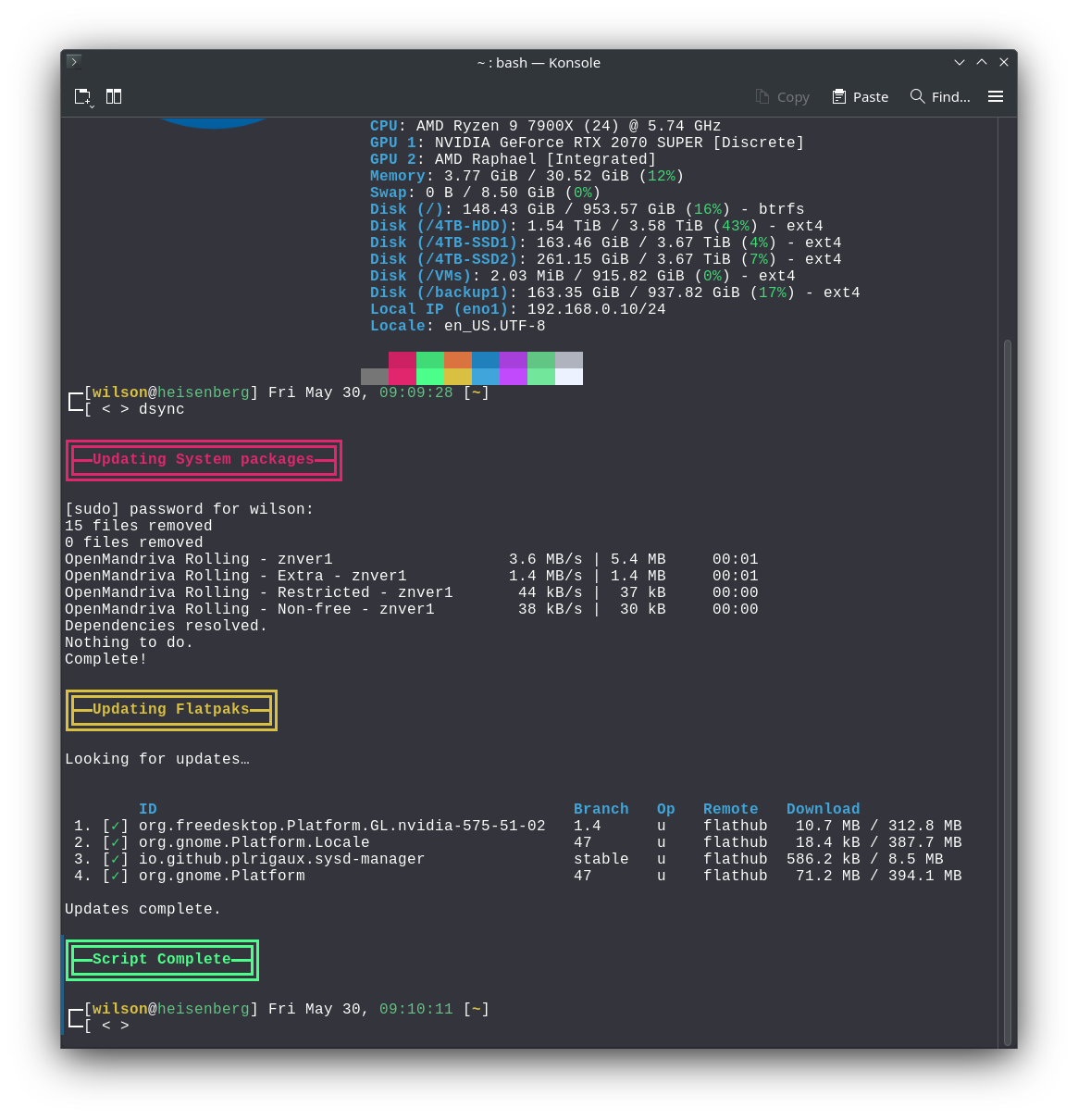

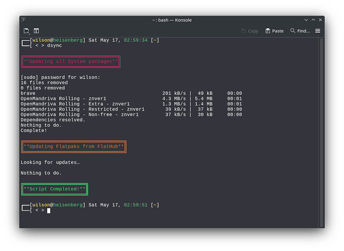

As you can see, I call the script with the alias dsync

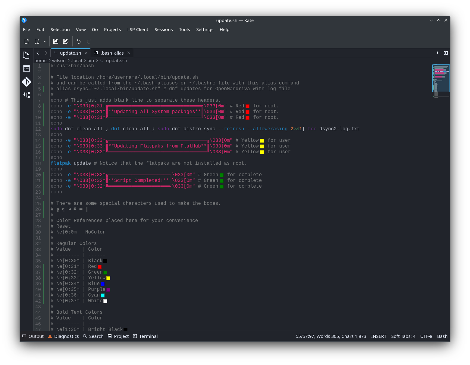

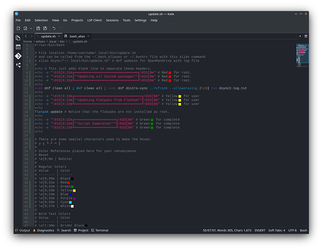

This is what the script looks like in Kate. To make it all line up correctly, Kate needs to use the same monospace font that Konsole uses. This is our default Liberation Mono. Kate is themed with OMDark.
The script is only several lines long, but the rest of the script is there for documentation of how it is done and color reference codes. These use the block of 16 colors that you see in neofetch or fastfetch. Here is the script in text form and as an attachment.

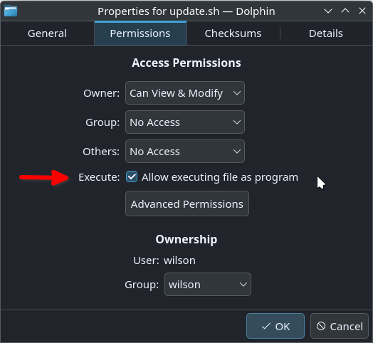

When you download it, place it in ~/.local/bin/ and remove the .txt from the name. Make sure the file is executable.

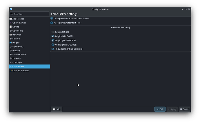

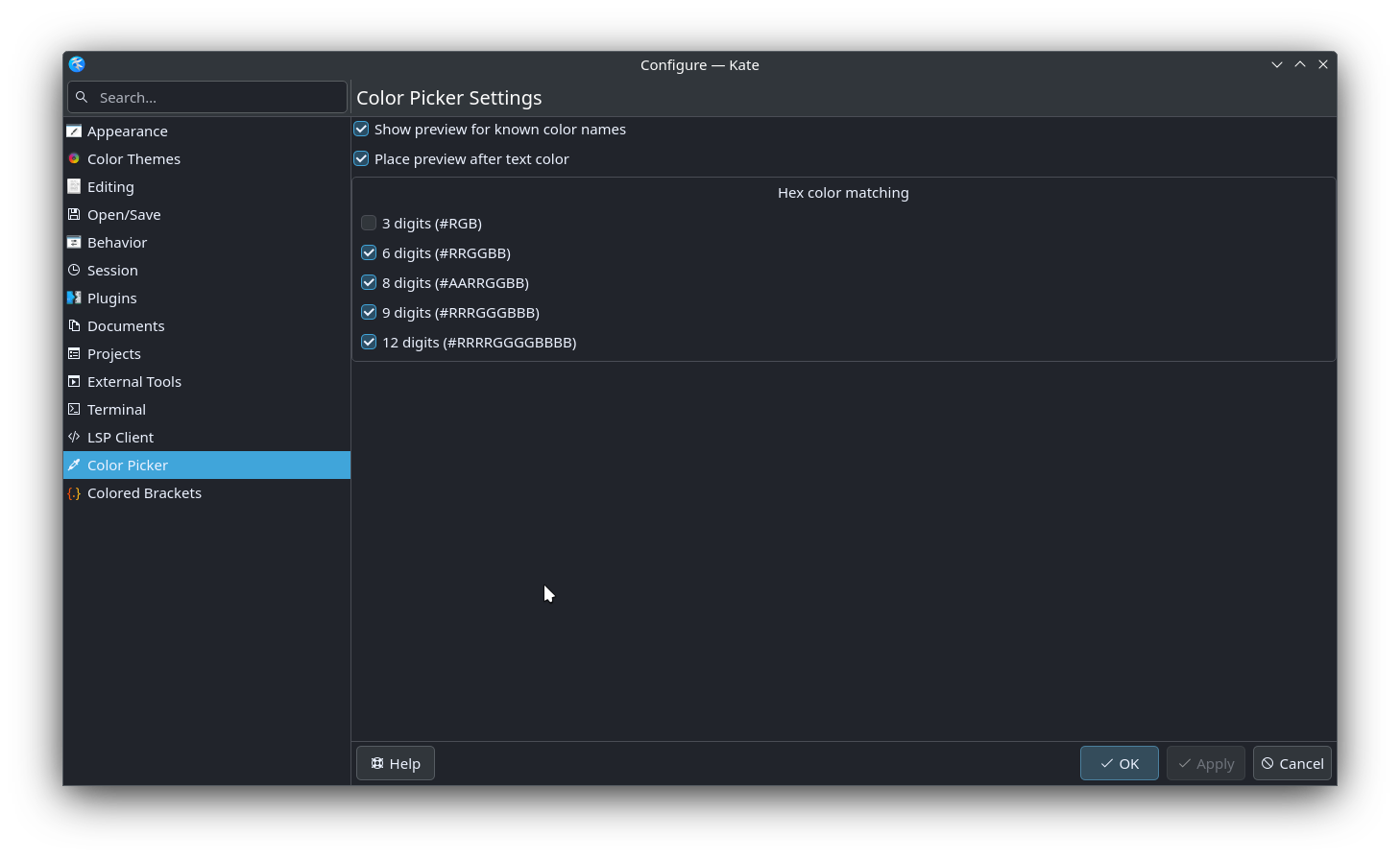

Hint, before you ask how I get the little color squares to show up beside the colors in Kate, go to Settings > Configure Kate > Plugins > Color Picker. It will then show up at the bottom of that list and you can set the options for it.

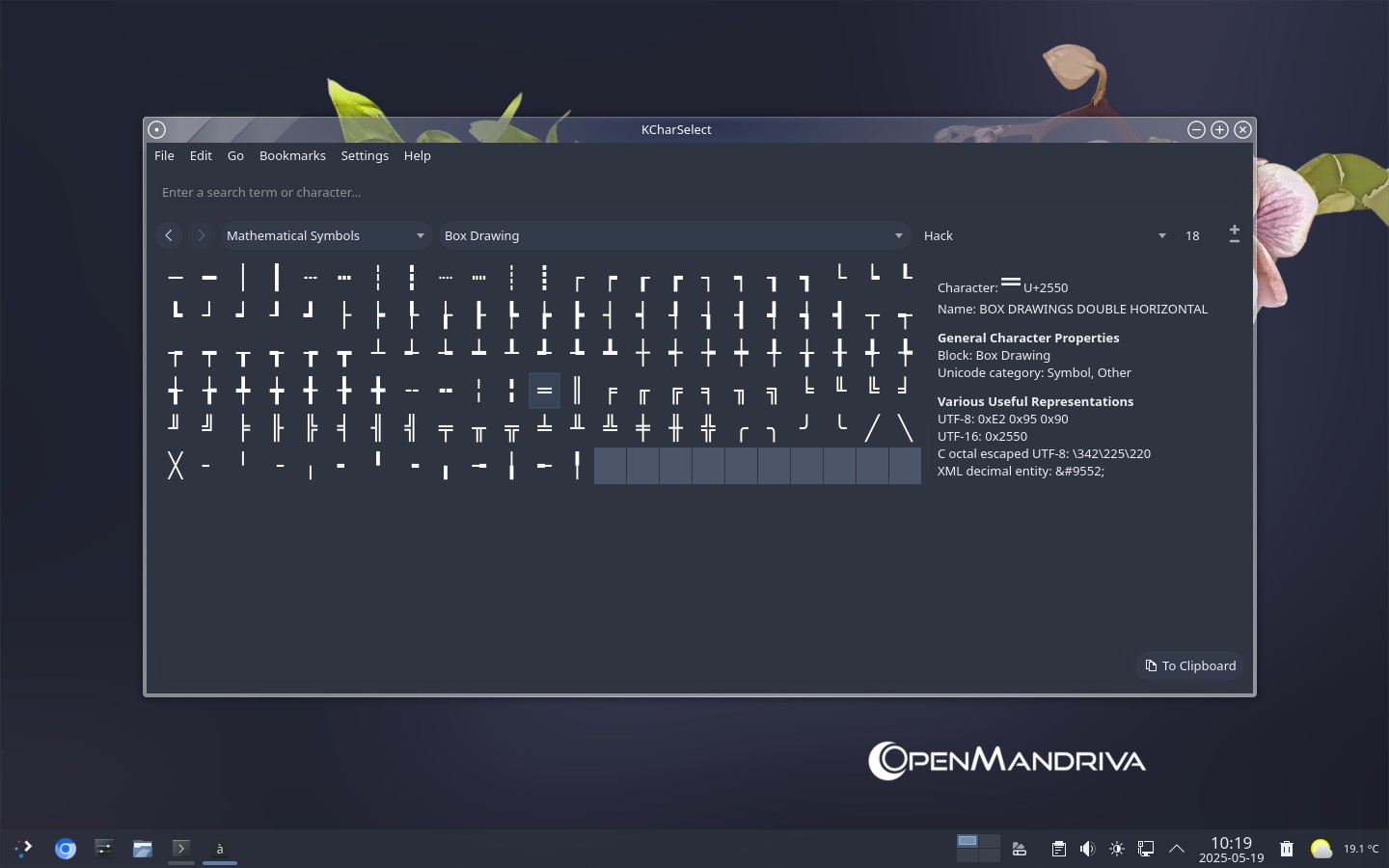

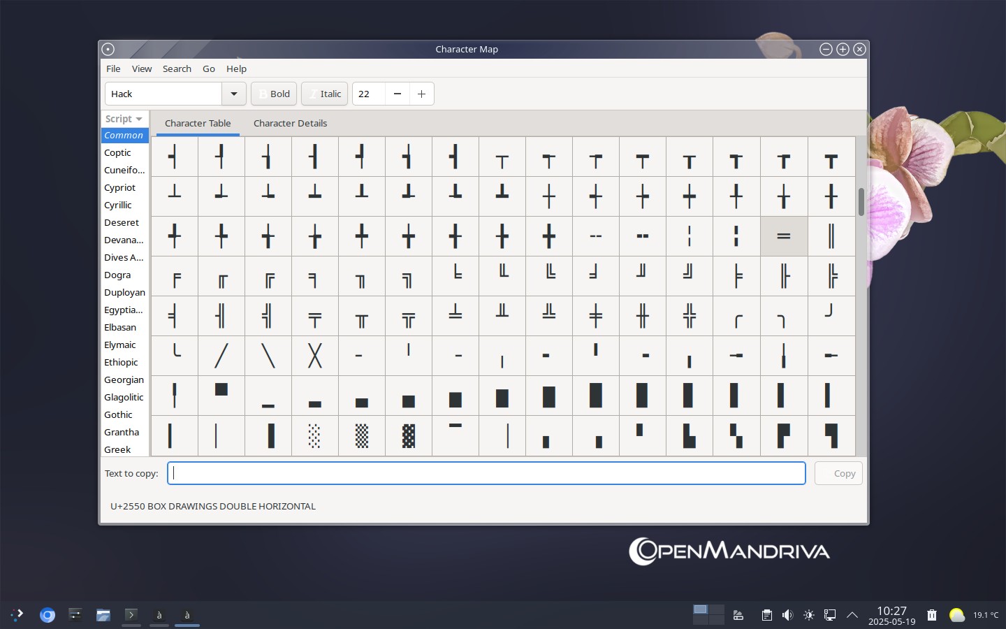

gucharmap as the name suggests is gnome stuff :stuck_out_tongue:
FWIW in kde we have kcharselect
sudo dnf install plasma6-kcharselect --refresh
Better or worse, I can’t say. Just for your information.
I did a dnf search and gucharmap was the only thing that showed. I am wondering if I am missing something.

O.K. Let’s see what you can do with this script and the character map.
echo -e  prints the line to the screen
   |      sets the color                 sets the color
   |      |      color                    |    color
echo -e "\033[0;31m╔═════════════════════╗\033[0m"
             not bold
0=not bold or regular
1=bold or bright

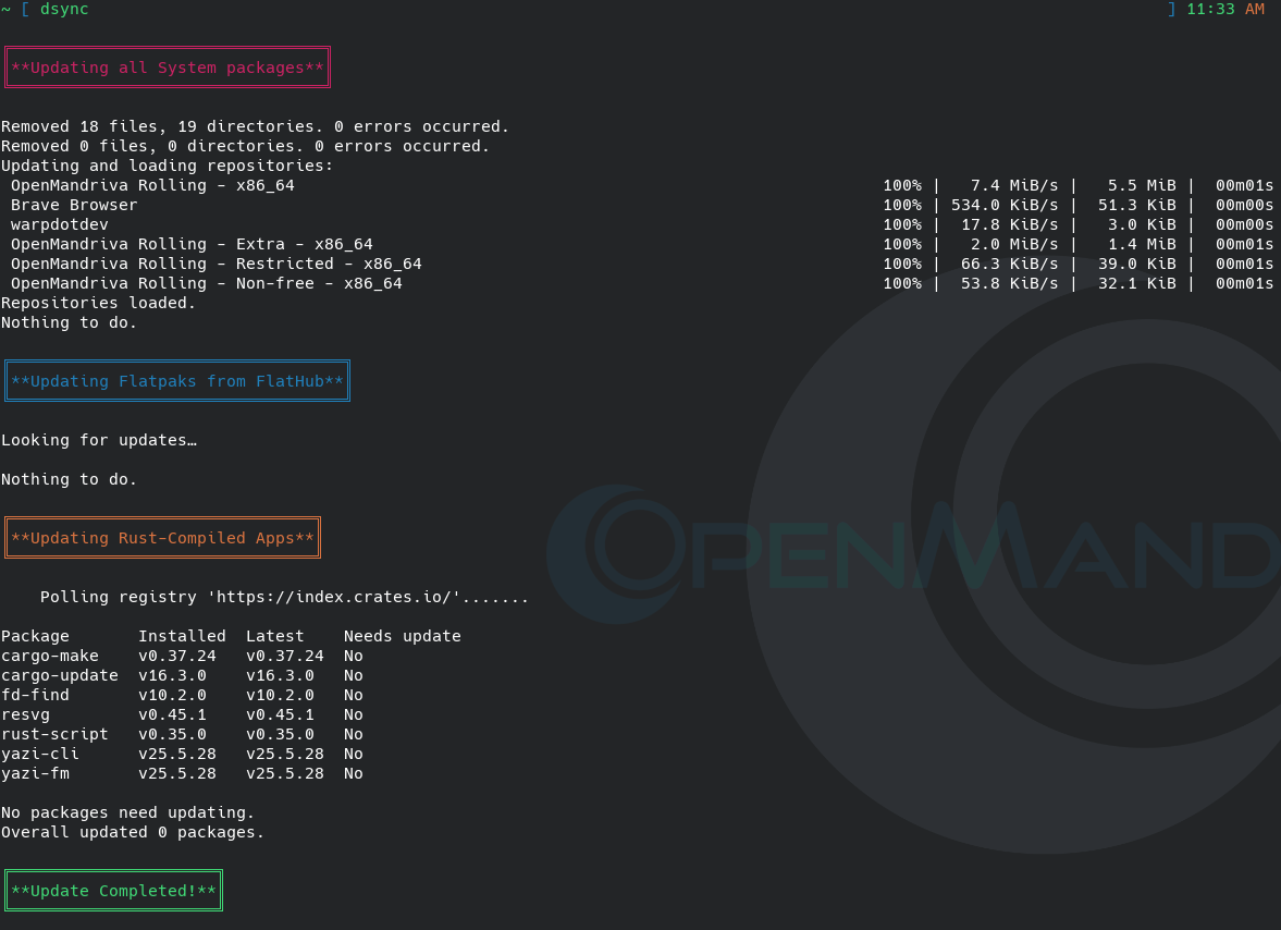

I’ve made a couple of modifications for mine. First, I compiled some apps using rust/cargo so I could get yazi (which means that once yazi is in the Rome repos, I can get rid of the rust stuff! :joy:). I added in the cargo-update command needed to keep those apps updated, and adjusted the colors so the β€œrust” stuff ended up being more of a β€œrusty” orange color :+1:
Next, I duplicated the script and changed the distro-sync command to β€œupgrade” for my computer that’s running Rock. So now I have a Rome-specific script, and a Rock-specific script.
