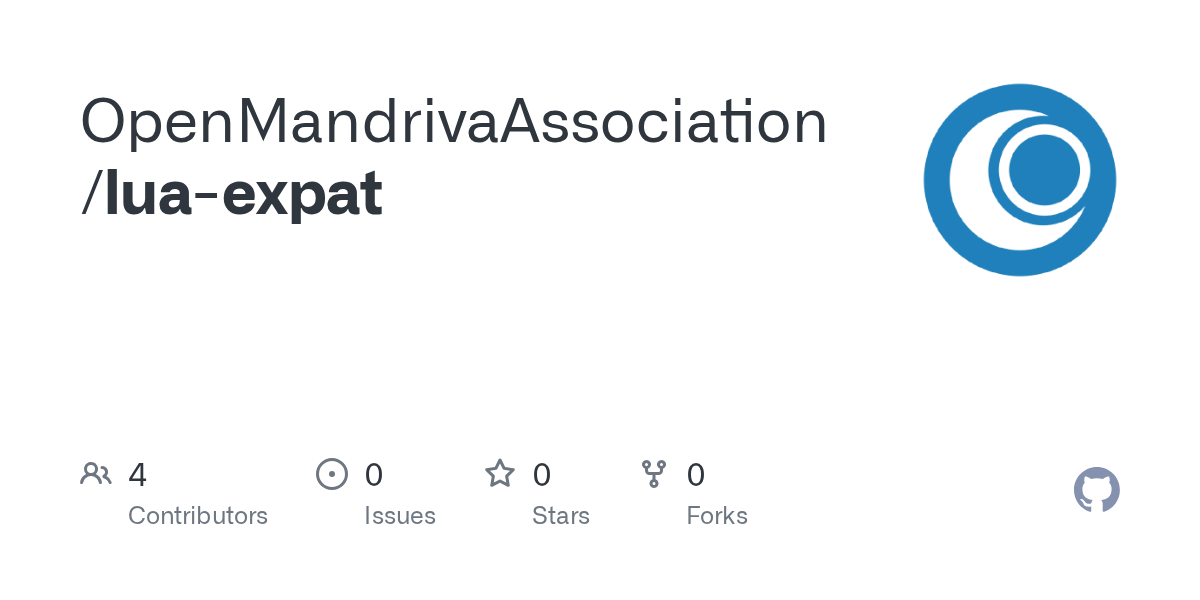

I have added more packages:
lua-cldr
lua-cosmo
lua-vstruct
lua-luautf8
lua-fluent
lua-epnf
lua-expat
Note: lua-expat is already in GitHub - OpenMandrivaAssociation/lua-expat but there are no builds for it in Cooker.
I would say, just clone the existing spec and work from there.

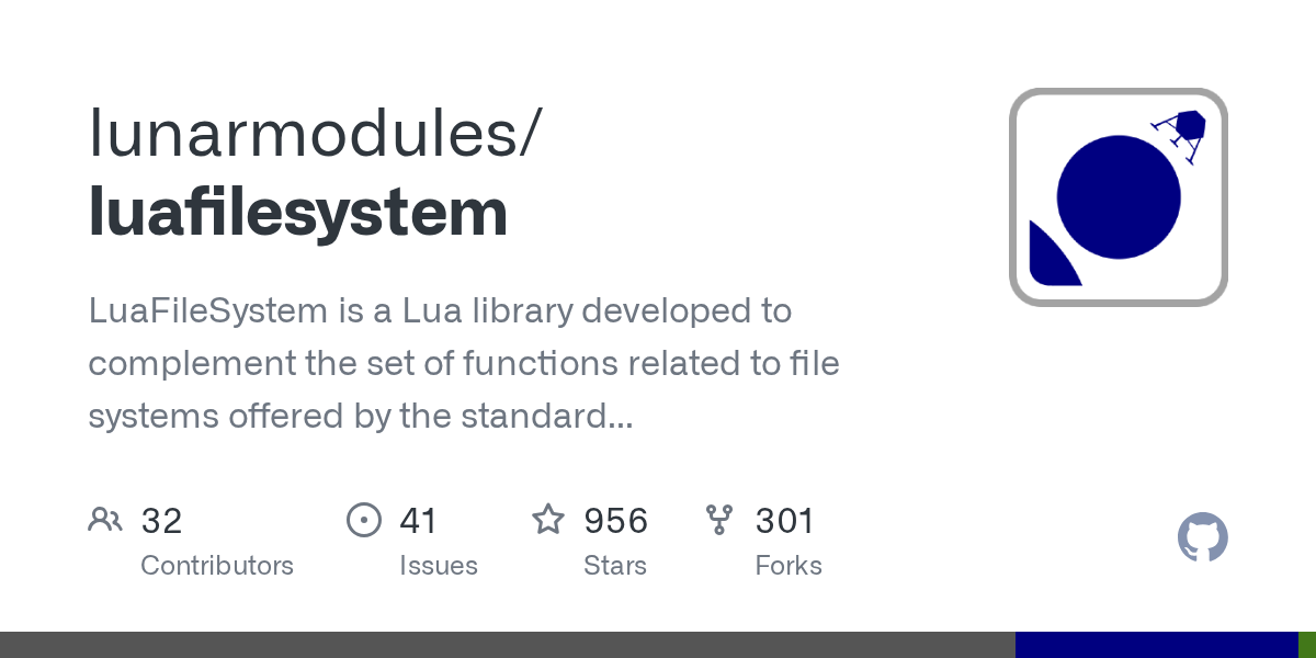

One dependency that is already in the default repo is lua-filesystem, but this one is only packed for Lua version 5.2
It appears that it has been a while since this was built:
https://abf.openmandriva.org/openmandriva/lua-filesystem/build_lists
There is also an updated repo and url if that is something you would like to tackle:
It seems like the version says 1.8.0, while the source is 1.6.2. Anyway I will give it a try to update it.
