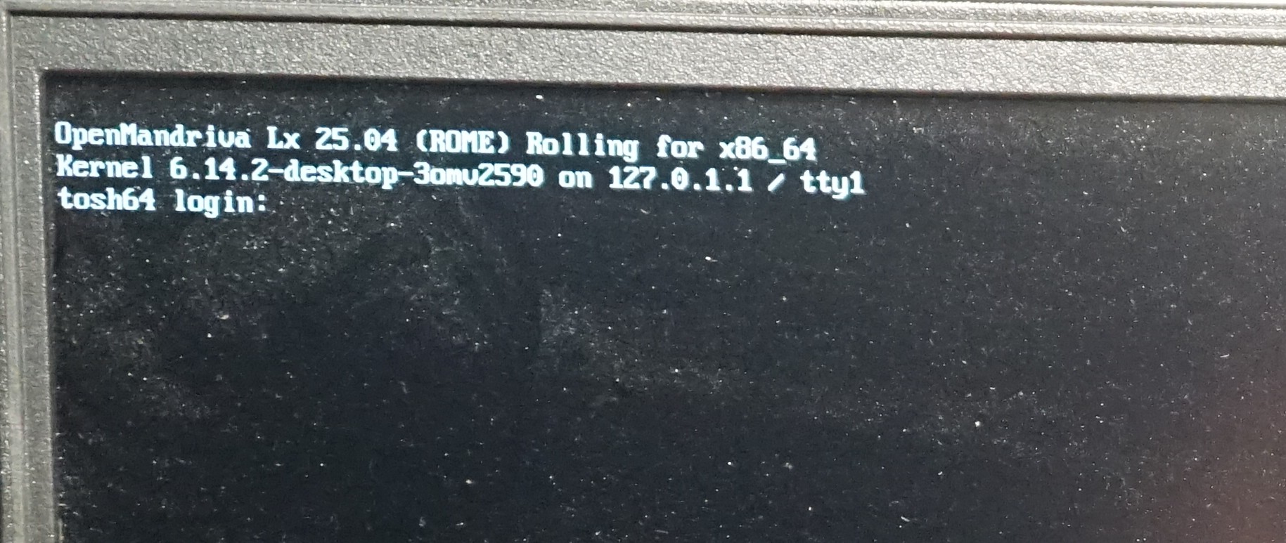

Since on my system graphical booting fails (9 out of 10), for some time now I have been booting the notebook with the “console mode” entry, at the prompt I perform authentication and then launch the graphical session with
“startx startplasma-x11” [or … startgnome, or … startplasma-wayland] And I access (… and work).
  1. Instead when I start with the default entry (and graphical login fails in a continuous loop), I have to change “tty” with Ctrl+Alt+Fx (x from 2 to 6); from the new console I authenticate then launch the graphical session with “startx startplasma-x11” etc. the graphical login window reappears and I have to authenticate again (wasn’t I already auenticate?).

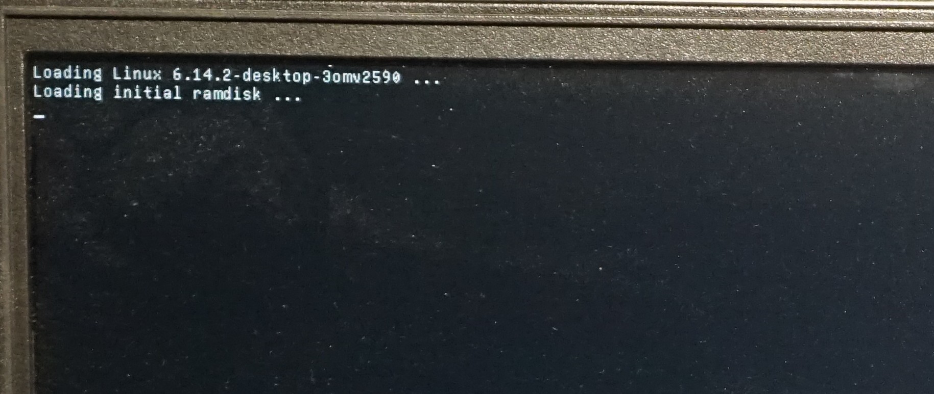

  2. why during boot (in “console mode”) does the “log” not appear on the screen? (maybe “plymouth.enable=0”?).

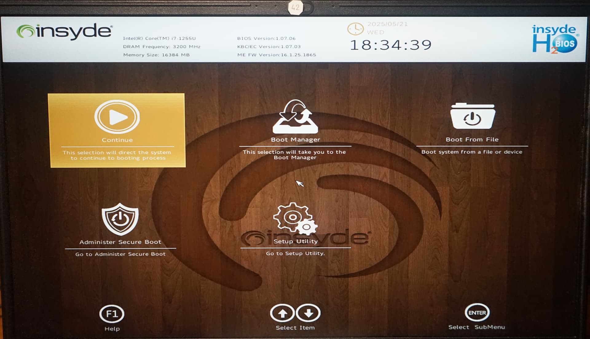

Is a machine purchased without operating system (to avoid windoze), it is difficult to trace back to the manufacturer (I guess it is an assembled one). I try to reboot and get information during the bios startup.

related to bios

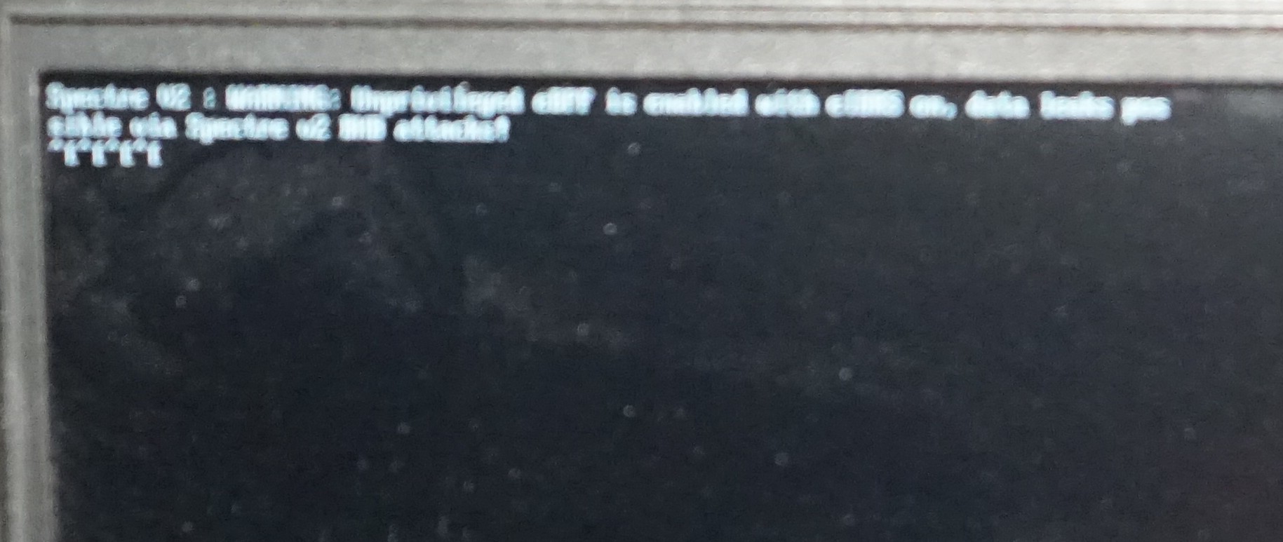

maybe the consistent dust has its importance? (boot4, after Esc the hand shook)
Insyde BIOS Updates
To update Insyde BIOS, you should visit the manufacturer’s official website, not Insyde Software’s website, as Insyde Software provides BIOS solutions to hardware makers who then configure them for specific models.
For example, if you have an HP laptop, you would go to HP’s support website, enter your laptop’s model number, and navigate to the Software and Drivers section to find the latest BIOS update.
If you encounter issues finding the BIOS update, it might be due to the manufacturer purging older software downloads after an arbitrary period of time.
In such cases, contacting the manufacturer’s support directly can help you locate the necessary files.
Here are some steps to update Insyde BIOS:
Confirm your current BIOS version by opening the System Information window in Windows (press Windows + R, type msinfo32, and press Enter).
Go to the manufacturer’s support website, enter your laptop’s model number, and navigate to the Software and Drivers section.
Download the latest BIOS update available for your laptop model.
Backup all important data before proceeding.
Ensure your laptop is connected to the power adapter during the update process.
Run the downloaded BIOS update file (usually an executable file with a .exe extension).
After the update is complete and the system restarts, confirm that the BIOS version has been updated to the latest version.
just done: nothing changes

One question remains: why in “console mode” does it not scroll the log on the screen?
Thanks to @zeroability @WilsonPhillips @sez11a @rugyada @ben79 for having the interest and to @ben also for “sudo dmidecode” (my unforgivable ignorance)
The TTY does not have a buffer, thus no scrolling back. One would that that after all these years, it could have been improved, but one would be wrong.
