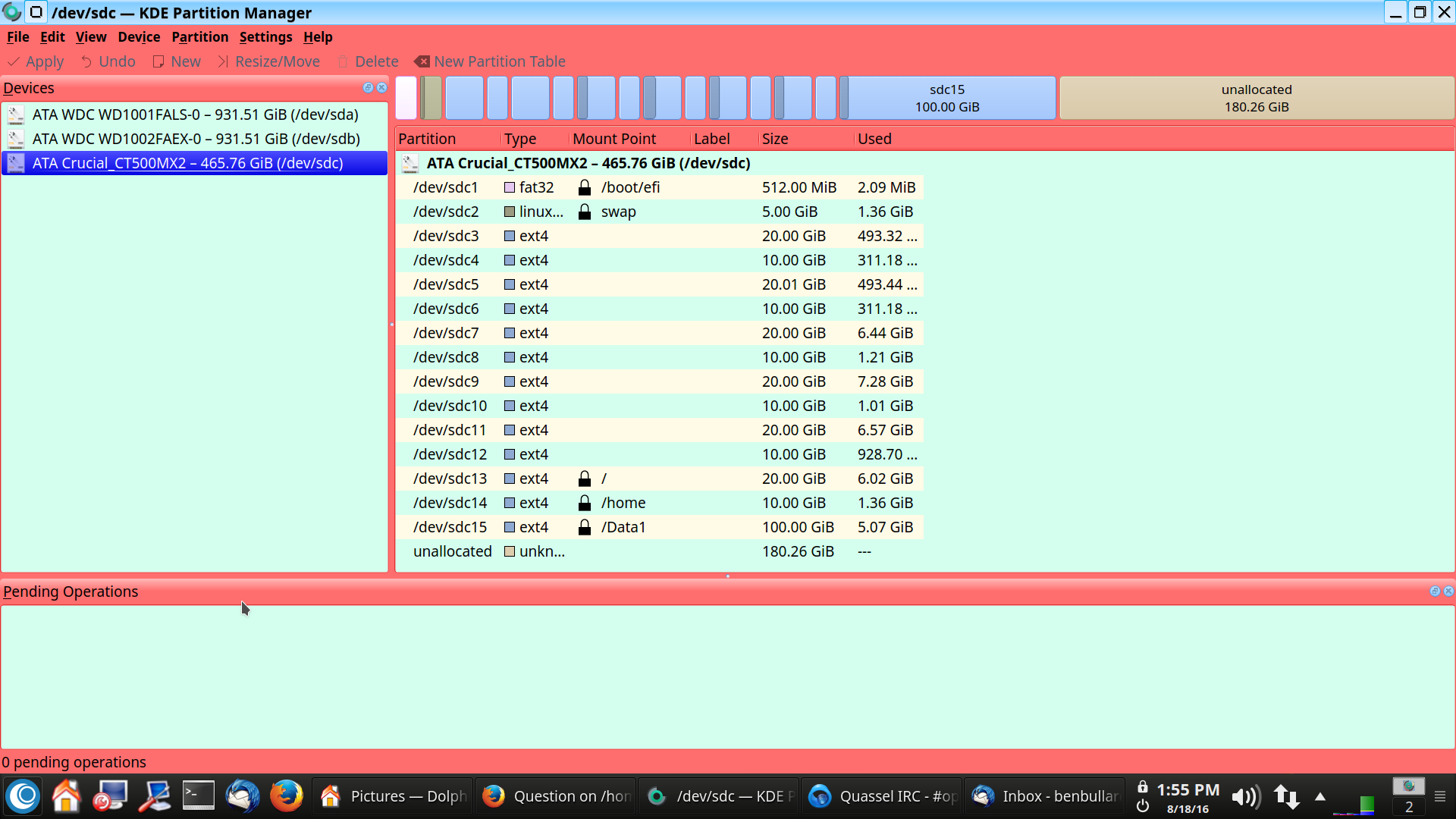

When I install I use ‘Manual Partitioning’ and select one partition to format and be root and select a different partition to not format and be /home. That simply adds your /home to /etc/fstab to be mounted when system boots. Screenshot showing current partition setup with separate / and /home partitions. This is super easy to do.
One can also add other partitions to be mounted, I add two I name /Data (on another HD) for storage and /Data1 on my SSD for VM’s in VirtualBox. Obviously you don’t ever format these. (They can be named anything one desires as long as it is preceded by the forward slash).

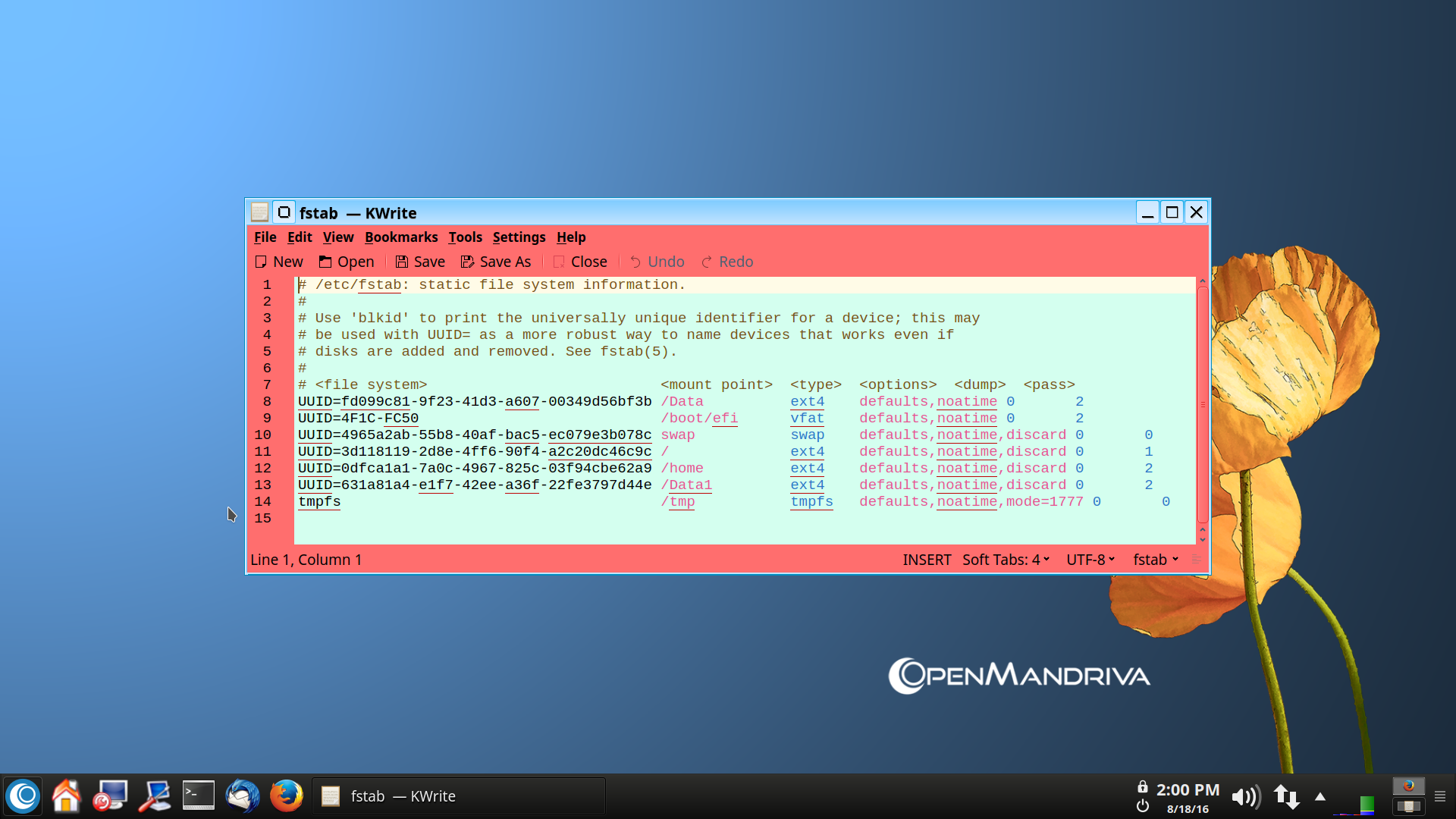

This is screenshot of /etc/fstab automatically created by ‘Manual Partitioning’ in Calamares installer.
One can see from seperate UUID’s that / and /home are on separate partitions.
