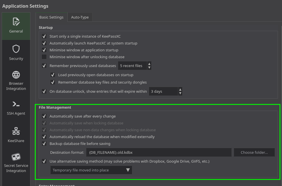

I have KeePassXC’s Basic Settings > File Management section configured in a way that makes a backup before saving any changes [as a basic safety precaution so that I can rollback to IF I ever need to which I have not had to resort to using thusfar, but its there for the day IF decides to arrive.].
I also have it set to Automatically reload the database when modified externally - IMO this is the crucial option to enable on all clients accessing the same database when you are sharing a database as it ensures the database is reloaded on each client when the database gets modified, this avoids the potential situation when clients are sharing a database when a client may overwrite an updated database file with old data because that client has not reloaded the modified file before making any changes.
I do not know if your KeePassXC compatible phone software has the option to Automatically reload the database when modified externally like the desktop client does as you never stated which software you are using on your phone, anyway if it does have such an option I would turn it on so that it mimics the desktop client behaviour in that way. :slightly_smiling_face:
