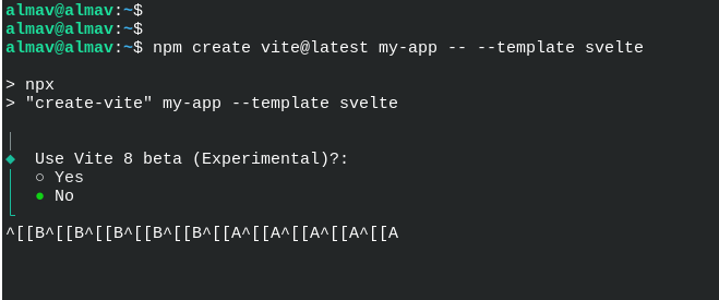

When executing any CLI command using nodejs (including simply node), the arrow keys and the enter Key print ANSI characters and newline instead of navigating and executing an action. This is a real issue for interactive node-based commands such as npx create …whatever… since one can literally not select any option.
Dowloading node from the official repo solves this problem - for example using curl -fsSL https://raw.githubusercontent.com/mklement0/n-install/stable/bin/n-install | bash -s 24
According to chatgpt (take it with grain of salt of course): “this is related to how node was built, packaged or interacting with your terminal”.
Further info:
process.stdin.isTTY gave true
$TERM was xterm-256color
ldd $(which node) did NOT mention libtinfo nor libncurses (according to chatgpt, it should - but the version that actually works does not mention these either so perhaps this point is not that relevant?).
Wrapping the command with rlwrap did not work. The arrow keys stopped to print the weird ANSI characters, but they also did nothing. And hitting Enter also had no effect.
ASUS laptop, node version 24
