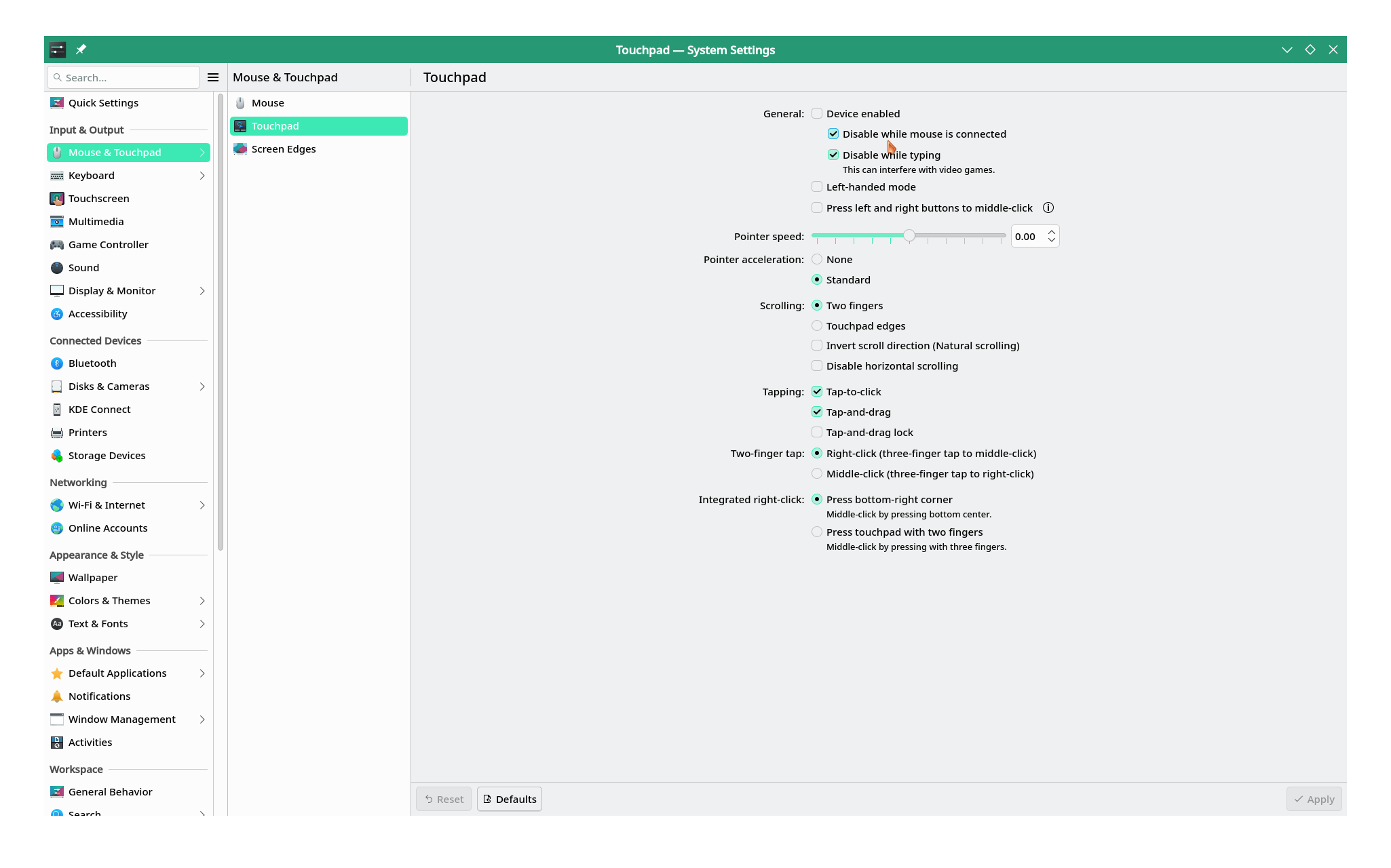

The solution that worked for me was to go to Settings > Mouse & Touchpad > Touchpad and enable the Disable touchpad when mouse is connected option. This allowed me to use only the external mouse, and all the issues went away.
I suspect the issue may be related to having multiple input devices active at the same time, as my Dell Latitude 5511 has an integrated touchpad and a “TrackPoint” style button in the center of the keyboard. When I disable the main touchpad and use only the TrackPoint and its buttons, everything works fine.
And to ensure that even when removing the external mouse, the same problem does not occur again, I disabled it:

Users should be able to do this in SystemSettings unless they are using a renegade desktop.
I do not know when the “Disable when mouse is connected” option was added in Plasma6 but I just discovered that it has been added now.
Yes, yes … it is possible to do this by SystemSettings. I ended up not putting a screen capture, because my system is in Portuguese. Thanks for the addition, @ben79 !
