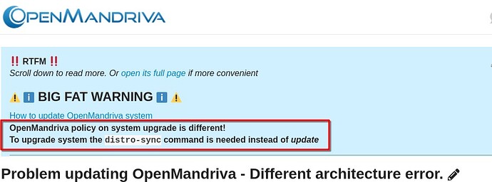

1)
2)
Type in console commands:
sudo dnf clean all ; dnf clean all ; dnf repolist
sudo dnf --refresh --allowerasing distro-sync 2>&1| tee dsync-log.txt
Type N (no) to abort the transaction and attach the dsync-log.txt file here.
@rugyada is correct. ROME is a rolling release and must be done differently. :grinning:
Any time you run into issues, don’t bite off more than you can chew. Come here and ask questions. OpenMandriva is a unique thing. It is not based on Debian or Fedora or SUSE and it is about as old as they are. So, it does things a bit differently.
