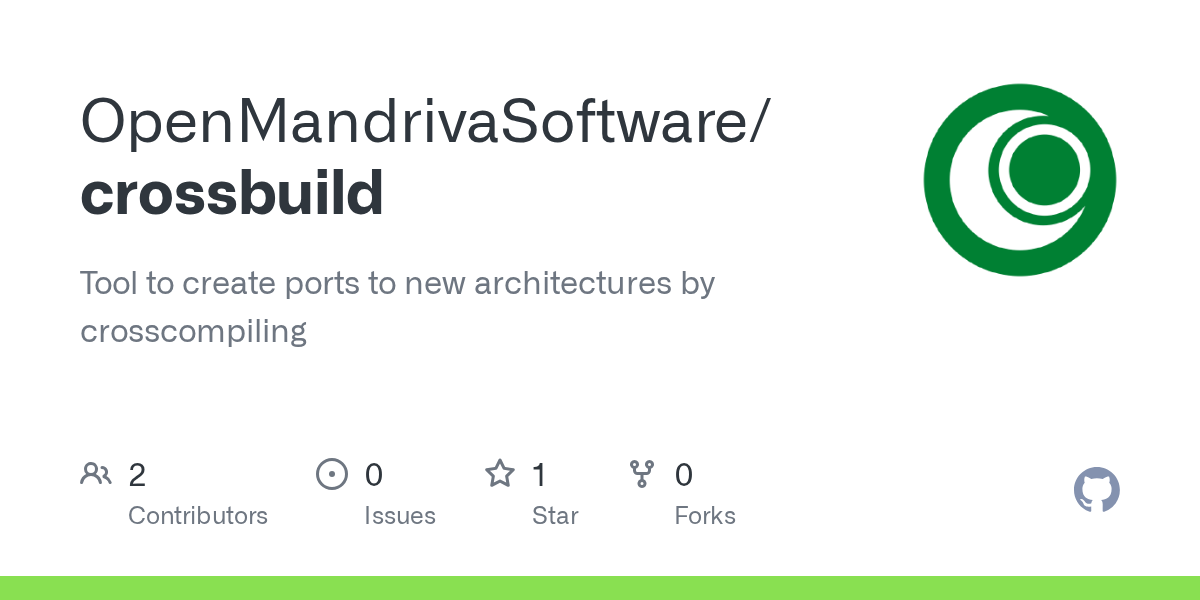

I don’t think there’s any guide, but we have a script that should do the most tricky parts almost automatically.
The idea there is to just run (on an existing OM system of an already supported architecture)
./create-omv-env.sh TARGET
where TARGET is the architecture you’d like to port to in rpm notation, so in your case, you want to run
./create-omv-env.sh ppc64le-linux
With any luck, that will create an initial set of packages with which you can create a chroot or a docker container in which you can compile the rest on the target system.
The script was working last year to create an initial RISC-V environment, but will probably need a few changes to adapt to things that have changed in cooker since.
