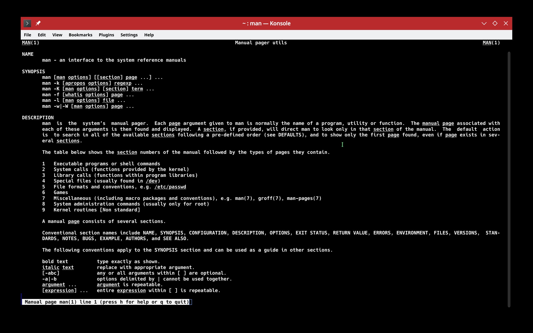

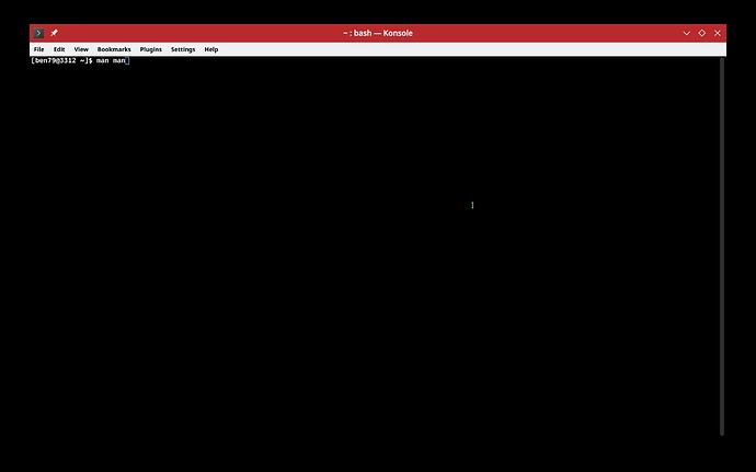

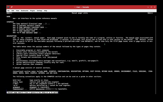

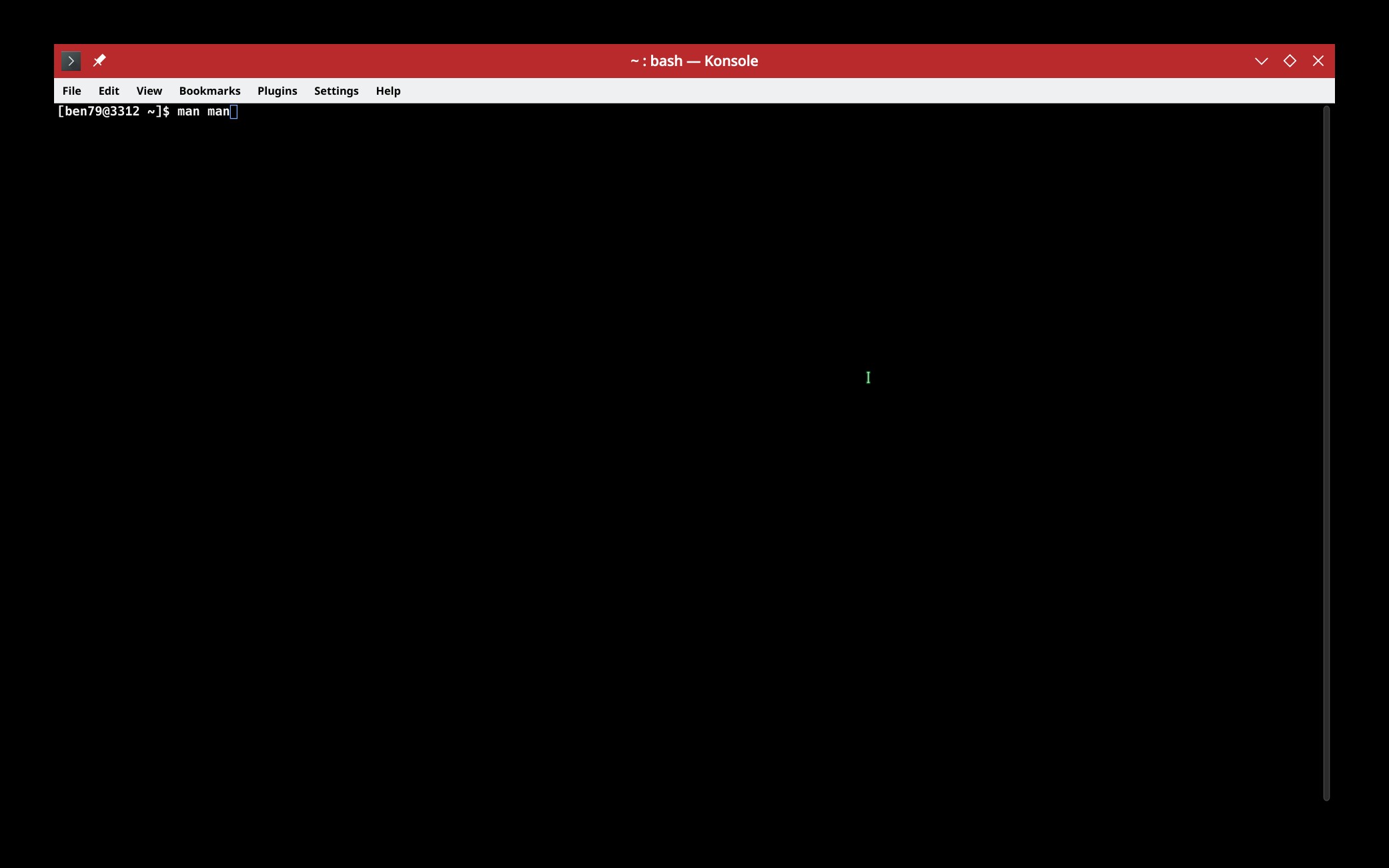

What to do?
export MAN_DISABLE_SECCOMP=1
man man
sudo dnf in groff man-pages-pl

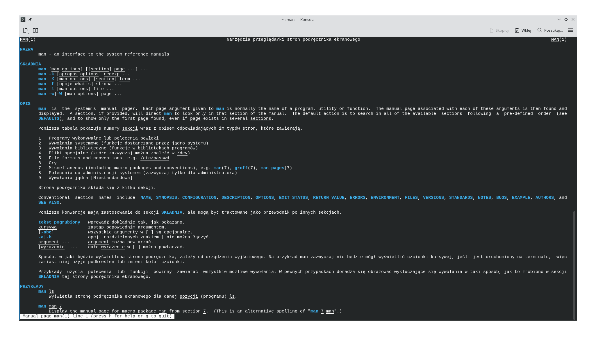

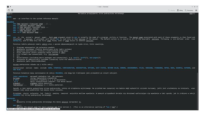

I got it. First problem is that I had to run sudo localectl set-locale LANG=pl_PL.UTF-8 instead of as user.
$ man man
Works and is in Polish. man dnf works and is in English, donāt understand that. man less and man more appear to be in Polish.
So thanks @FernPolskaOriginal for this workaround and thanks to the Arch Linux folks. FWIW I do use their docs a good bit, more than I use Fedora these days.
