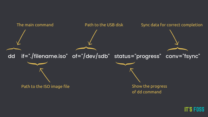

I just want to check, when dding, once the terminal prompt returns it means the dd process is finished and the USB can be removed yes?
This command is probably more helpful:
ok, so the conv=”fsync” will make sure it completes before reporting.
Why do the options in that have the “double quotes” around them where the one shown in here don’t?
I used dd without the quotes earlier and it worked.
I am a little confused?
Only necessary if there are spaces. As a normal practice, there shouldn’t be. I would just omit them.
np
