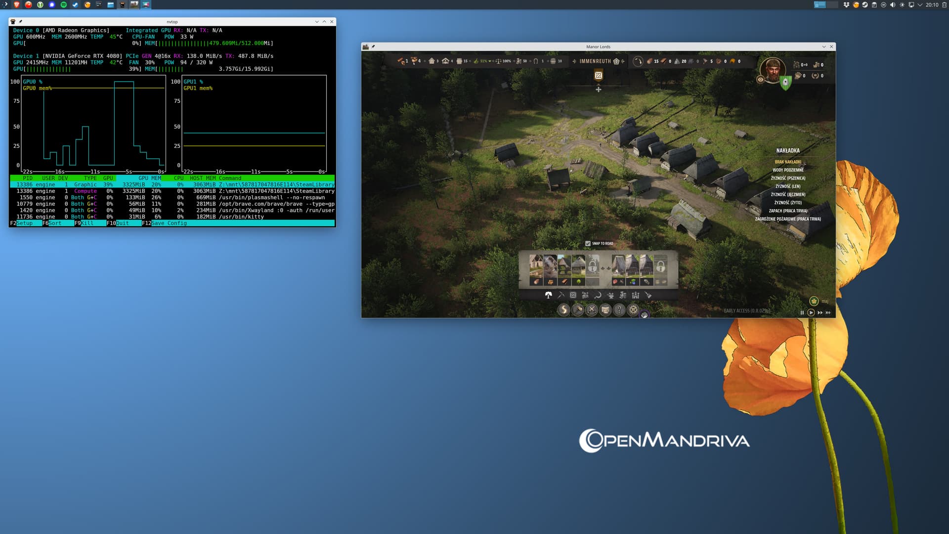

Wow, what a discovery I did when trying to fix that issue.
It seems that my motherboard (Asus X670E-Plus) or even AM5 platform itself can passthrough display from additional graphics card (GeForce RTX 4080) to Integrated AMD GPU. I have just connected display port cable directly to motherboard port, none display adapters are connected to GeForce itself. Now I can run OpenMandriva desktop using AMD iGPU - so Plasma6 is working without an issue on wayland, and when I run a game with steam or lutris, GeForce gpu is used for rendering, game works great but screen is still connected to Motherboard DisplayPort.
Amazing!
I wasn’t aware that something like that is possible. Now I need to check if it will work the other way - so monitor connected to GeForce, but rendering done by integrated GPU.
So it is a workaround for this issue in this topic, but I still want to find out how to fix that nvidia+wayland cooperation, so not closing it.
have you something like mangohud to confirm that point ?
you will see then memoty GPU in this case
I have nvtop running in a terminal and can monitor which gpu is occupied - and it confirms that!
It even works in window display
