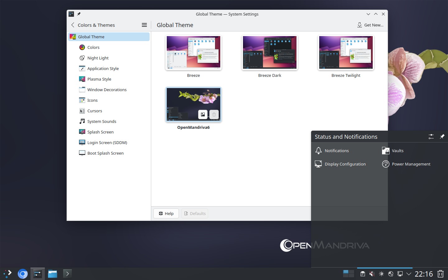

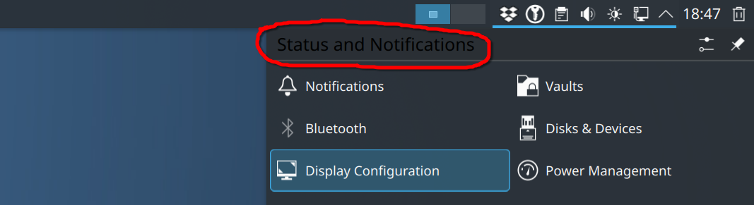

    Please help me with solving this, I don’t know exaclty when and why this has changed on my desktop, but it is very annoying:
Somehow even on dark breeze plasma theme those headers’ fonts are black, but should be white.
Switching themes, reset to defaults in plasma configuration tool doesn’t help.
Maybe leftovers from a custom theme.

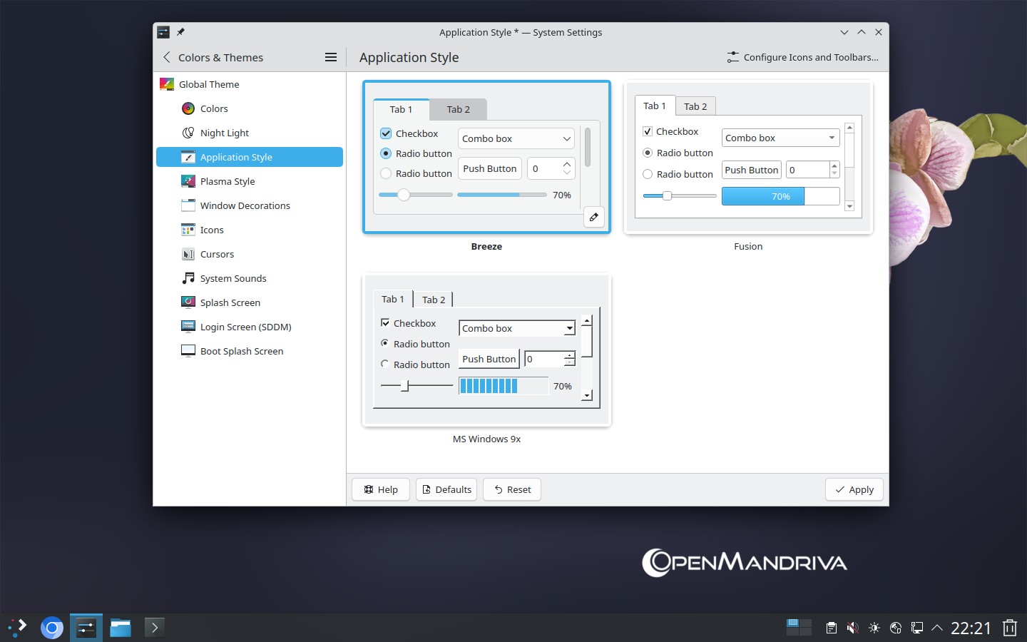

Plasma cache also is often a factor. Try:
in console
rm -rf ~/.cache/plasma*
close console, start krunner and type
plasmashell --replace
