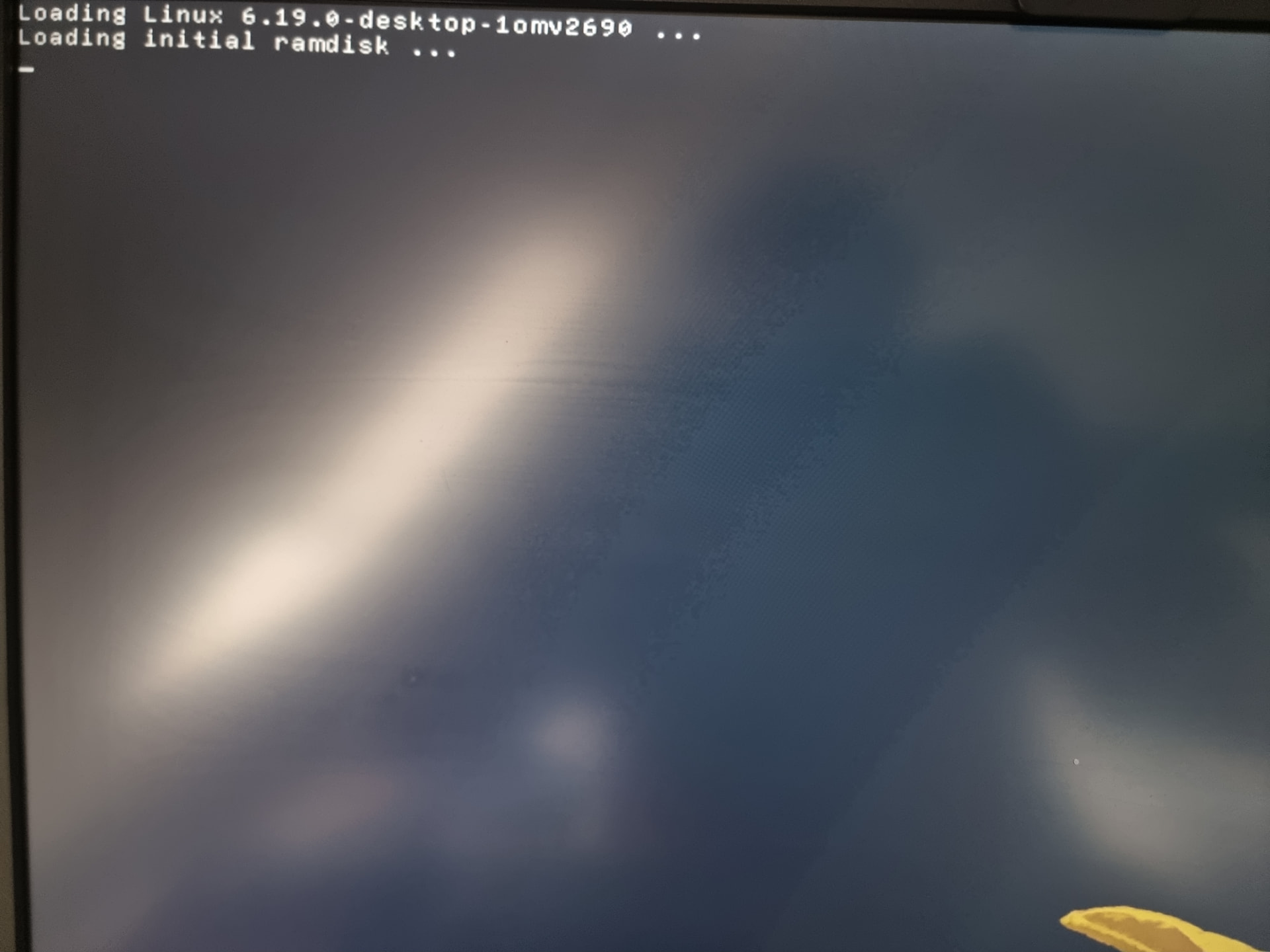

I replaced my existing videocard nvidia 1650 with 5060ti and now the OS won’t start, it hangs with “Loading initial ramdisk …”. See the attached screenshot.

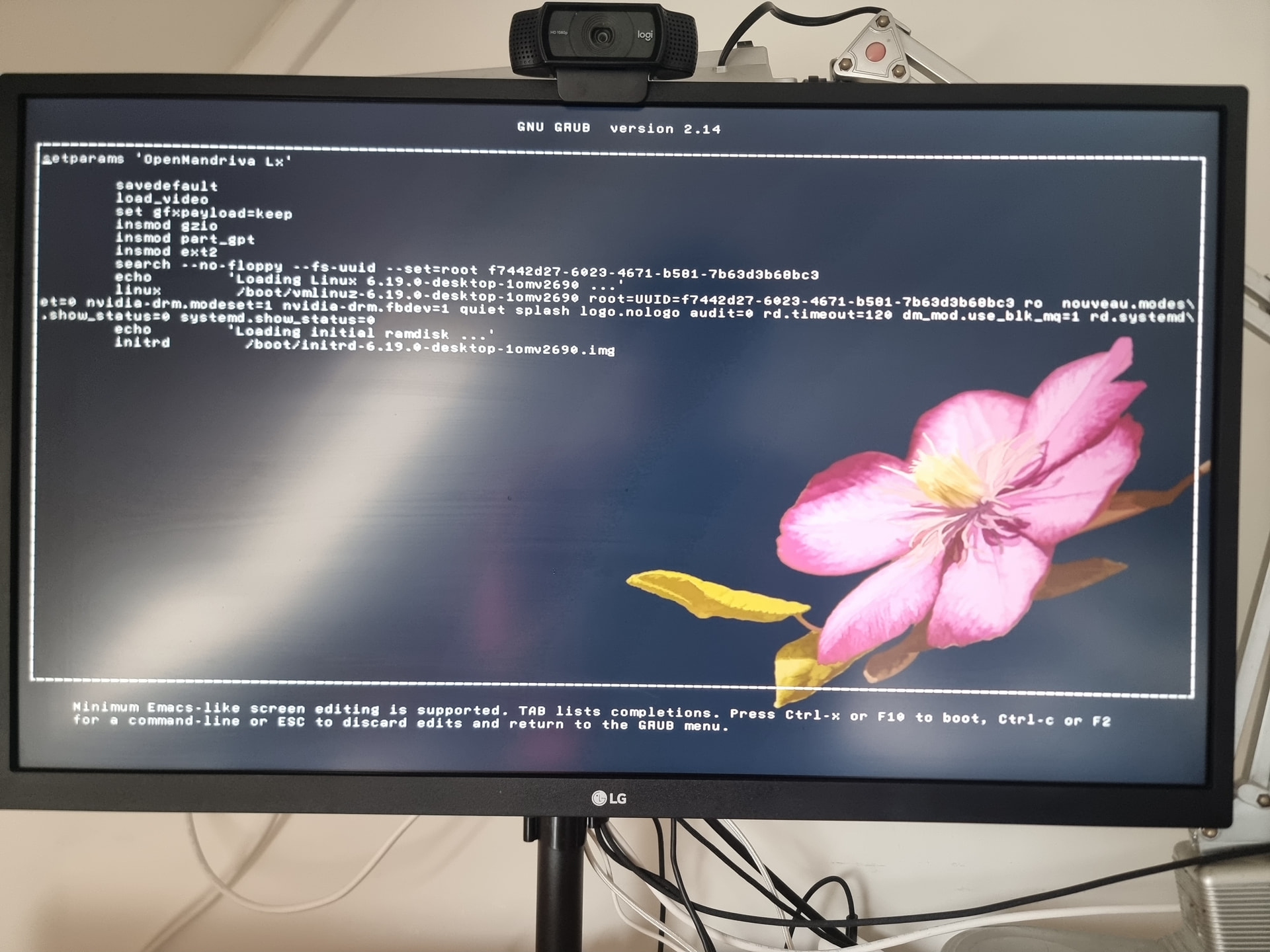

This is how my startup command looks like:
I tried selecting different boot options but they all produce the same result.
Update:
  1. I plugged in the old graphics card
  2. booted
  3. uninstalled nvidia driver with “dnf remove”.
  4. Plugged in the new card
  5. The system booted but only after using display port cable, not hdmi
  6. I installed nvidia driver again from the welcome app
  7. I restarted and now system doesnt boot anymore the same way as in the beginning

We may guess from the screenshot you are using ROME but please try to provide as much informations as possible.
