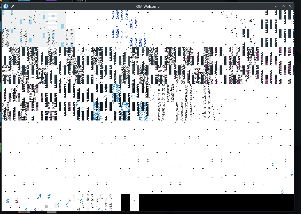

Screenshot of welcome screen?
My welcome screen. It looks same on actual installed system and live iso
@LeeTalbert You’re right I should have add this :slight_smile:

This may have something to do with your problems? I would disable one and try that and if that works OK if not try the other. No, I do not know how to do this, I would guess you do this in the computer firmware/BIOS. I do not have dual graphics, never have.
Device-2: AMD Cezanne [Radeon Vega Series / Radeon Mobile Series]
driver: amdgpu v: kernel
It is set as secondary in uefi so it is probably not that. When it is set as secondary, it is turned off till needed.
I will check tomorrow in VM how this welcome screen looks. I will use exact same iso I have used during install on my PC
I don’t know. This is something you would expect to see with nVidia not AMD graphics.
Exactly. Anyway I will investigate this further I let you all know of any findings or workarounds
@grafi, a possibility, I would consider a corrupted download or corrupted copy to install media such as a usb flash drive as possible causes. If this is specific to OM-Welcome and other apps work OK under your graphics this could be some missing file or something missing with in a file. As a tester I do a lot of downloading and cp to flash drive and it does not happen often but it does happen occasionally.
I checked downloaded iso against checksum, but maybe something goes wrong during the iso transfer to a flash drive. I will definitely investigate that. But… i must add that the om welcome screen issue was present on few different iso images that I downloaded and used.
I will certainly try to manually turn off my AMD Cezanne [Radeon Vega Series / Radeon Mobile Series]
I made preparation for that yesterday, but I prefer to use that option as last resort.
Both cards are managed by same driver ** amdgpu** so one mestake and I have more troubleshooting on my shoulders then it is worth it.
This glich is not a big deal at all. Anyways, I will back up my configs and disable my Radeon Vega.
As for now i removed om-welcome from the system i will reinstall it after reboot and start from there.

I think my hardware is a problem, but it is just a wild guess for now
