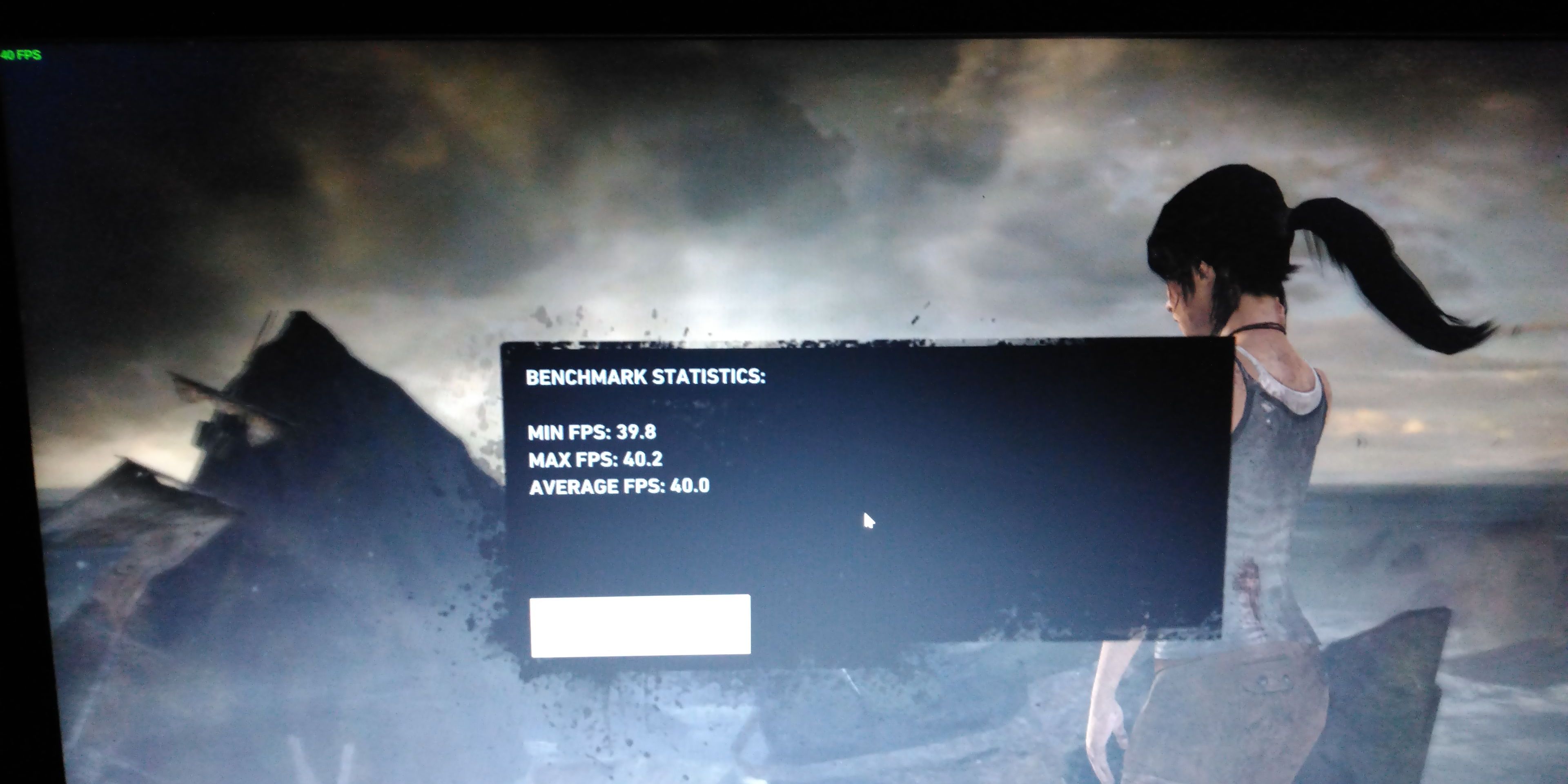

I’ve tested the opensource driver on a freshly installed system (up to date), inside one dedicated 100Gb partition.
System : OpenMandriva ROME 25.01, Plasma 6
Hardware : Geforce GTX 1650 mobile / Max-Q (laptop HP Pavilion Gaming - 15-ec0014nf)
Driver : fresh install “sudo dnf in nvidia nvidia-kmod-open-desktop”
Reboot after driver’s installation performed like a charm, no problems at all, I installed steam and Tomb Raider right away (compatibility mode) and i ran the benchmark and I got decent fps.
