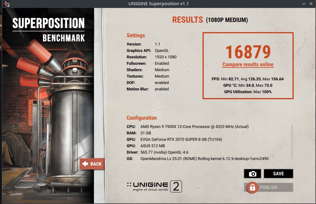

I uninstalled the module and benchmarked it with Superposition default settings.

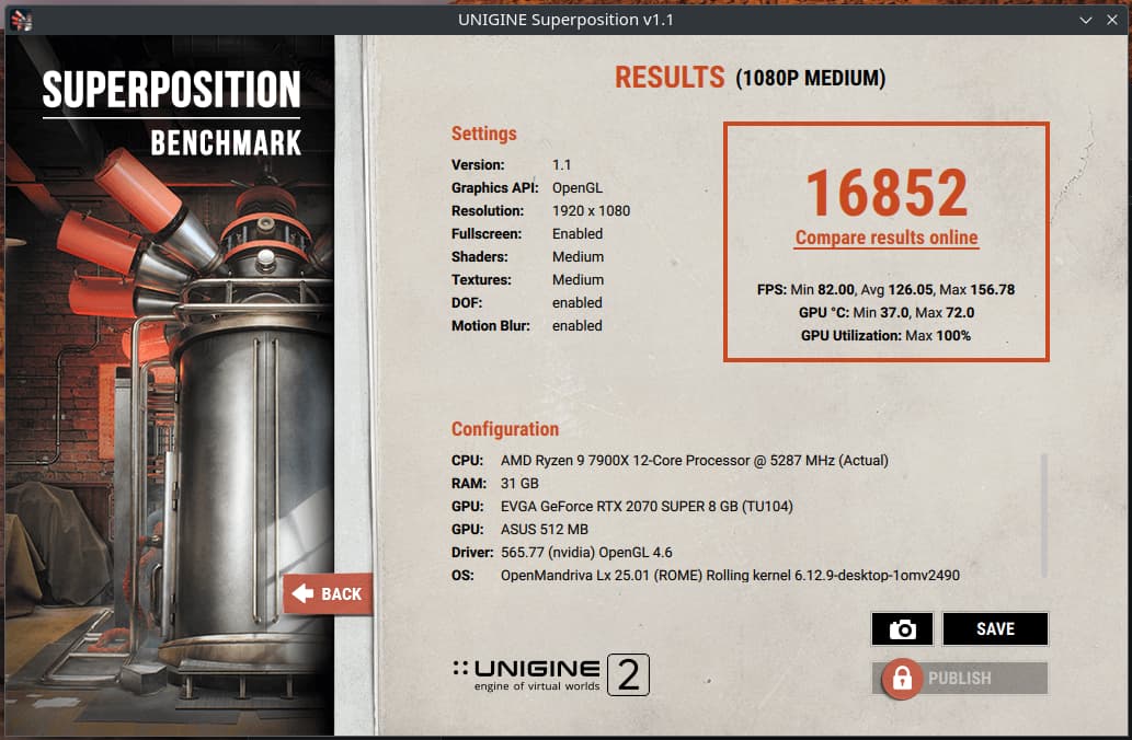

I installed the module and ran the test again. I didn’t allow it long to cool down, but that doesn’t seem to matter. It is a little bit slower, but it is not enough to feel in use.
I would say those differences are negligible.
