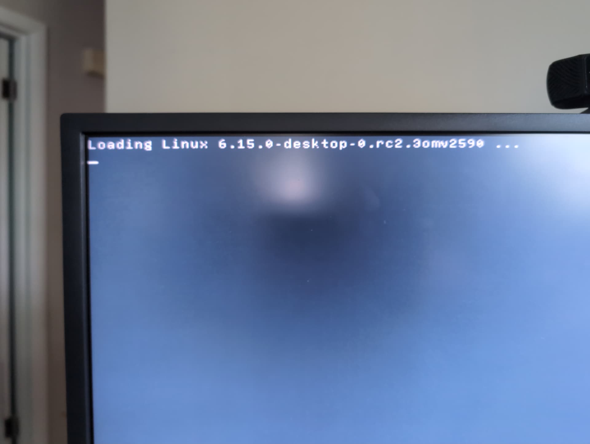

When I install a newer kernel and attempt to boot from it, it gets stuck at the kernel loading screen. I then press the power button, and it almost instantly restarts.

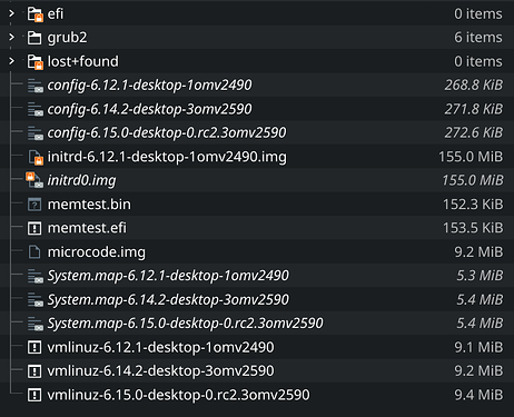

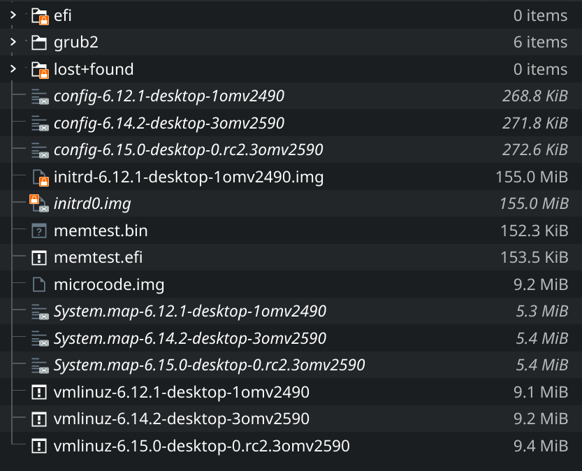

And this is my boot directory
Doesn’t look like they’re there…
I wish I had that kernel saved. That was the latest LTS kernel. You can mark it as manually installed and it won’t get removed automatically.

You only have initrd .img for kernel-6.12.1-1 so that is the only one that can boot. You do want to sudo dnf mark install kernel-desktop-6.12.1-1 as @WilsonPhillips suggests to keep that kernel until we resolve this issue.

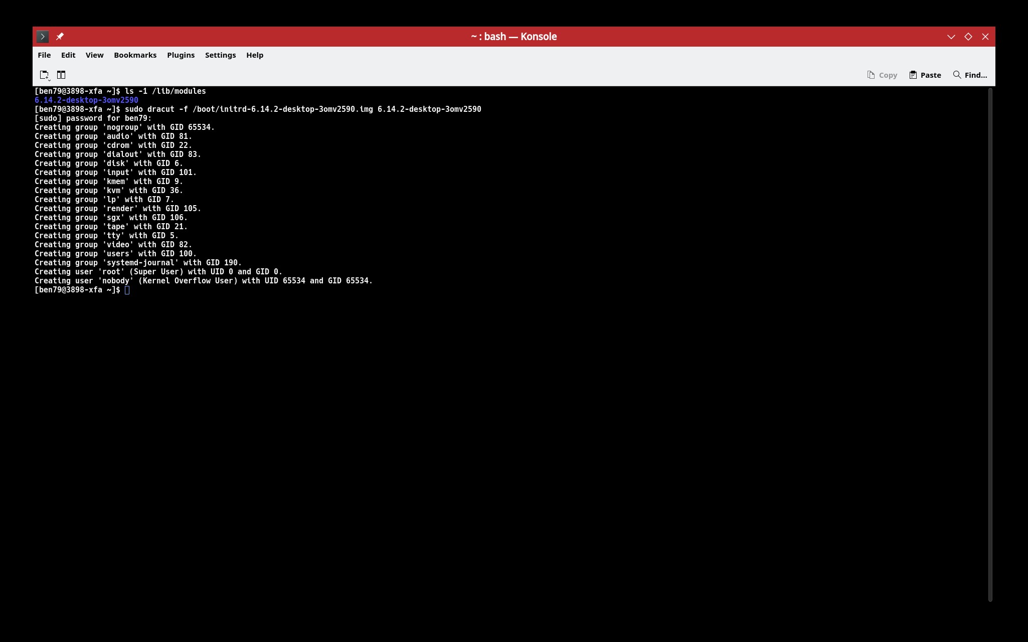

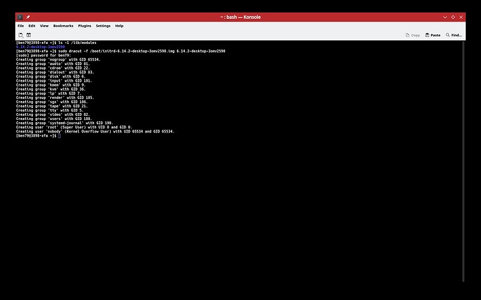

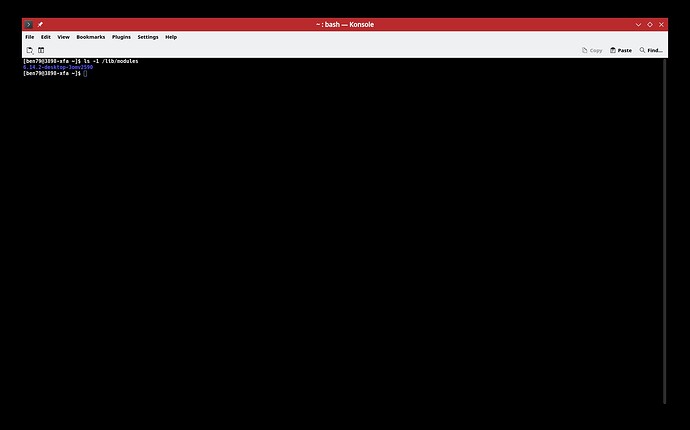

To build initrd .img’s for the other kernels you do:

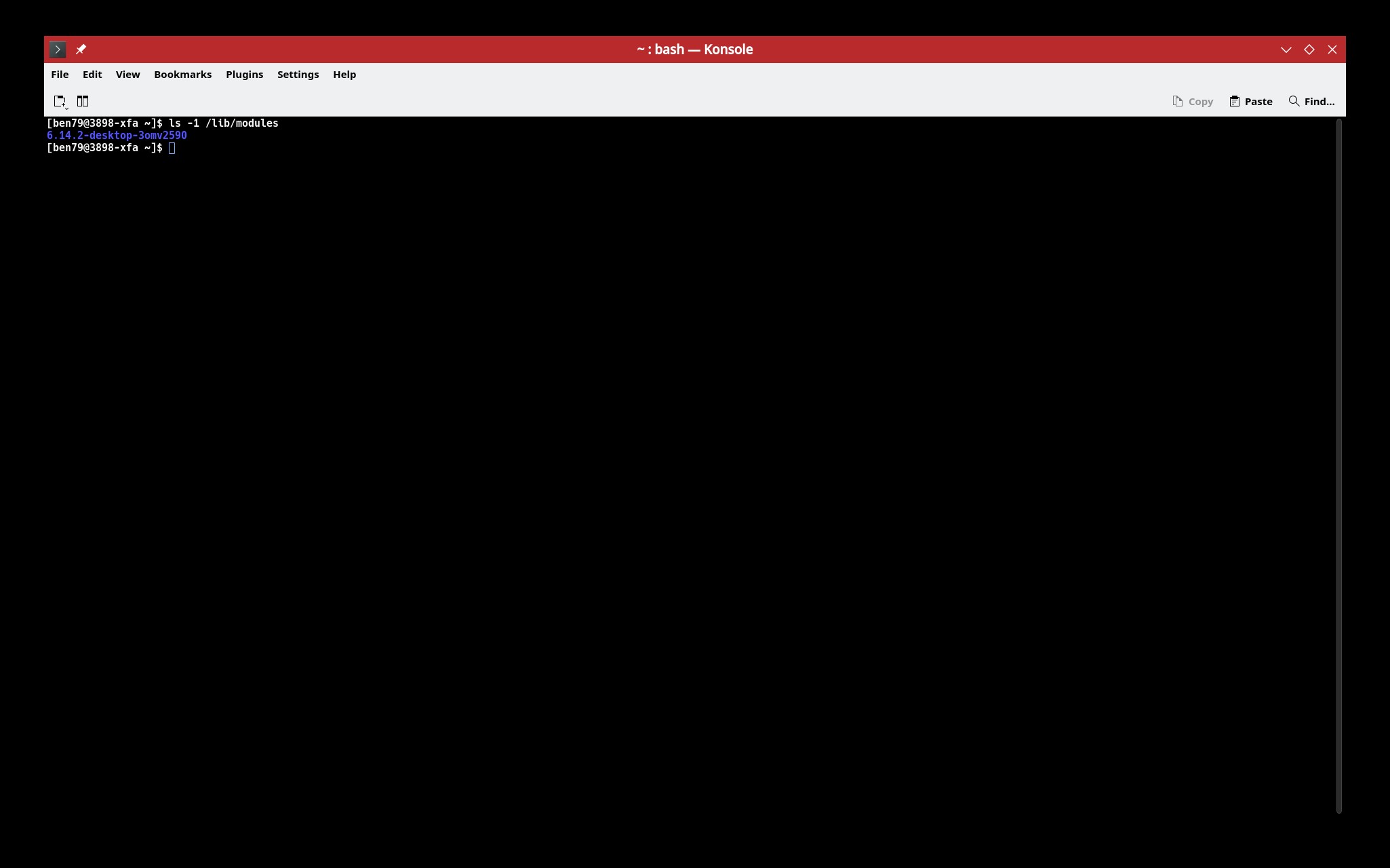

ls -1 /lib/modules
Then you copy and paste the module directory from there for each kernel, one at the time and use dracut to build the initrd like this:
dracut -f /boot/initrd-$version.img $version
where $version is taken exactly from one of the folders listed in ls -1 /lib/modules. So for example:
sudo dracut -f /boot/initrd-6.14.2-desktop-3omv2590.img 6.14.2-desktop-3omv2590

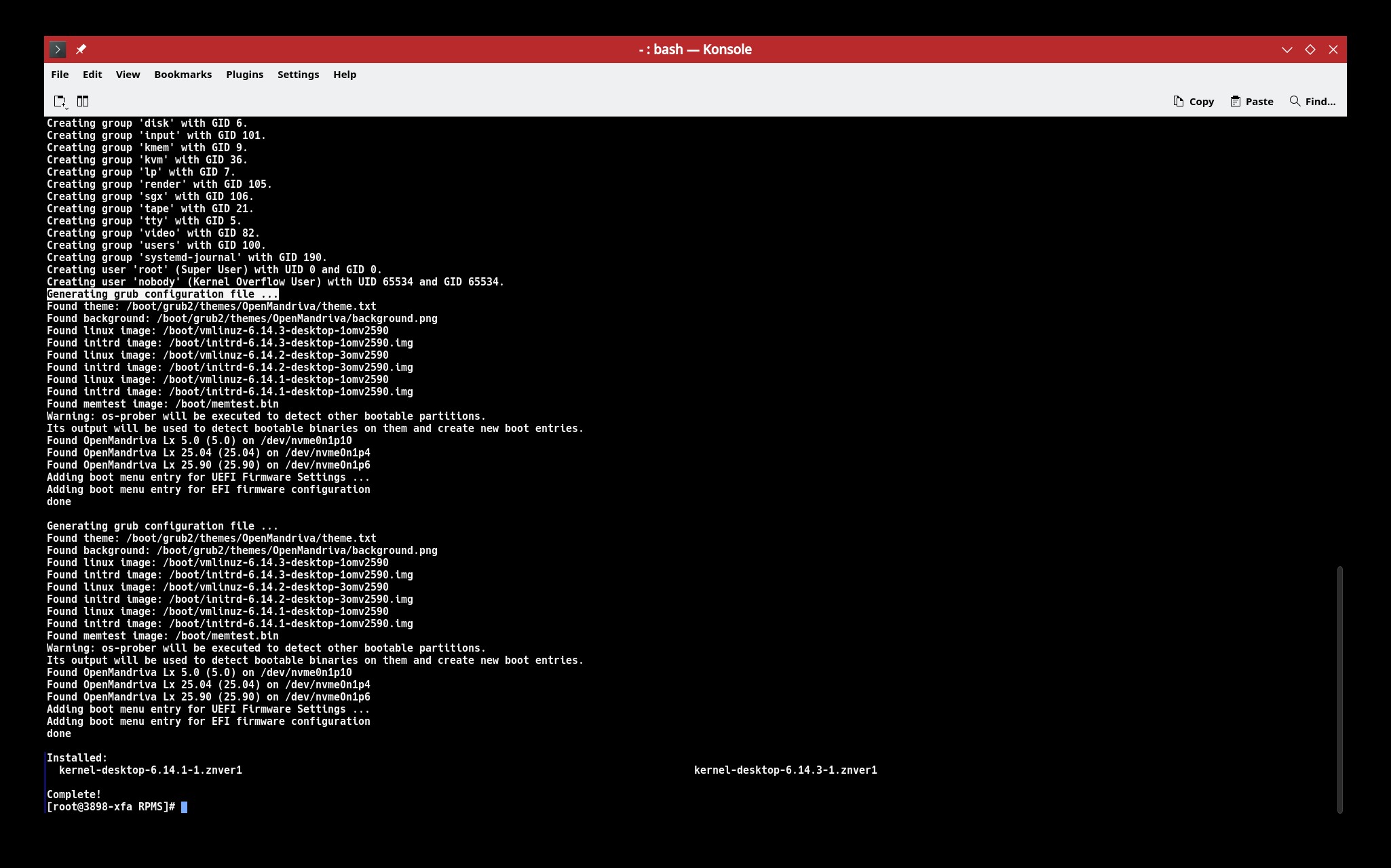

Which if all goes well would look like this:
You have that same kernel so you should be able to just cp and paste that command for that kernel.
All the Creating group * stuff should be ignored, that is output that should not be there. This is confirmed with OM devs.

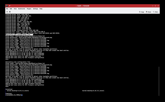

Note for all users if you do your package management from cli you can see if a new kernel install actually builds an initrd .img in the grub2 scriptlet that will run after the install. It will be under this line Generating grub configuration file ... like this where I just installed 2 kernels on the system used in the example post above, you will see Generating grub configuration file ... run twice in this screen-shot:
So now I have 3 kernels available in my new Rock/6.0 system.

After resizing the partitions with another tool (turned out that my boot partition was too small to house the img files), wasting my life away trying to fix it not booting at all, chrooting into the main partition, and running all the necessary commands, everything works now! Thanks a million!
