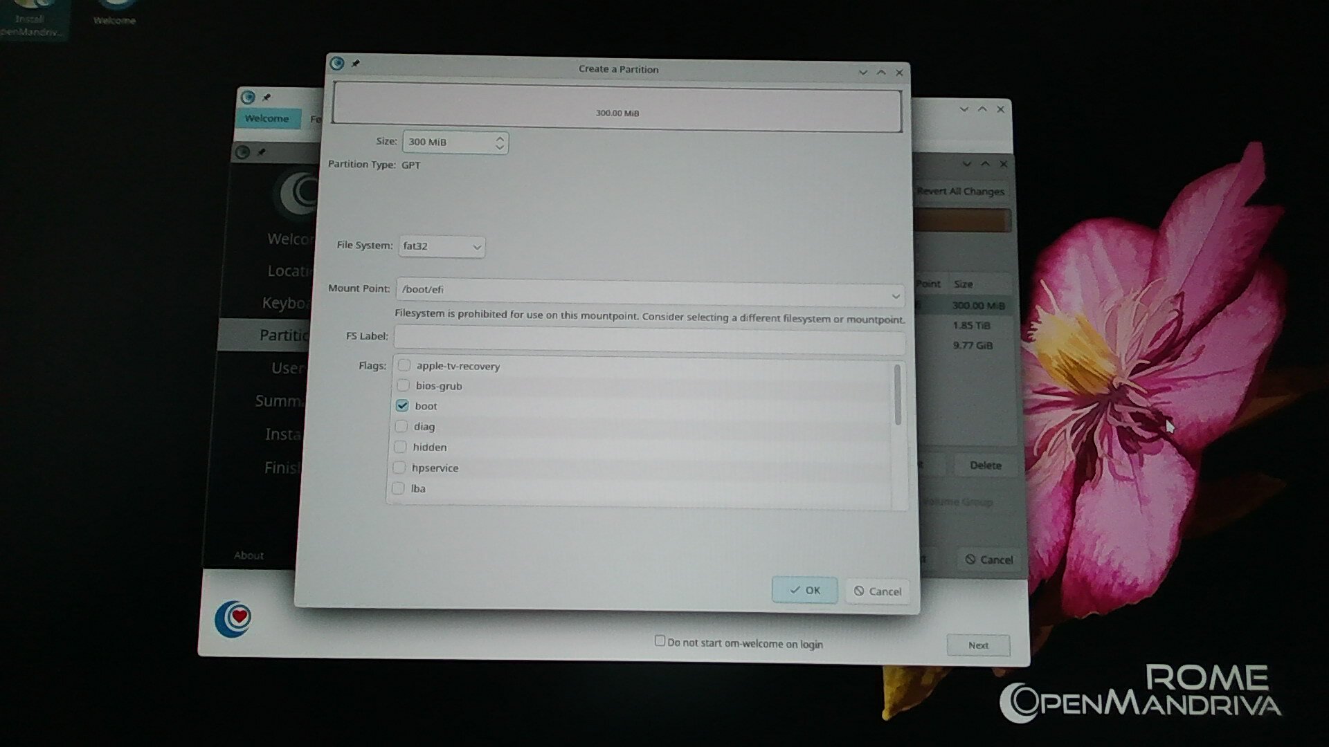

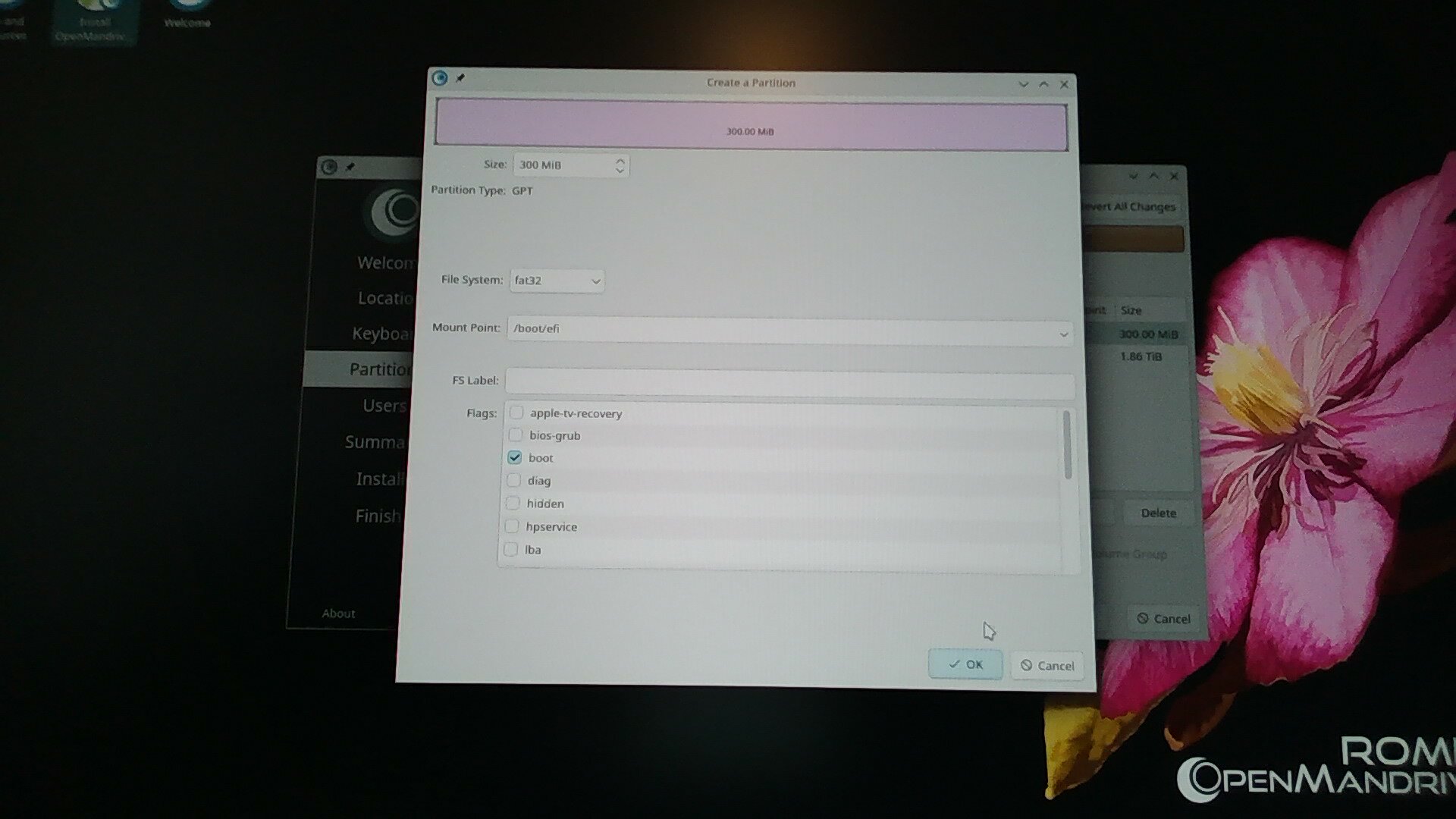

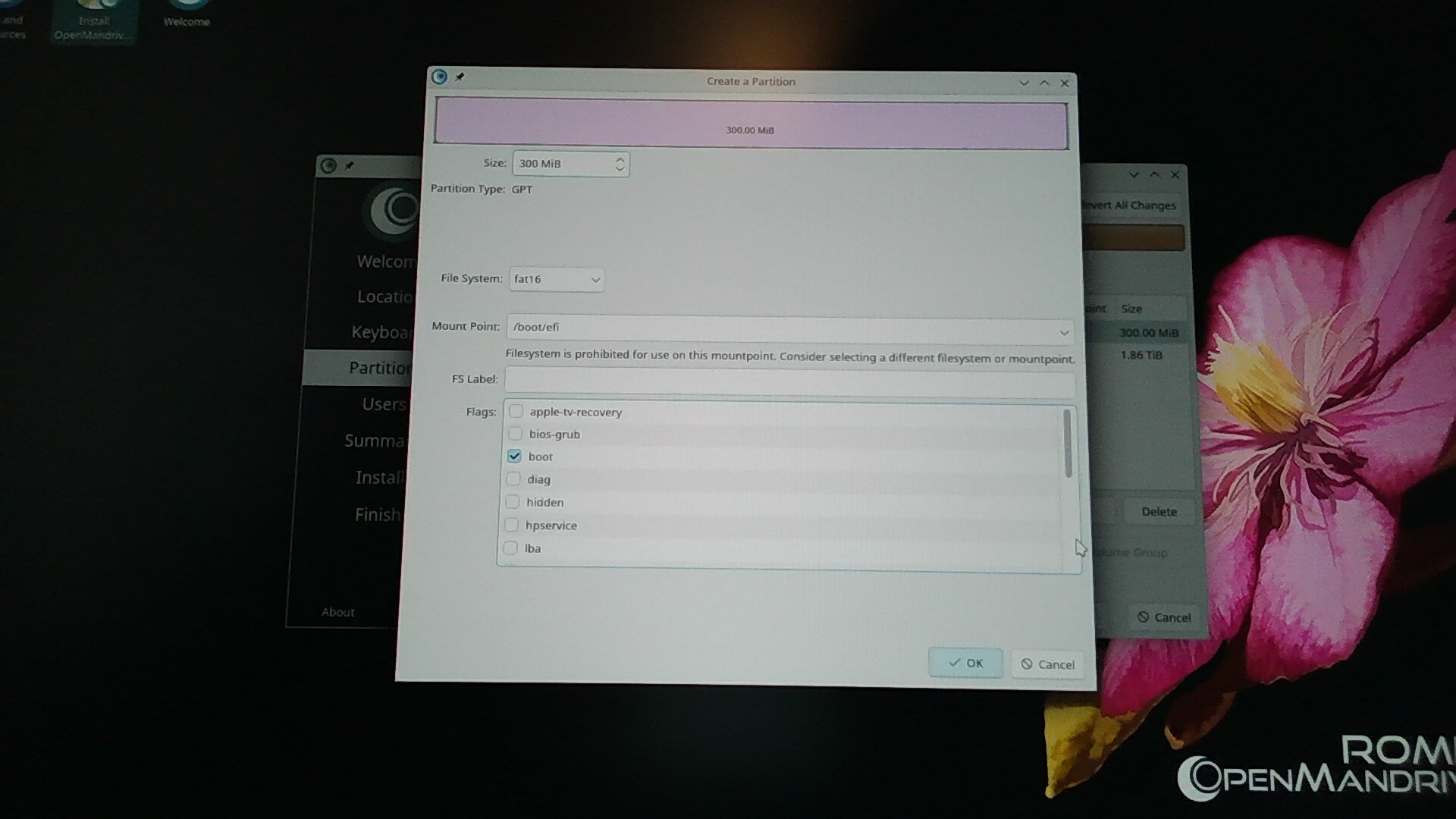

I have just done a few more install tests but only up to the partitioning.
I think I might have found the source of the problem.
Summary
Installing using build 4292

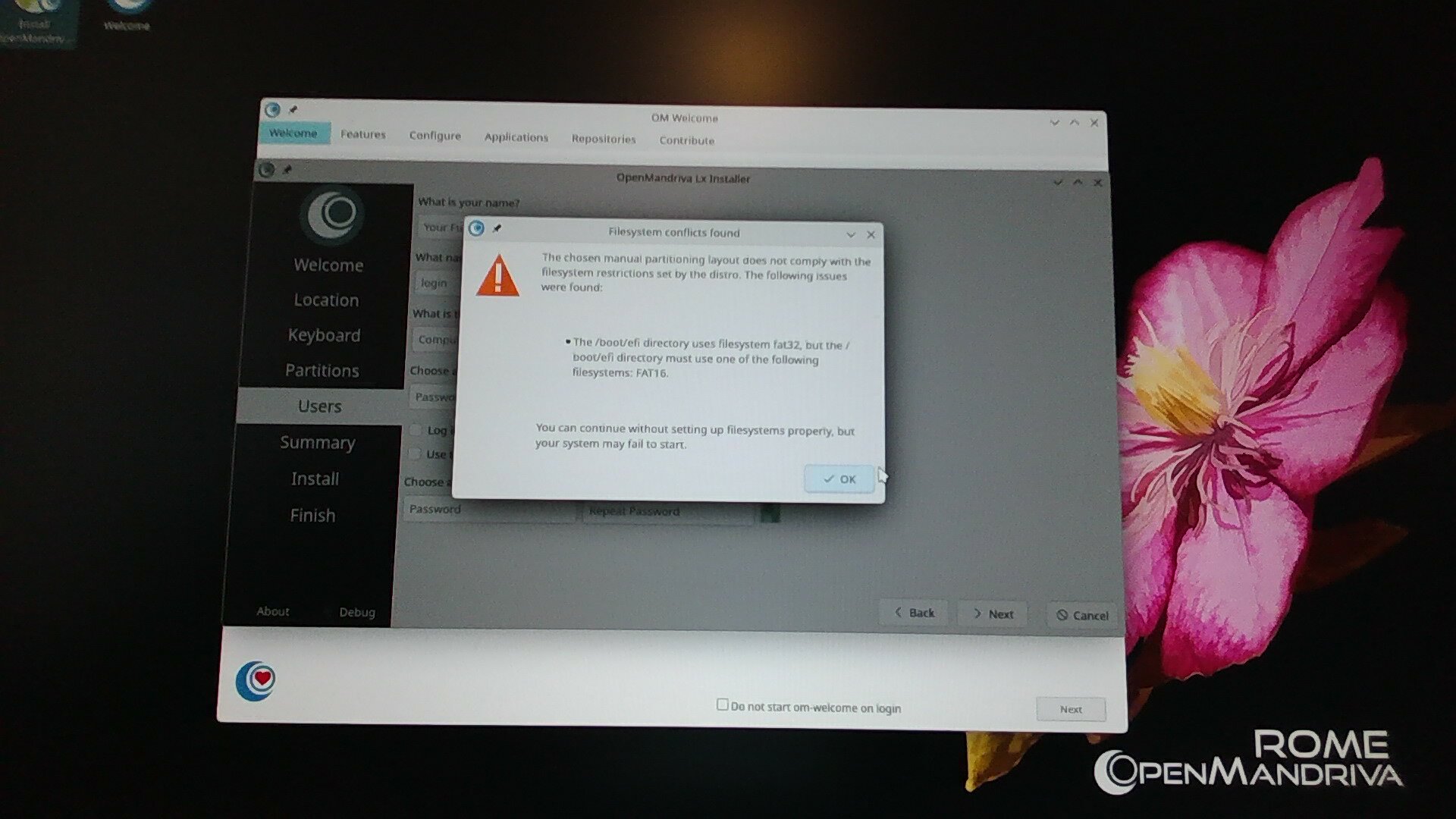

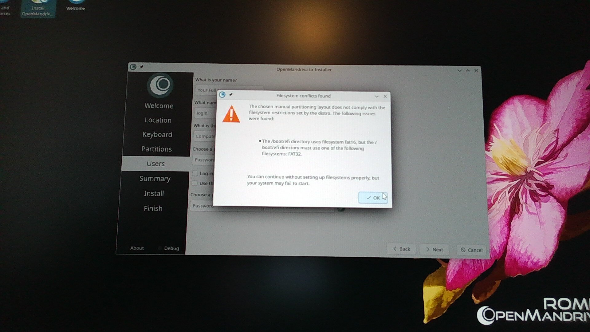

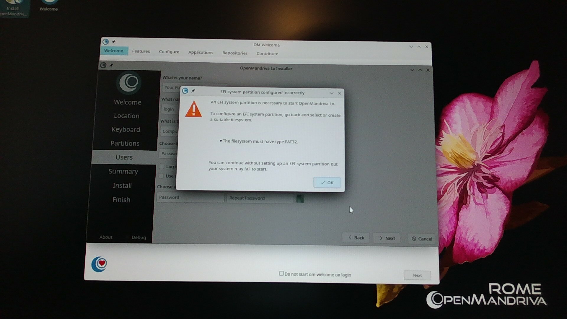

Auto partitioning (Erase option) automatically selects Fat16 for the /boot/efi partition.

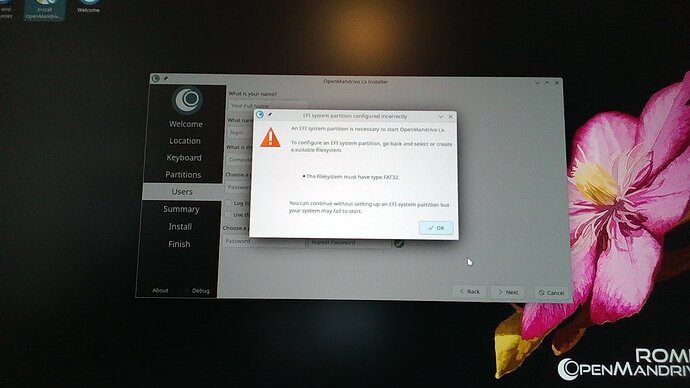

Manual partitioning, selecting Fat32 for /boot/efi throws contradictory errors
both “/boot/efi needs to be Fat16”
and “/boot/efi needs to be Fat32”
Manual partitioning, selecting Fat16 for /boot/efi throws no errors
Installing using build 4011 (which has had no problems for me)
Auto Partitioning (Erase option) automatically selects Fat32 for the /boot/efi partition
Manual partitioning, selecting Fat32 for /boot/efi throws no errors
Manual partitioning, selecting Fat16 throws the same two errors as above only they both say the partition type must be Fat32

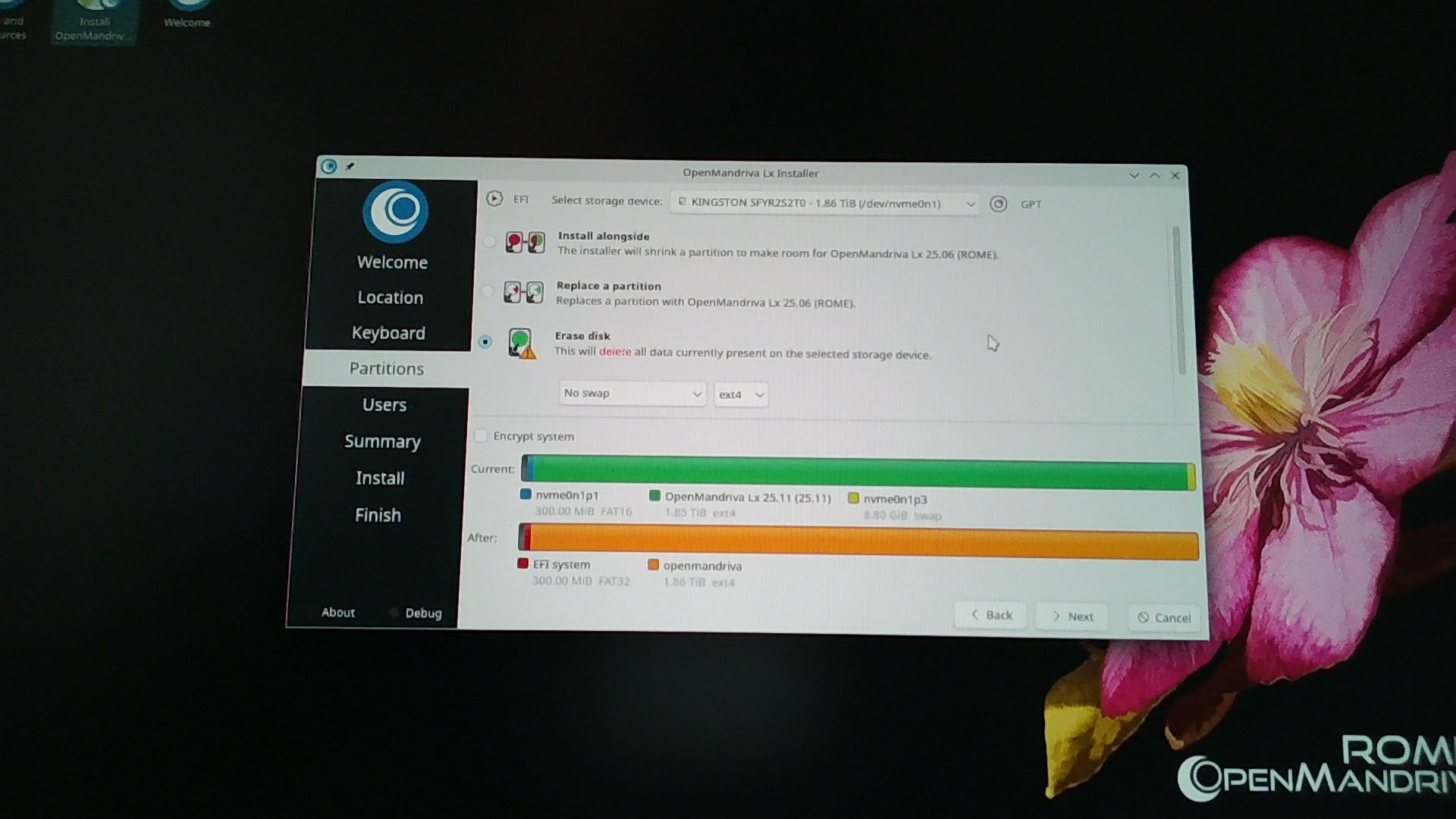

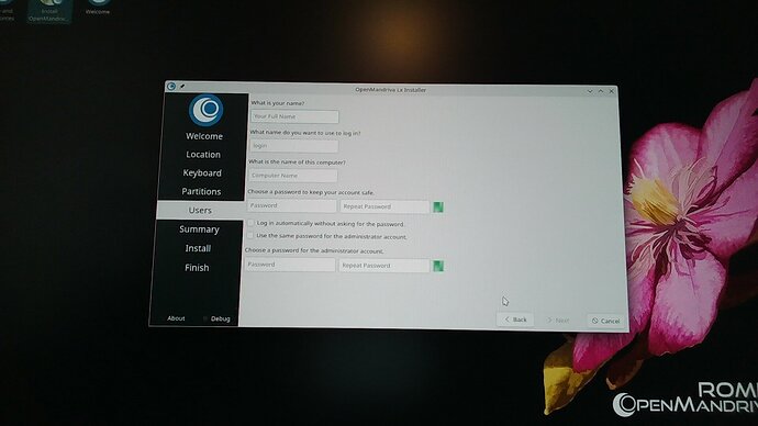

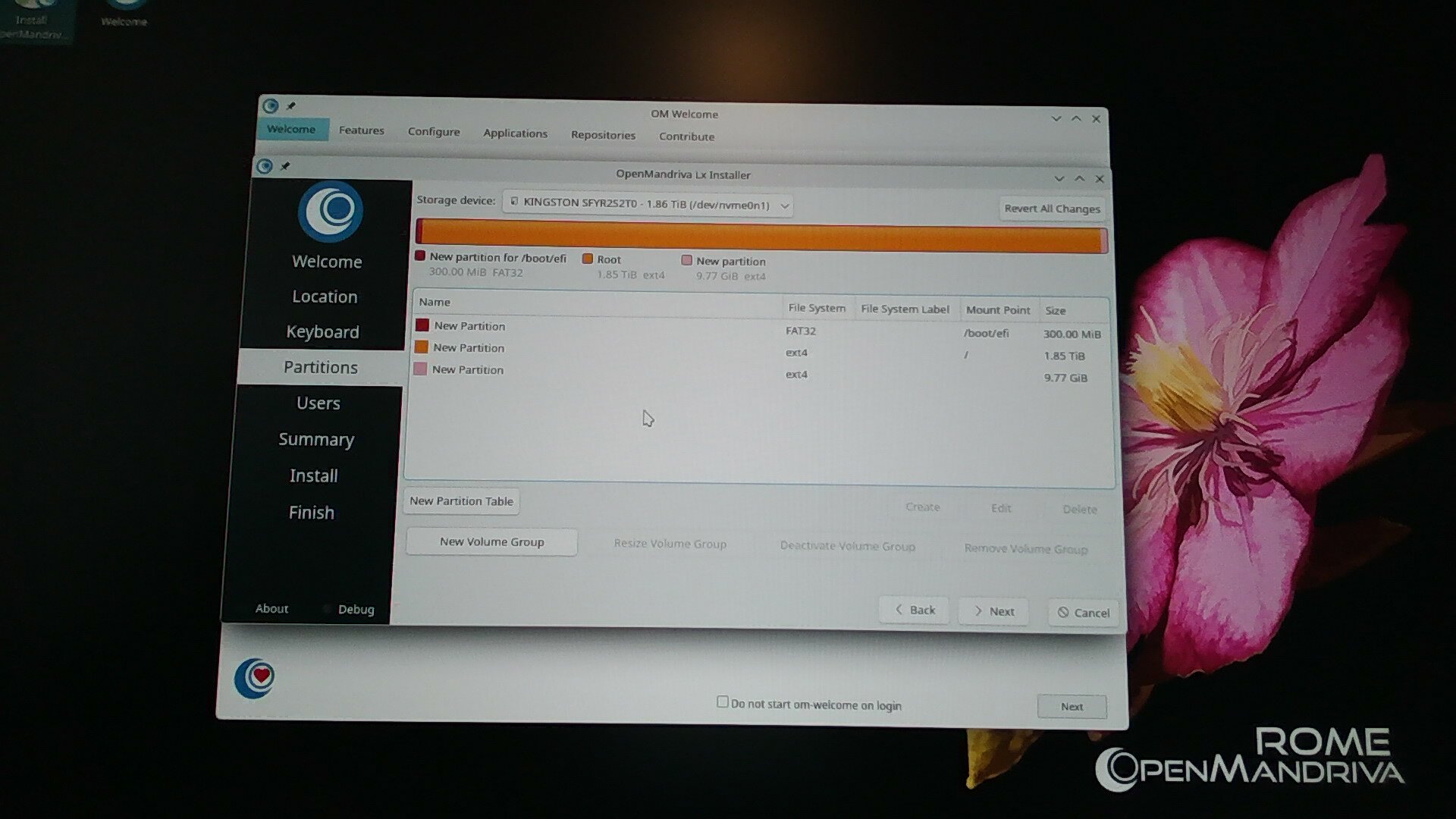

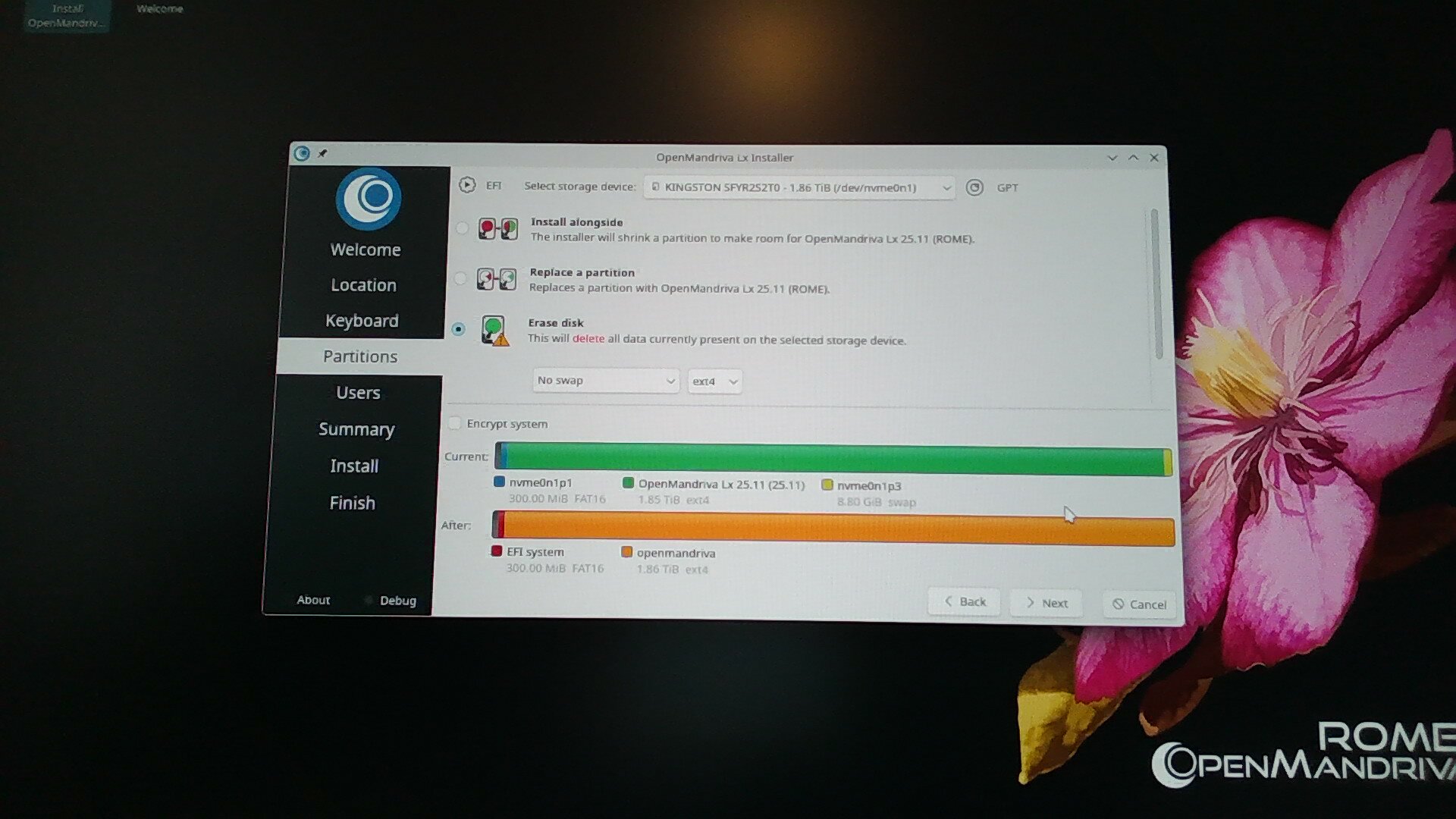

I was going to go into detail here , but the pictures mostly speak for themselves I think.
ROME Build 4292

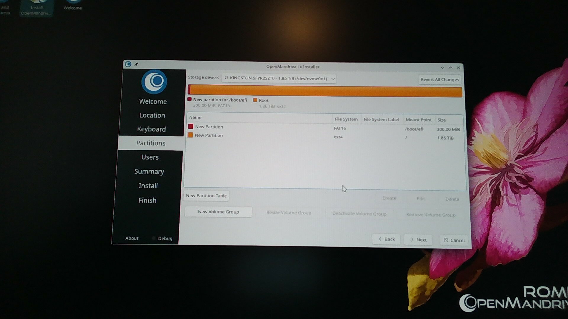

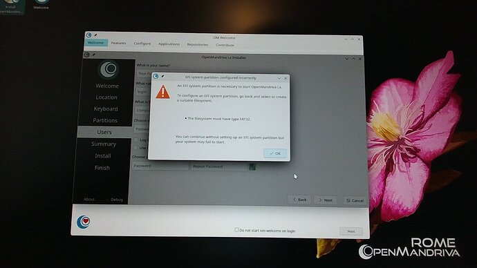

Manual partitioning; Fat32 on /boot/efi
This gave the errors

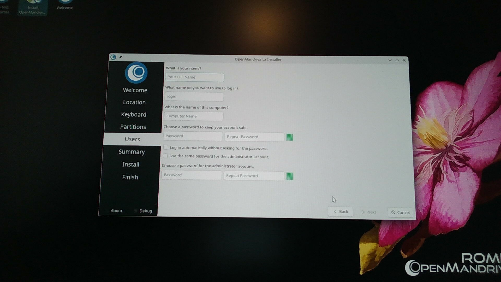

Manual Partitioning Fat16 on /boot/efi
A picture of NO errors (lol)
Build 4011
Auto partition (Erase option)

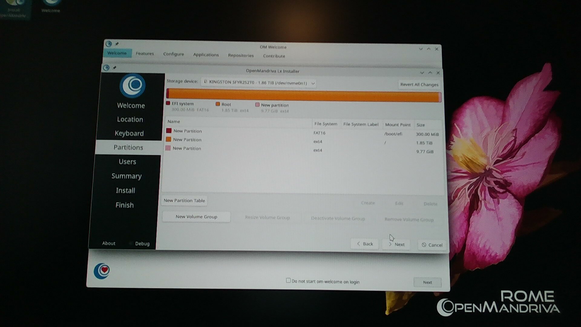

Manual Partitioning
Fat16 on /boot/efi
Gave Errors
Manual partition; Fat32 on /boot/efi
And no errors
