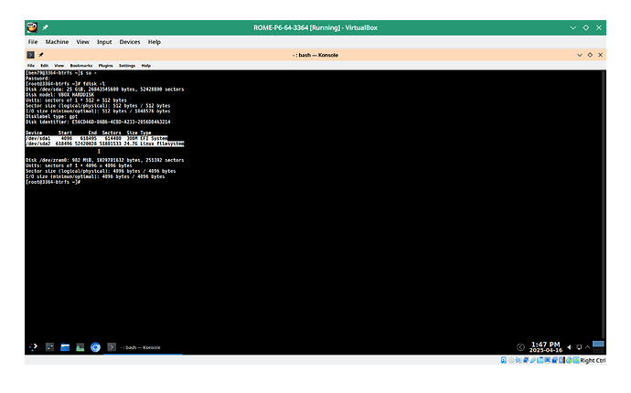

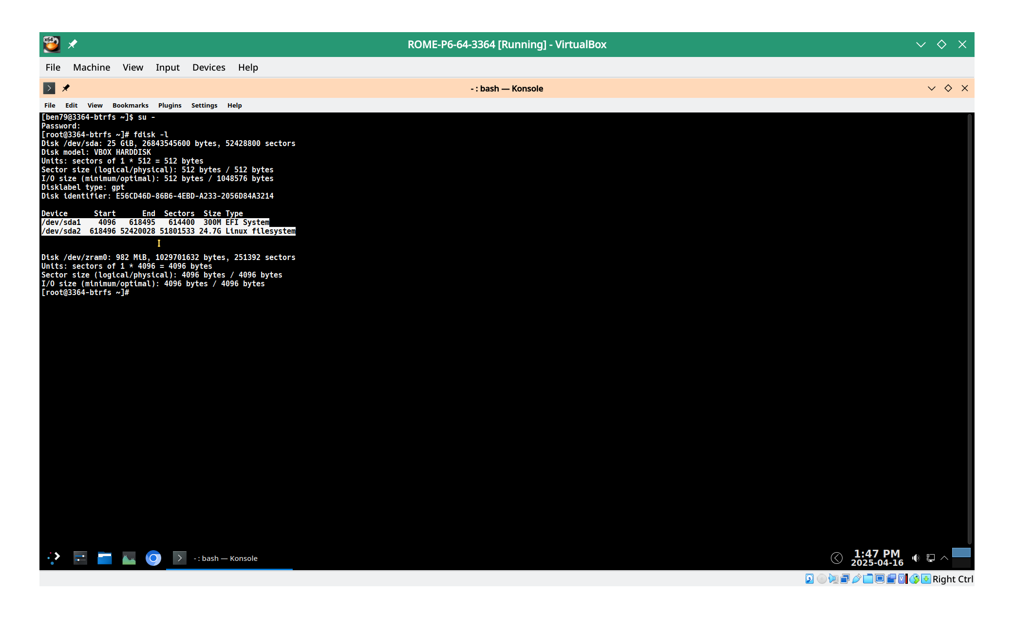

This seems like where ever the OMLx boot-loader is written to is being overwritten by something. I can not yet envision what or how this would happen. If your OMLx system is on a separate drive and you are booting this way that drive shoud at least have /boot/efi and / partitions. Something similar to this:
You could have additional partitions like /home but you should have at least these 2 to boot this way. Then assuming the drive is /dev/sda you would boot into your OMLx systems and run:
sudo update-grub2
sudo grub2-install /dev/sda
Where you change /dev/sda to the actual designation for you drive. If is is nvme it could be something like /dev/nvme0n1 but that path has to be exactly what fits your machine.
Then when you go into the firmware/BIOS you select to boot from that drive and that should work.
