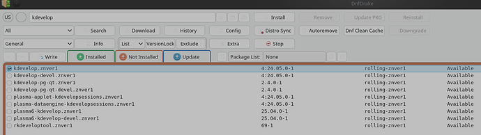

After updating my distro (sync). I was trying to install kdevelop. I searched in dnfdrake and got the following:
After clicking Install, got the following:
I then searched for kdeplatform and found a slightly older version:
So I’m going to assume I’m SOL with kdevelop atm. It looks like the kdeplatform version is a little out of whack; 25.05.0-1 vs 4:25.05.0-1. I don’t have a clue about how these things are versioned so maybe this is an issue, maybe not. Well, anyway , no biggie, I can wait. I even tried install that 25.05.0-1 version but that didn’t do it. It’s certainly >= 24.05.0-1 but maybe not the same as 4:24.05.0-1. Please tell me if I’m “doing it wrong” and what I’m supposed to do if I am. Thanks!
sudo dnf install plasma6-kdevelop
That worked. But then:
