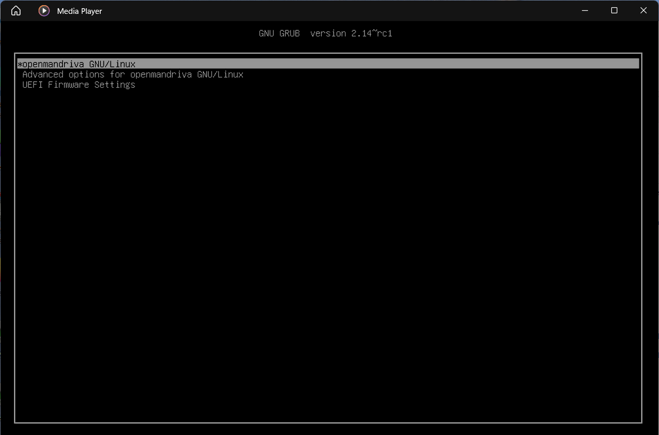

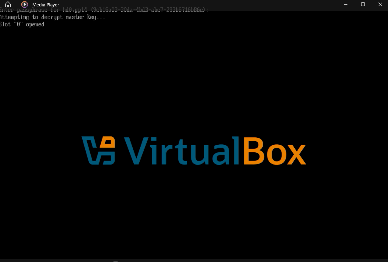

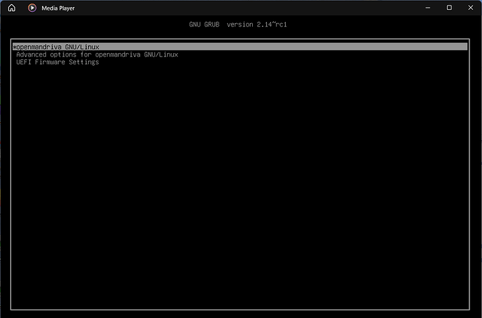

This time around I chrooted into installed system (OM Cooker with luks2 encrypted ‘/’, single partition). Compiled grub 2.14-rc1. And now decryption at grub level works. So, we just have to wait for version 2.14 (or 2.14-rc1) to be available in our repos.
Thank you for confirming that. After UM we can look at more things to resolve. I am not sure if we can bring in a RC of grub given how things went the last time we tried to make this option available (a lot of systems that wouldn’t boot at all). I think they would like to see more testing with results like this.
Is it super-slow? On my encrypted system, Grub takes forever to decrypt the partition so it can then load and boot. In my testing, if I installed a system with decrypted /boot and /boot/efi, but encrypted / and /home, Grub doesn’t do the decryption and it happens fast.
Yes, grub decryption is slow. It is not exact measurement but it probably took 18-20s for the “Slot 0 opened” message to appear. With initrd decryption (on my other PC) it is less than 5s. I am not sure if size of the drive and overall PC specs matter.
