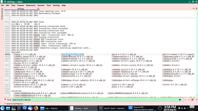

Yesterday I updated several packages including glibc-6:2.29-1.x86_64.
I opened dnf.log with Kate but searching for “glibc-6:2.29-1.x86_64” don’t give any result.
The information is there but so is a lot of seemingly unnecessary debug stuff.
If you use something like Kate or Kwrite the file size is above the ordinary limit for these text editors so you have to select to “temporarily raise limit and reload file” first for all the information to be there. And the information that would be left out would be the most recent transactions.
So if you do that and find the right section for the recent transaction it will look like:
And it should be very clear that this is the dnf.log. What it contains looks exactly like the output you would get if you upgrade system in Konsole. Plus all the debug stuff I complain about. The debug stuff does make it hard for user to find their transaction. I have not yet tried using a search function in Kate or Kwrite myself but the should work if you raise the limit as described above.

In fact I don’t know how to use ‘whois’ in Kate. I would use that in Konsole.
In Kate I would use >Edit>Find like this:
Note the up and down arrows to the right that allow you to go to previous or next match, ect.

Why do you keep talking about “last rows of my dnf.log”? That is not the right place to be looking. You have to go further back in the logs.
Using my own dnf.log as an example currently last line is 107,602. Now I want to scroll back past all lines that have DEBUG, DDEBUG, INFO, or WARNING. Which in this case takes me to line 105,601. That happens to be an update I did less than 5 hours ago. What??? 2001 lines to go back less than 5 hours? Yep, I’m afraid that this currently how this log works.
Now I do understand your frustration and hope that you and others see my frustration. How will we get users to use a log where you have to go back 2000 lines to find an update that user did less than 5 hours ago. Developers are you paying attention? (Here’s the question: Developers will all this debug output go away when repos are split for Lx 4.0? I’m hoping so.)
Also now you and other users are perhaps more aware of why I would use the ‘Find’ utility in Kate or Kwrite to find things in this dnf.log or the dnf.rpm.log. Scrolling takes more time a patience than most of us have.
