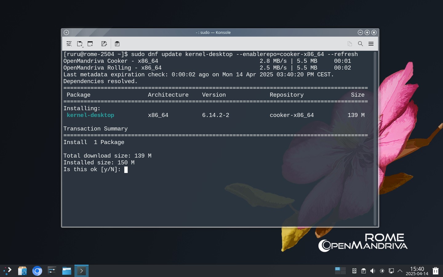

Small update, I tested the 6.14.2-2 kernel build today and from my initial testing it has restored network connectivity on my machine at least, I reported my results to devs in matrix cooker chat.
I expect that after more test confirmations from the tester team it will be pushed down to ROME/Rolling as soon as that happens provided no issues are reported.

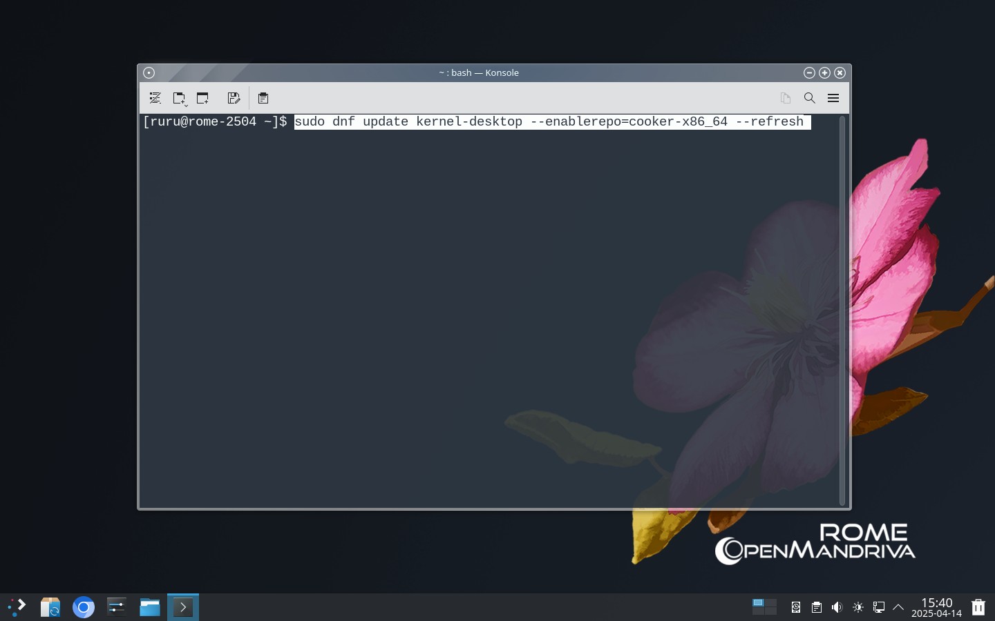

For people NOT using nvidia driver, in ROME system you can do:
sudo dnf update kernel-desktop --enablerepo=cooker-x86_64 --refresh
(replace x86_64 with znver1 if it’s your case)
Reboot

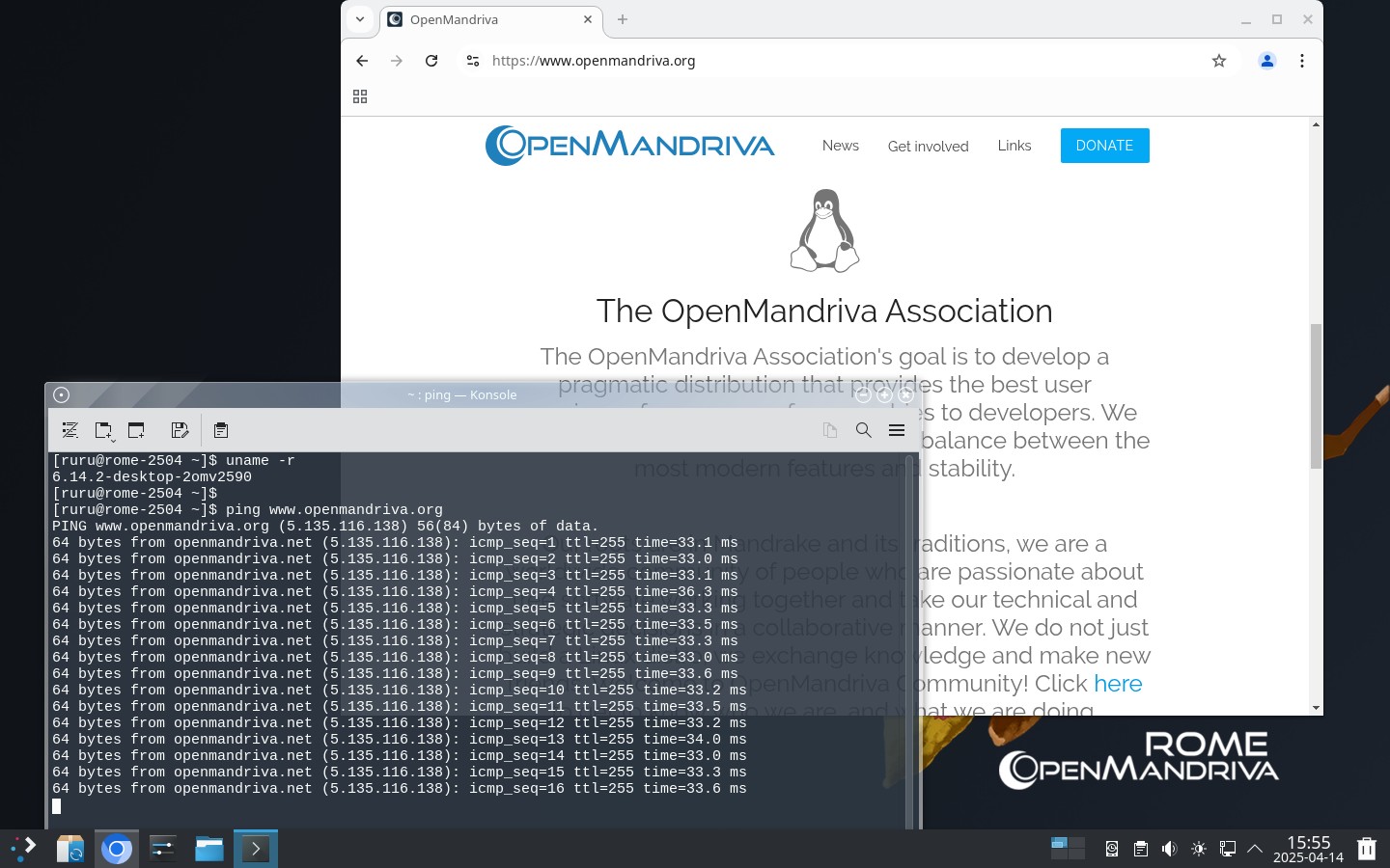

Yes, at least that is what all reports so far are saying. Also the kernel-firmware and kernel-firmware-extra packages should be OK to upgrade. This network issue was strictly related to a specific main kernel version (kernel 6.14.2-1). Kernel 6.14.2-2 corrects the networking problem.

For everyone waiting for the new kernel. Dinner is served.
sudo dnf clean all ; dnf clean all ; sudo dnf distro-sync --refresh --allowerasing 2>&1| tee dsync2-log.txt
Everything works perfectly now
