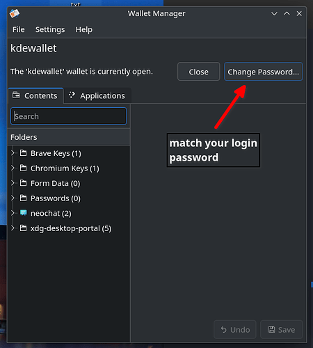

Almost every time I have installed Linux, I have to change the password for kdewallet in KWalletManager.

As far as working with certain programs, you may have to try something different. All I have installed is KWalletManager, but there are others out there. My suggestion is always, start with the simple stuff.
You can also set KWalletManager to use no password.

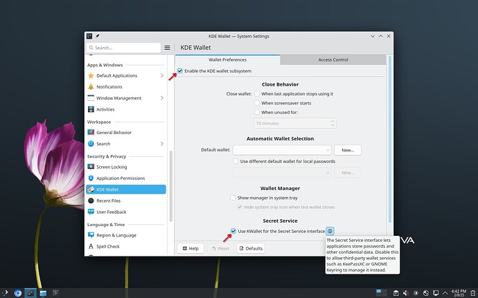

Can’t you just change the options here?
Yes, you can turn it off completely. You have to use something else to manage your keys.
@WilsonPhillips I’d assume is what the user wants (?)
