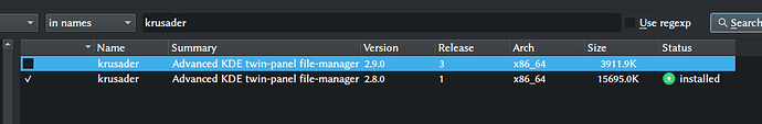

There are two versions of Krusader in the repos:
The one marked installed (with the check mark) in the screenshot seems to be the wrong one. It’s using KDE 5 and has all kinds of issues in Wayland. The one that’s not installed uses KDE 6 and works well. If I remove the KDE 5 one, however, and install the KDE 6 one, on my next dsync it gets replaced with the KDE 5 one.
Is there a reason to have both? If not, now that Rock 6 is out, maybe we can remove the KDE 5 version?
I am new to DNF, so I don’t know what the command is to lock the new package in and prevent it from being removed. You could try marking it as installed.
sudo dnf mark install krusader-2.9.0
Later, you would have to undo this.
