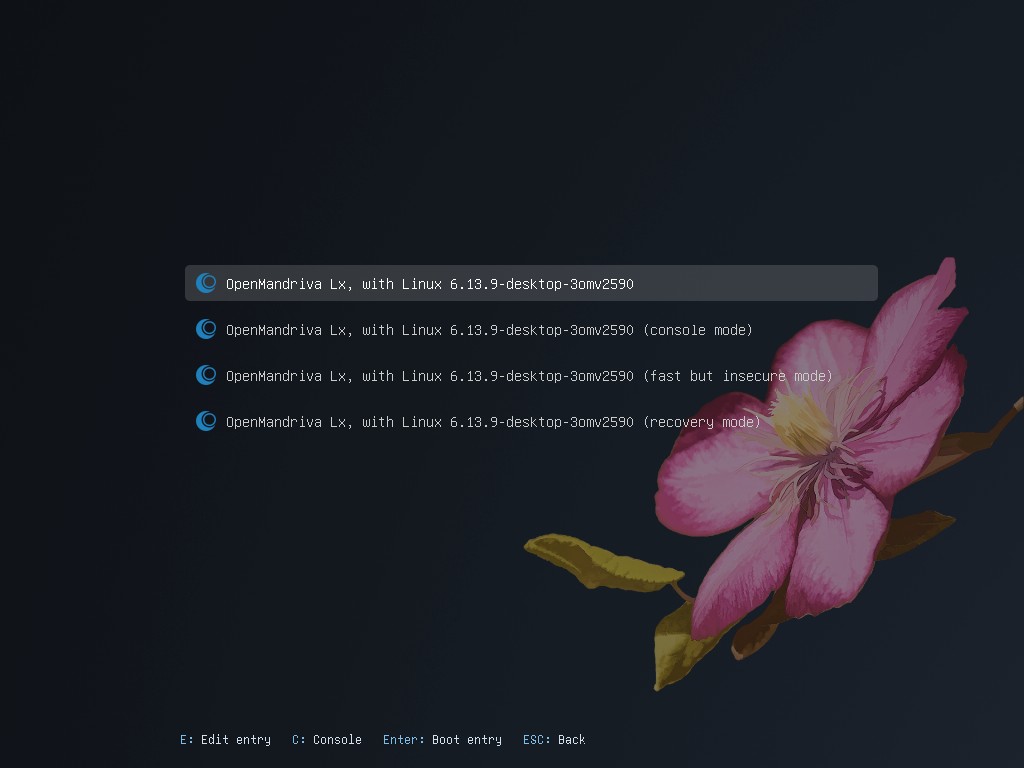

Notice in this screenshot published as an example I have just one kernel installed, you may need to scroll down the list with the arrow-down key
