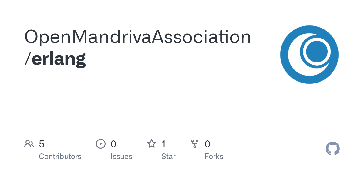

It hasn’t been built in a while:
Which means it probably needs an update, as well.
As will all the dependents, most likely:
