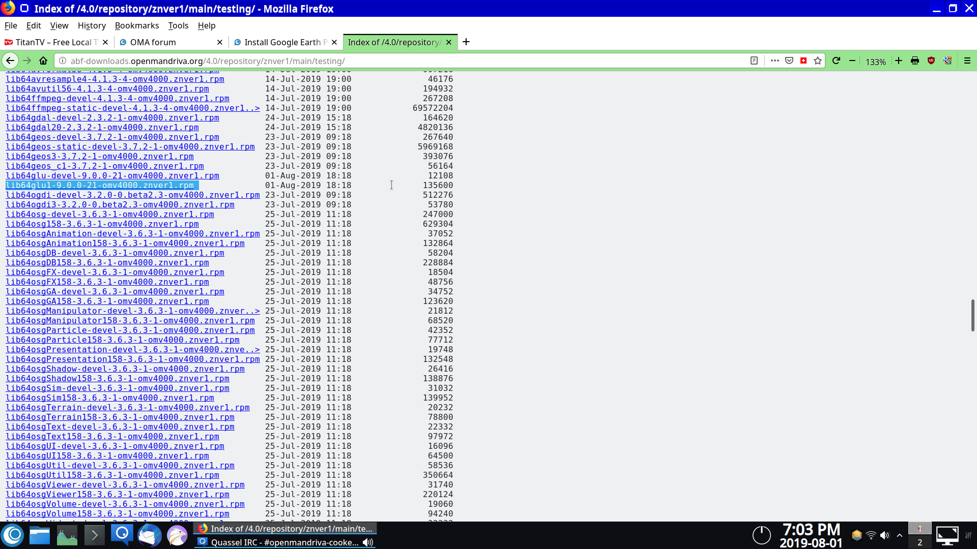

Sorry if I didn’t make myself clear enough, but your “testing” repo => is not existing on my znver1 system, and there is no way, in graphic, to install it!
All “testing-something” repos existing here, are “ZNVER1” version, AND YOUR LIB IS NOT PRESENT ON NONE OF THEM!

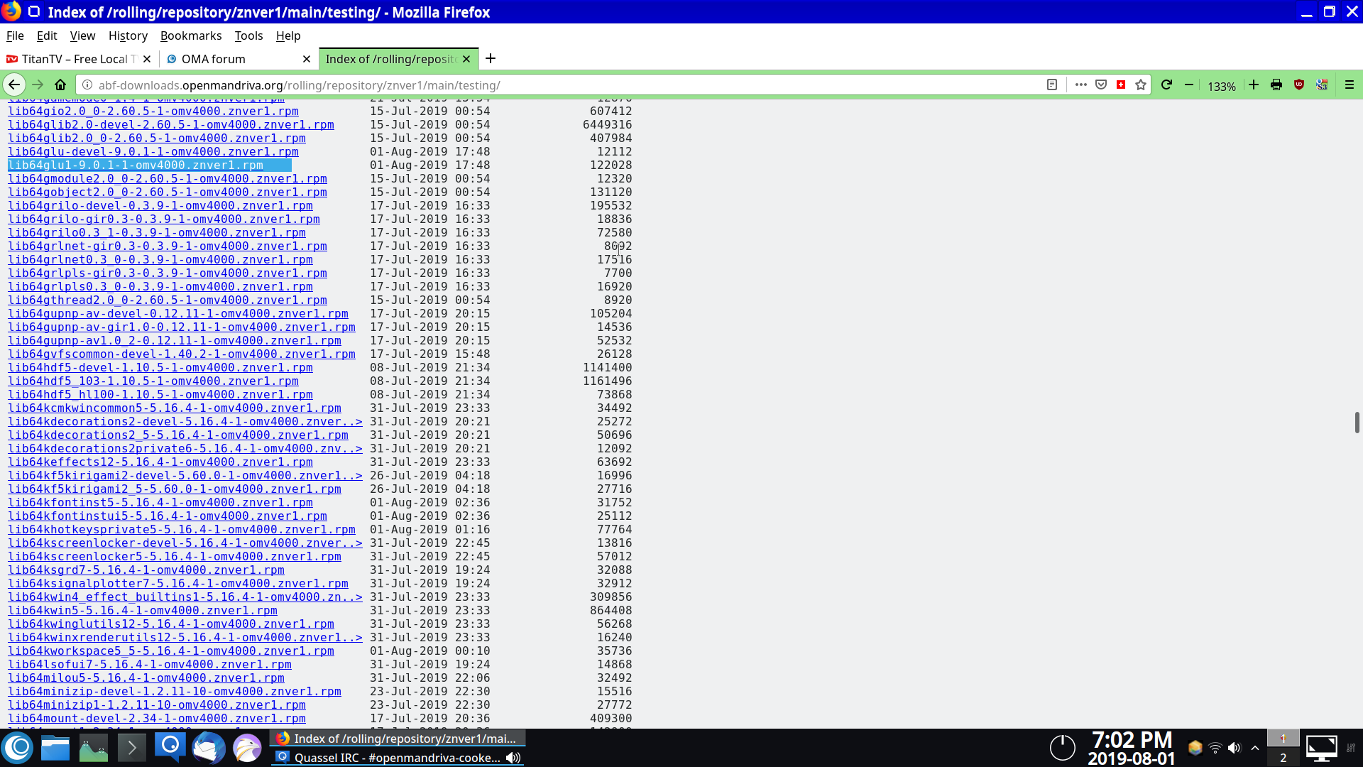

I believe these are the packages @AngryPenguin is referring you to.

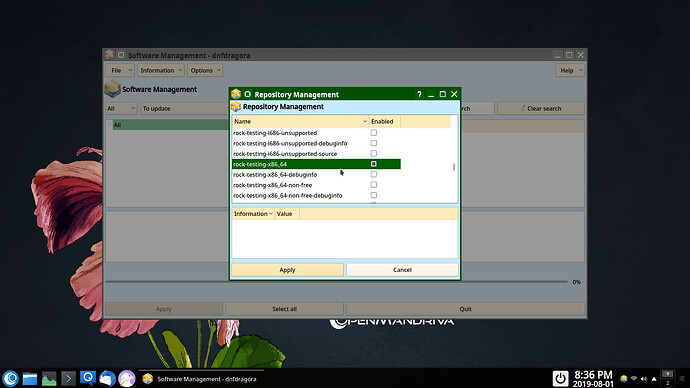

OK, I’m in a Rock system (x86_64). I open dnfdragora and select the main/testing repo for Rock x86_64.
Notice I left “To Update” selected in dnfdragora:
And the lib64glu package is there ready to install:
So if this is for some reason not working in a znver1 system we really need to know so we can get someone to look in to the problem. But here it is working. And I have verified that I can select testing repos in both Rock and Rolling systems with dnfdragora.
In dnfdragora if you enable a given repo like I did above for the Rock main/testing repo that is only valid for that session and that repo will disable automatically when dnfdragora closes. So the ‘Repositories’ tool in dnfdragora is not a repo manager it only enables repos for one session. That is different from the old rpmdrake. But handy for users like in this situation looking to test one or a few packages for a given purpose like in this thread.

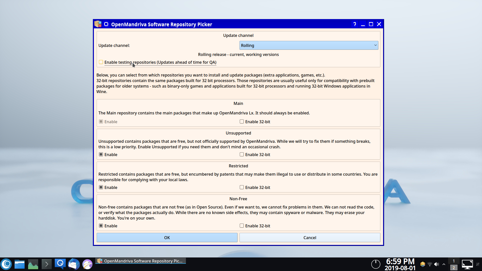

The ‘Software Repository Selector’ aka om-repo-picker edits the .repo file in ‘/etc/yum.repos.d’ and when that file is edited then everything system wide is using what is enabled there. That includes dnfdragora and command line.
There is more explanation of this in the OM-Wiki and the Resources section of this forum. And this is definitely an area where OM needs to improve.
