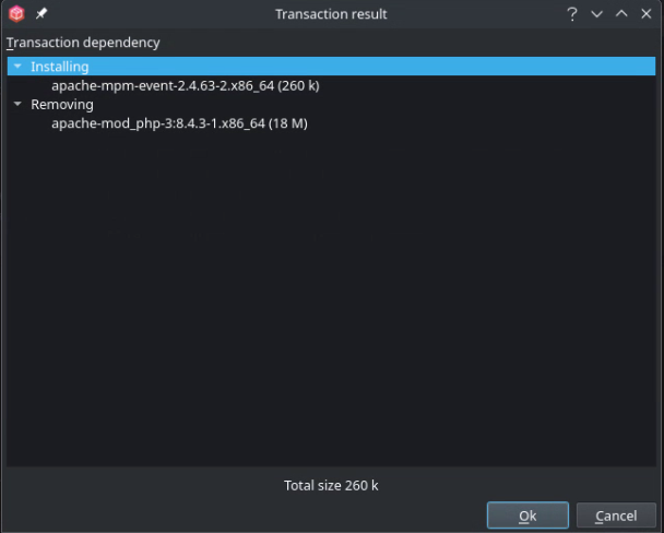

Now I’m completely stumped about installing php on top of it. Any suggestions?
I can’t seem to install it witout removing “mpm-event” but it has apachectl app that is required to run the web-server

apache-mod_php doesn’t like the event MPM (upstream decision) - but it will work with any of the other MPMs. Try using one of the other MPMs:
dnf install apache-mpm-prefork
dnf rm apache-mpm-event
dnf install apache-mod_php
